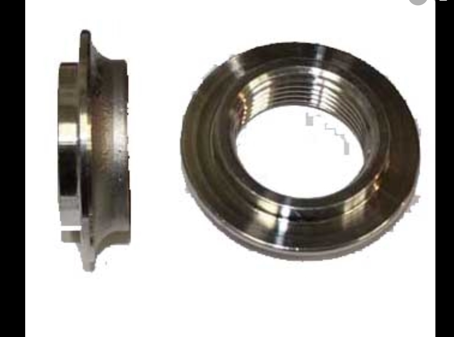

If you are welding on a nut over a matching hole to be used for a set screw then threading a bolt all the way through will align the nut, prevent spatter from damaging threads AND prevent nut distortion as yomax pointed out.
   / Drain plug help!
#12
Yeah I should of threaded the bolt into the nut before welding because the bolt broke off!
   / Drain plug help! #13
Grab a seat and let the debate begin on pipe wrench vs infomercial tools.:rolleyes:
   / Drain plug help! #15
Weld it to seal it and weld another drain plug in the tank.
   / Drain plug help!
#16
I welded it in the center of the box to make draining easy.I guess I can more it a few inches over.
   / Drain plug help! #17
This time use a weldable NPT spud like this so you can use a proper NPT drain plug.
Use antispatter and weld with new plug in fitting to avoid distortion.
   / Drain plug help! #18
YES....
At least something like half pipe coupler or whatever... Never liked bolts and nut as drain... Something with tapered thread was always better choice for me...
Dale
   / Drain plug help! #19
YES....
Look for products on pages at mcmaster.com.... 74, 75, 76, 77 Iron & Steel Pipe Fittings and Flanges78...
Dale
