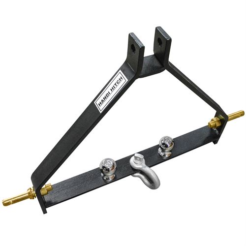

I built a adapter out of some 1/2 X 2 flat bar I had laying around. I don't use the top hook at all, not even sure where the hook is anymore. I'll get a pic in a bit.

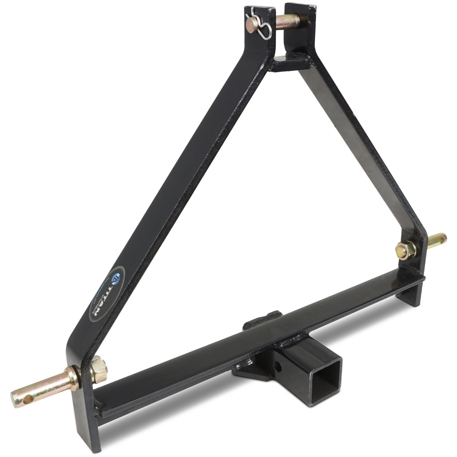

I ended up purchasing the Titan attachments triangle one with a hitch. Primarily because there was an open box on ebay for $70 shipped. My plan is to purchase either the Tri-ball with a hook or just get a hook or d-ring receiver at harbor freight.
My tractor is only rated at 1438lbs on the pto so I really dont need anything super heavy duty. Other than the trailer I will probably only be dragging small trees. I also purchase the titan quick attach forks for the front loader. Ideally I would have like to have a 3 point hitch that would have allowed me to use the forks in the rear but I was unable to find a model like this other than a homemade version as shown below which is super cool and has a boom. I plan to make something similar in the future but I wanted to have something on hand when spring comes and we need to get the boat out.
I have the Titan receiver hitch with the pull ring, and I like it.
It is beautifully made, and powder coated.
You can buy a set of Titan 2000# 3pt. forks from Agri Supply for $180 + shipping.
They too, are quality built, and power coated.

Ok great thanks for the help. If you have some extra time could you post a picture of it connected to the quick hitch? I had planned on holding off on the quick hitch until the price drops to the sale price of $69.99. I do not really need it yet since my only two pto attachments are the triangle hitch and countyline carry all.

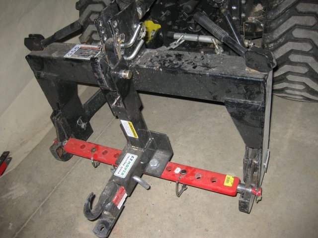

Had a little time today so worked on this.
For me the hook also is too far back. I hope to use the adaptor from HF work.
I added the class 1-2 and 2-3 bushings on the pins. And also top link bushings on the top link pink to fill the hook. I only have one bolt in it for the mocking up but I think even one good bolt or pin would be sufficient on my L3301. It would probably rear up or come to a dead stop or spin before breaking a 1/2"grade 8 bolt I would think. But the right way would be to scab on the back of the hook pushing it out. Maybe eventually.
My lower pins were a little too close together in their distance apart which caused the lunch pin to get hung up in the lower hooks. I added a couple of flat washers to push the pins out slightly.ImageUploadedByTapatalk1457126926.359939.jpg
