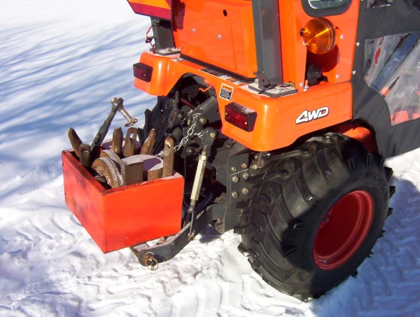

On the attached picture you will see a weight box on the back of the BX. It is sitting on the draw bar. Hope this helps.

The one Tom has his weight box sitting on (between the two lower link arms) is commonly called a "drawbar" and the one sticking out from the bottom of the tractor differential is commonly called a "swinging drawbar". Of course on many of the smaller tractors, you can't actually swing it off to one side, as you can on many of the bigger tractors.
