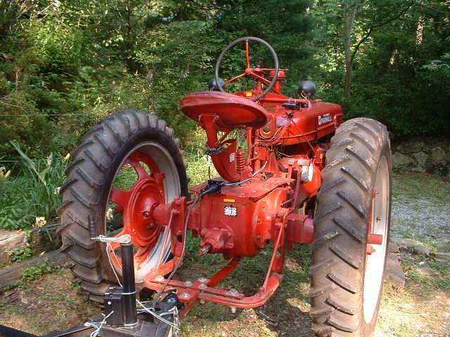

And some of the older ones, like my '46 H, have the drawbar and not the three-point. Mine's reinforced to handle the tongue weight of the dump trailer.

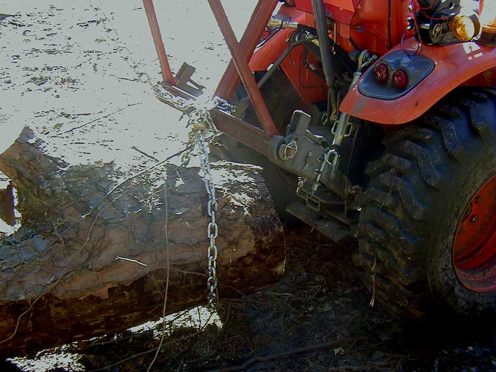

</font><font color="blue" class="small">( John,
Can you post a pic of your setup. )</font>
Jim, sorry it took so long, been busy.
Note that the log is at drawbar height. I've had no front end lift with this setup. I wouldn't go any higher though than this, as the front end would come up. John
