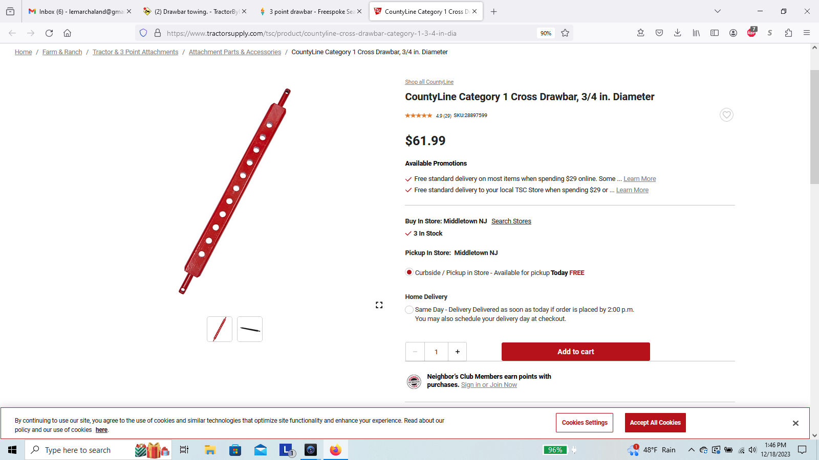

Sold my BX 25 "starter" tractor and upgraded to new L6060 with cat 1 3 pt drawbar hitch supplied by dealer. Tnought I was getting a cat 2 drawbar atrachment. The cat 1 has eleven 3/4 inch holes. I want to attach both 2 inch and 2 5/16 balls for moving wood chipper, splitter, empty flatbed trailer ( approx 3000 lbs with no load ). Tractor rear wheels are loaded. 2 inch ball is available with 3/4 shaft but smallest 2 5/16 ball comes in 1 inch shaft and up. So, can I drill one of the holes up to 1 inch or will I weaken the drawbar significantly? Are there other options, perhaps a way to attach a 2 inch hitch receiver to this drawbar? I have front pallet forks that I could possibly weld a receiver hitch to. Appreciate all thoughts, comments. Thank you.

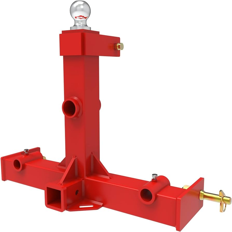

I too would recommend that you buy a dedicated attachment for this, especially since they are so cheap. Another advantage is if you have any gooseneck trailers to move, not only can you put a drawbar with a 2-5/16 ball in the bottom for bumper pulls, you could use the 2-5/16 ball they have on top for goosenecks.
Something like this, there are many manufacturers. This one can take bale spears as well, which can also make it able to move lighter pallets around with the bottom two, if you have a hydraulic top link to tilt it with.

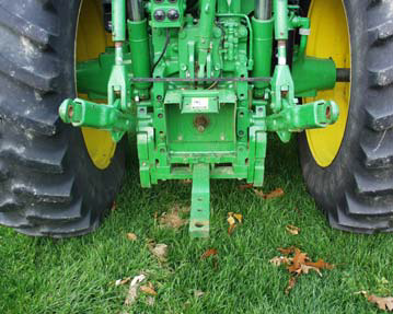

I am guessing that you are referring to this type of "drawbar"
The lower bar in this picture is the actual drawbar.

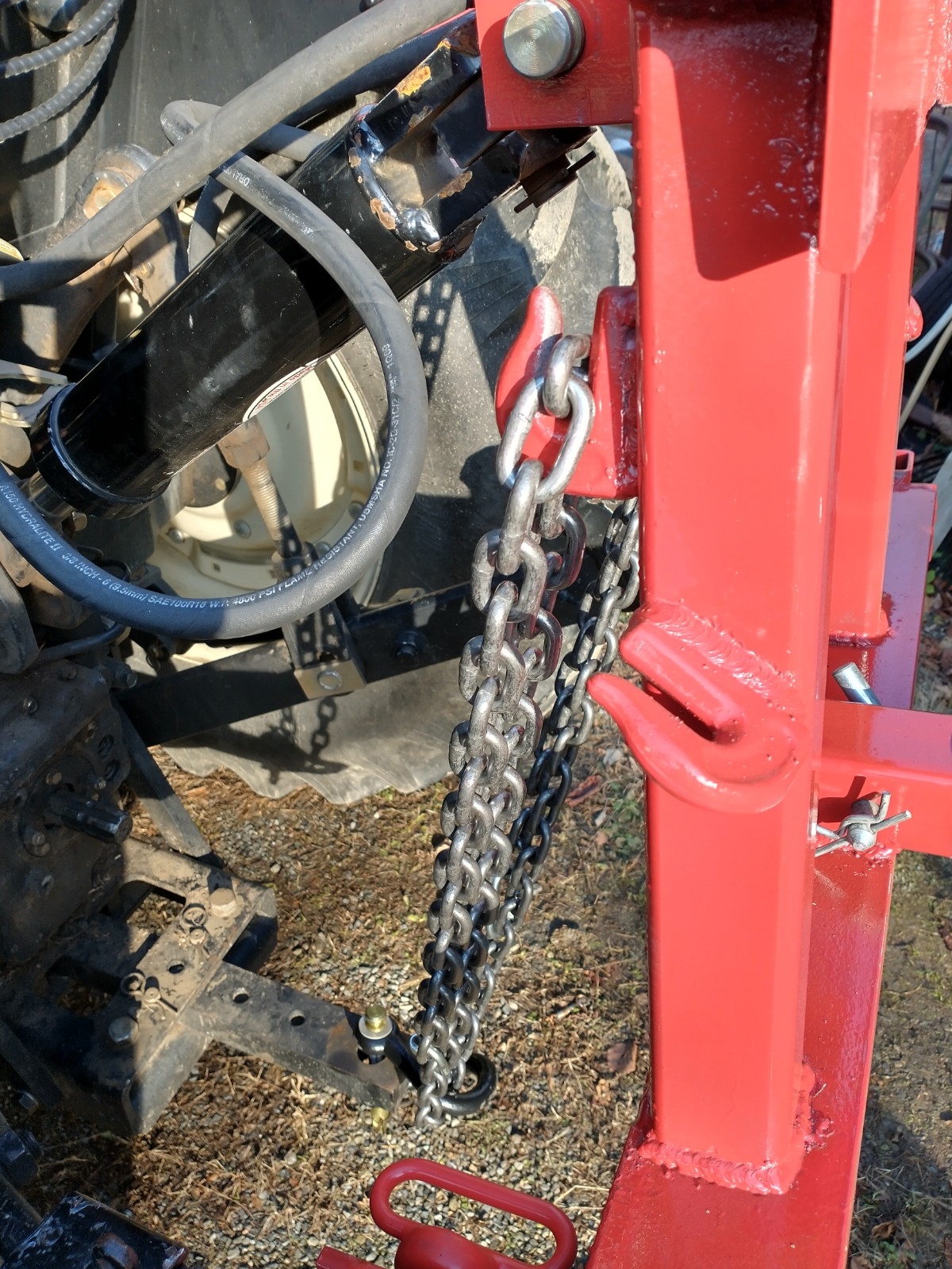

When using a pull point attached to the 3 point just be aware that there is NO hold down force in the 3 point assembly.
While 3 point hitches are handy and versatile they do require one step often over looked, a chain or other travel limiting device needs to be used to prevent trailer loading from lifting the drawbars and raming things into undesired locations such as fender and fuel tanks.
In this picture at the bottom of the picture you can see the clevis attached to the tractors drawbar and to hooks in the hitch to limit upward movement.
another view showing the chains getting tight at the top of the 3 point lift

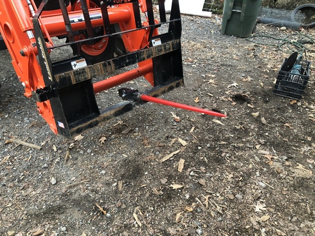

I’m going to have to take a closer look. I was under the impression that mine aren’t removable, just adjustable on a sliding bar. This is the unit I have:
Apparently they are removable.
