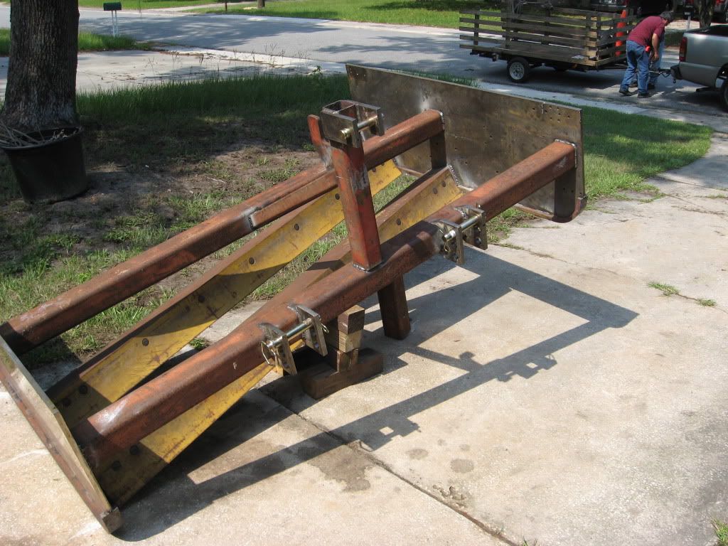

Actually if you go to my "build" post, you will see that the 5/8 inch thick sides have 3/4"x 2" wide skids as wear plates, and the blades extend 3/4" below the skids. So if anything is going to hit the asphalt, it will be the blades which are angled about 35 degrees. My thoughts, it will be more than a scratch if I hit it at the right angle with the full force of the weight of the blade. My blades are Caterpillar brand Grader wear blades. I do know that if I catch the edge of a concrete sidewalk, the sidewalk looses. Did that by accident, and not with the full force of the entire weight on it.

My thoughts are, the operator should extend the top link a little so that the LP is picking up less gravel, which will reduce the spillage over the top of the blade, which should make the graded area a lot smoother without any more work. The spillage over the top of the rear blade just makes for a lumpy surface, something that can be avoided.

Post a pic of your pull behind grader (please).
   / Driveway Maintenance - Box Scraper? #59
Apparently the hosting site has gone to using a bunch of ads lately, sorry if they show up with this picture. I imagine I will need to start looking for a new hosting site. I had about 80 pictures posted from the build on another post and it is filled with ads when you click on the pictures to view them.
