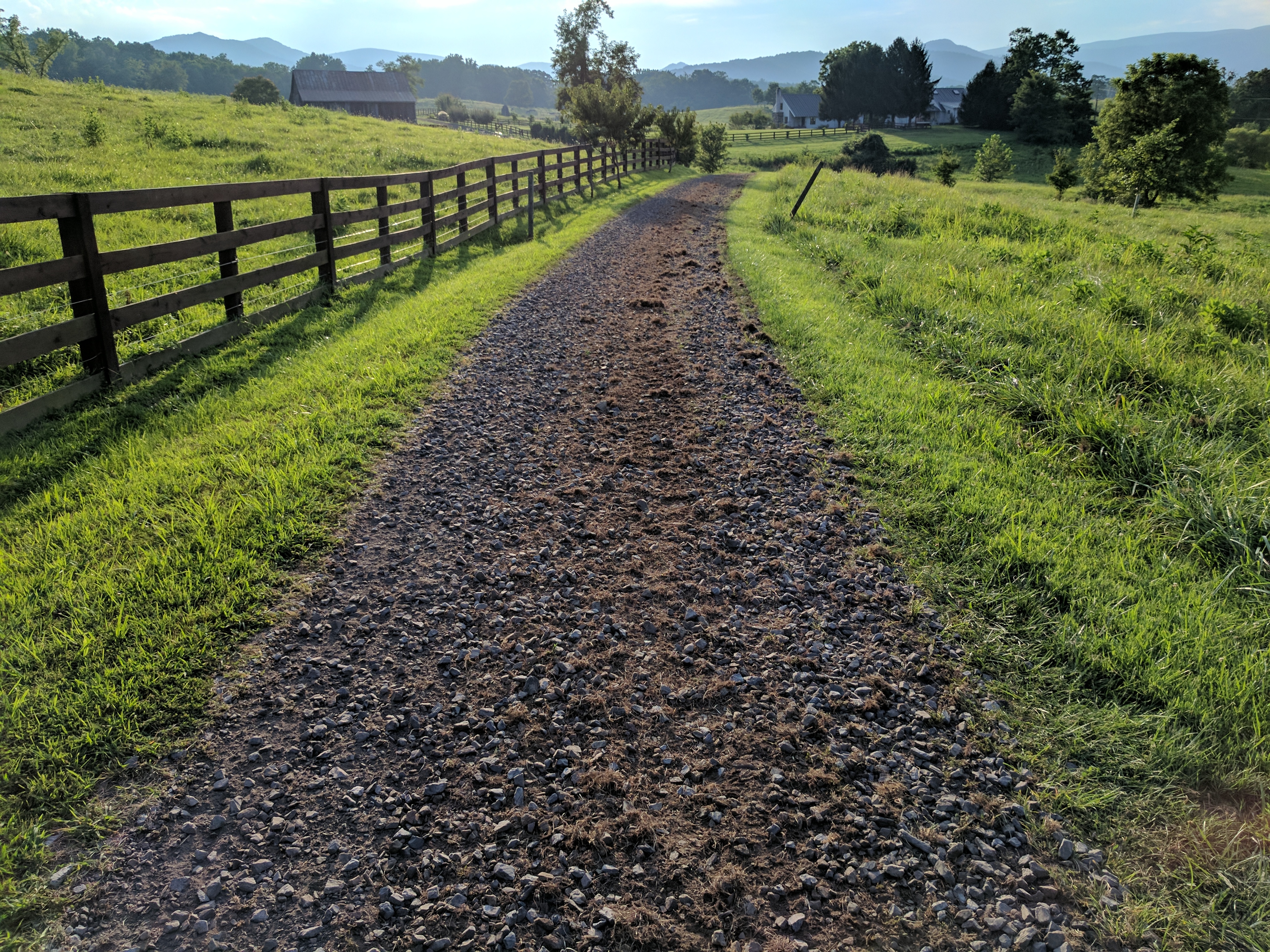

For reference, yesterday I refinished our dooryard (parking area for those not in NE :D ). Here is a picture of it halfway through the final smoothing passes (area on left is finished)

For scarifier depth it all depends. How deep is the top layer of road material before hitting the larger rock base? Is it just gravel or is it a crusher run type material with fines? How compacted is it?
For my dooryard it was packed hard almost like concrete. But, the top layer is only about 4 inches before hitting the 4-6" stone. I put the shanks down to the 2nd to last hole and shortened the top link so the angle of the teeth was pointing down for a more aggressive bite and to get them to sink in.
Did passes where I overlapped each previous path with half the width of the implement until I had it all loosened up.
Then I pulled the shanks all the way of and adjusted top link to the LPGS was flat/flush with the ground and started marking passes starting at the far side to the near side where the picture was taken from doing a full implement width at a time. Was left with pile of material at the end so turned around and started the next run from near to far pulling all the excess material.
Once all the low spots were filled I then switched to the finishing pass set up with front blade and front of rear blade off the ground. They key with that for me was to go slow so that the material you caught with the blade would fall in front of the blade instead of flowing over the top.

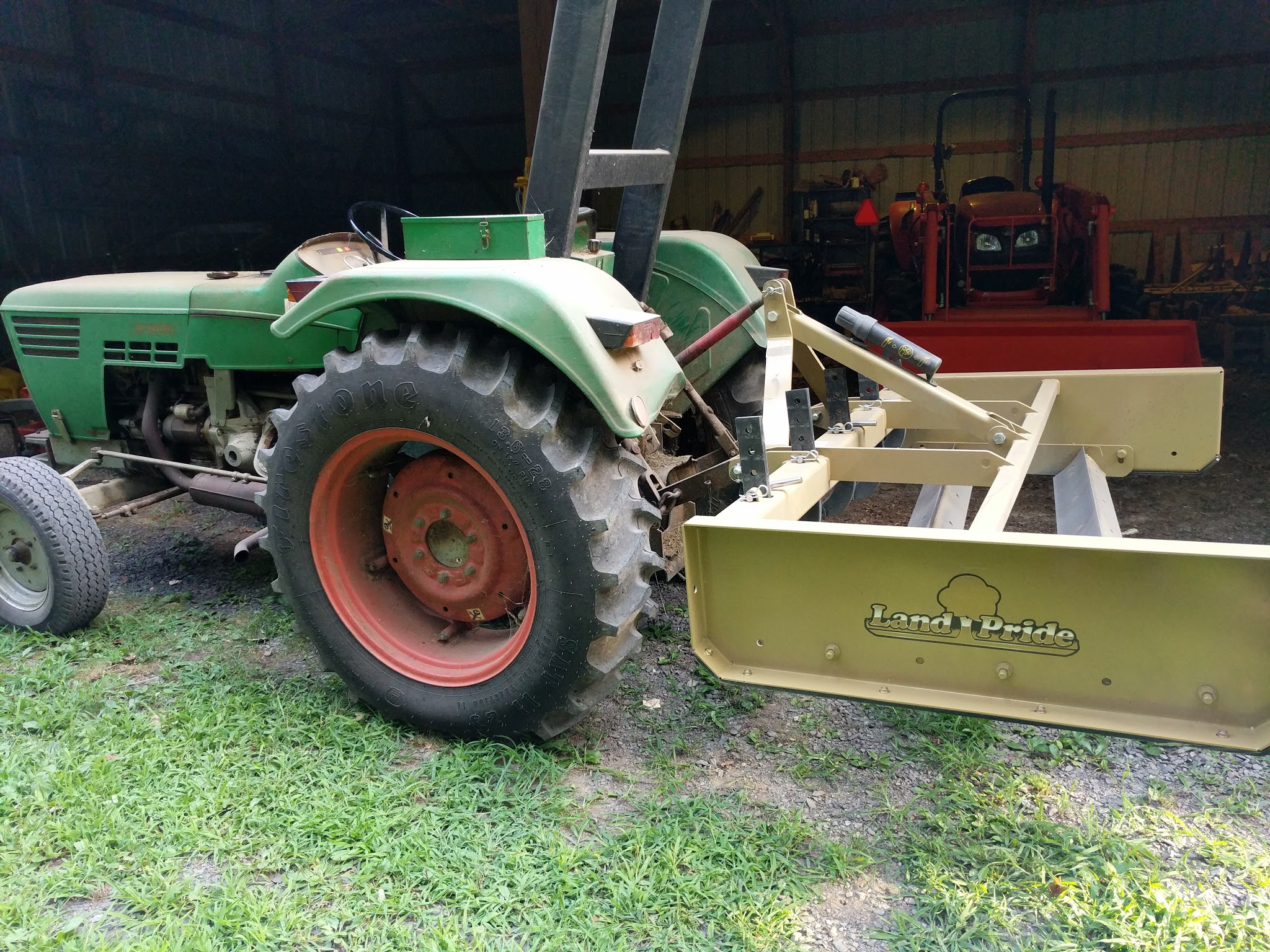

Thanks for all the advice folks. While I ordered a Land Pride 2572, I actually wound up with a 1572 because of multiple screw ups by the distributer. But I'm actually pleased because the 1572 fits my grandpa's old Deutz D4006, which has sadly been sitting unused for the last 1.5 years. After lubrication, filter changes, fresh diesel and a jump start, she's now a fully dedicated road maintenance machine. That old Deutz just won't quit. My grandpa would be proud (he passed in 2014).
Anyways, I quickly went to work and figured out pretty quickly that setting up the machine right is tricky. The right top link length was the first trick to get even engagement on most terrain between the two cutting blades. Then it was getting the right angle to eliminate the unnecessary high crown, but still put a slight crown in the road and recover gravel from the sides. Then it was getting the scarifiers adjusted right. Where I wound up was dropping the scarifiers all the way down where there were potholes and managing the depth with my 3-point. I went too deep in one spot and dredged up some large flat rocks and red clay - no doubt the original road bed. After repairing that I learned the right depth for the driveway and didn't have that problem again. By overlapping runs back and forth with the scarifiers I was able to tear every pothole out of my driveway. It worked very well.

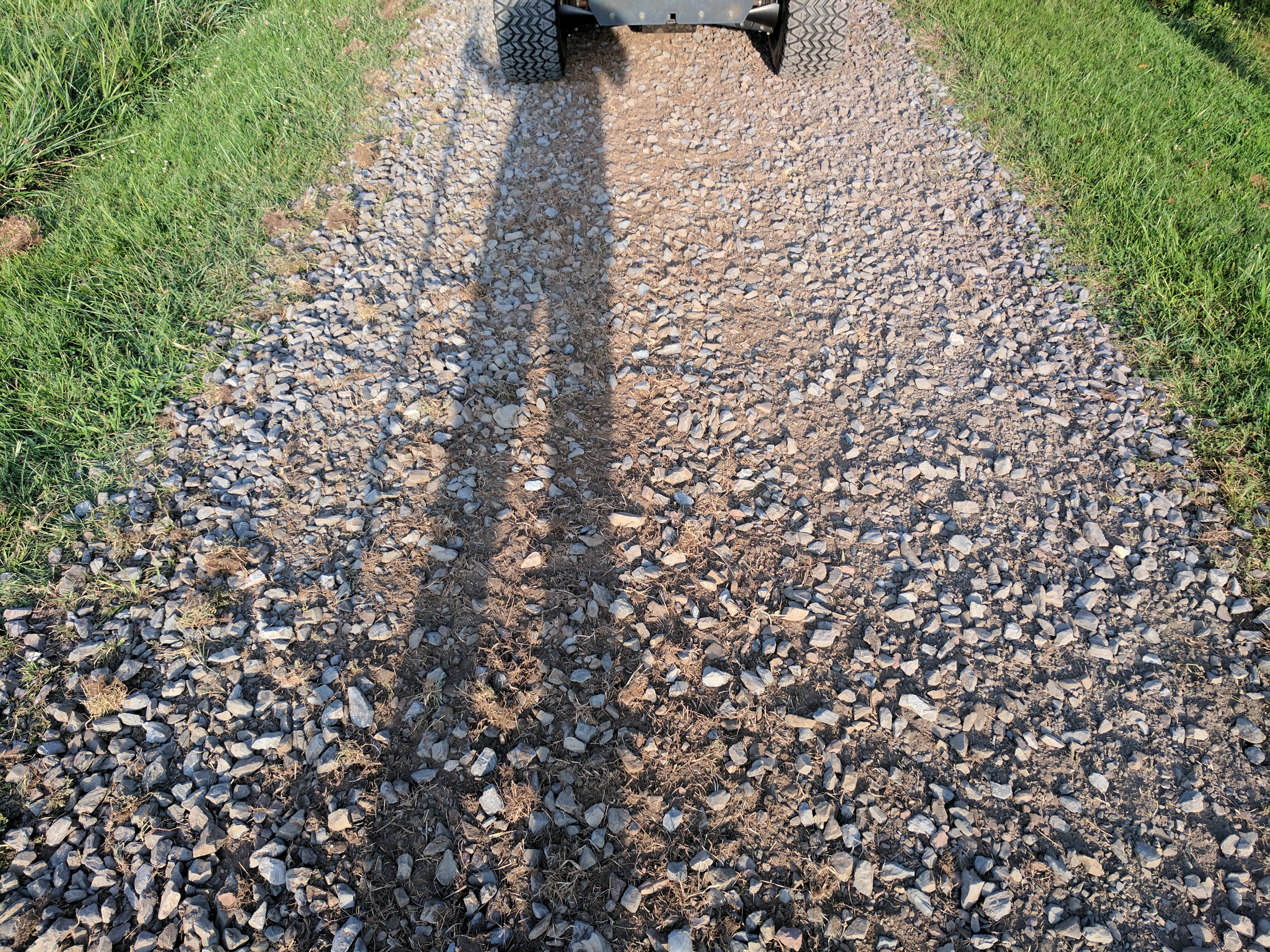

Before shot - again looks better than it was because of the roundup.

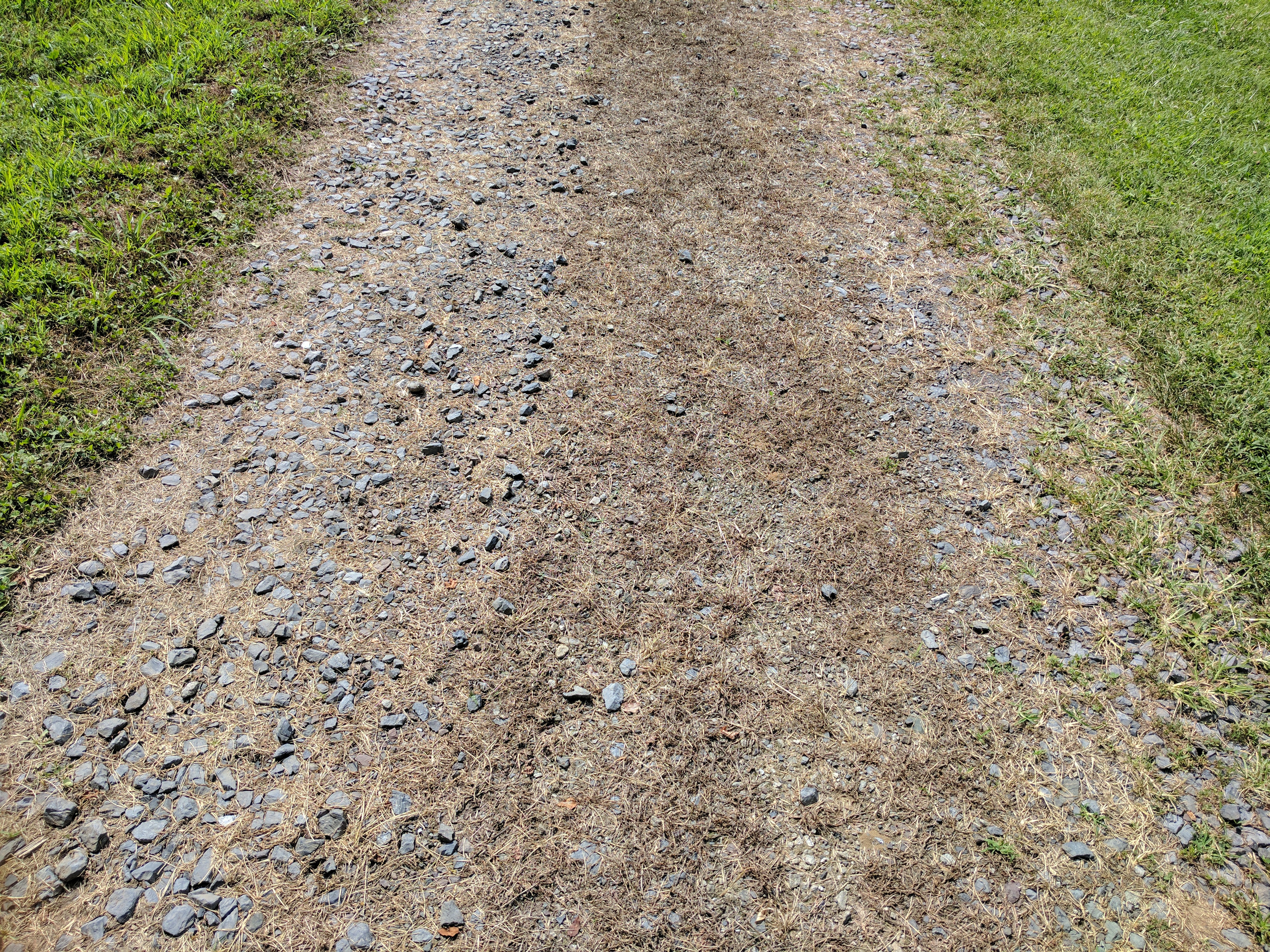

After about 6 passes with the land grader
Shot down the driveway for a small stretch. Note the clods of sod. I suppose I could rake those up and toss them by hand. It would look a lot better. But dang it if that doesn't seem like a lot of work! :)
