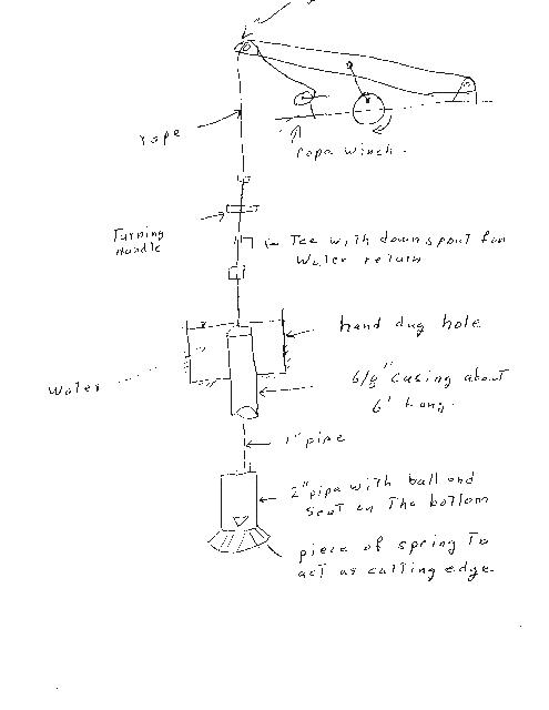

You could build yourself a well drilling outfit that can go down 300 feet or so. My Grandfather and Father drilled wells with one many years ago. Took about four days or so.:D

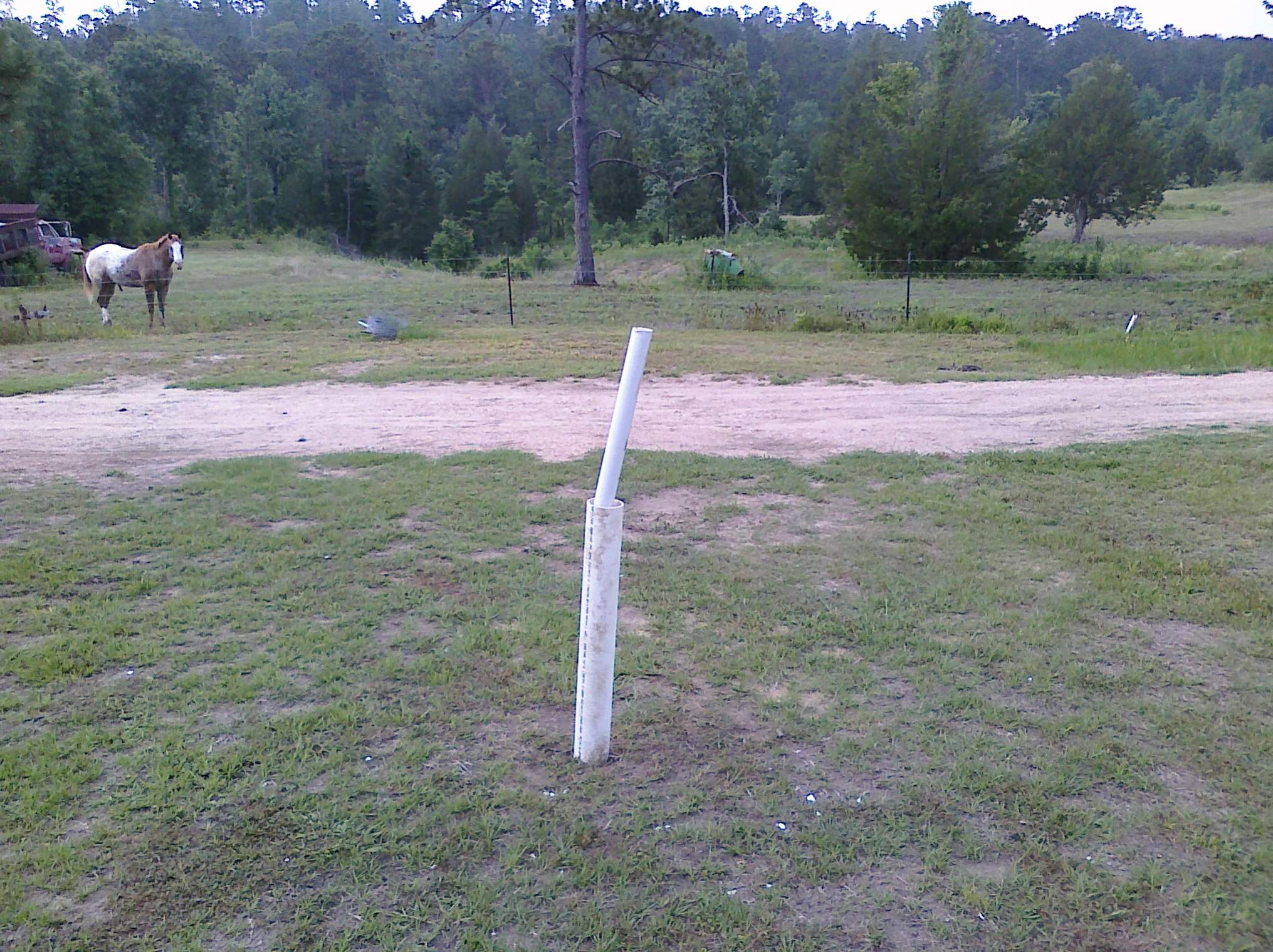

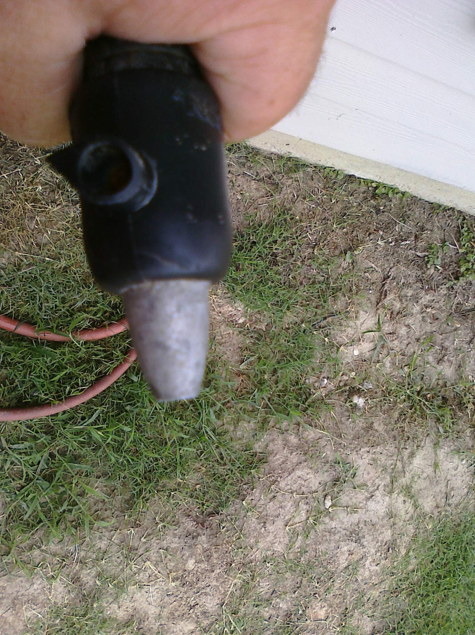

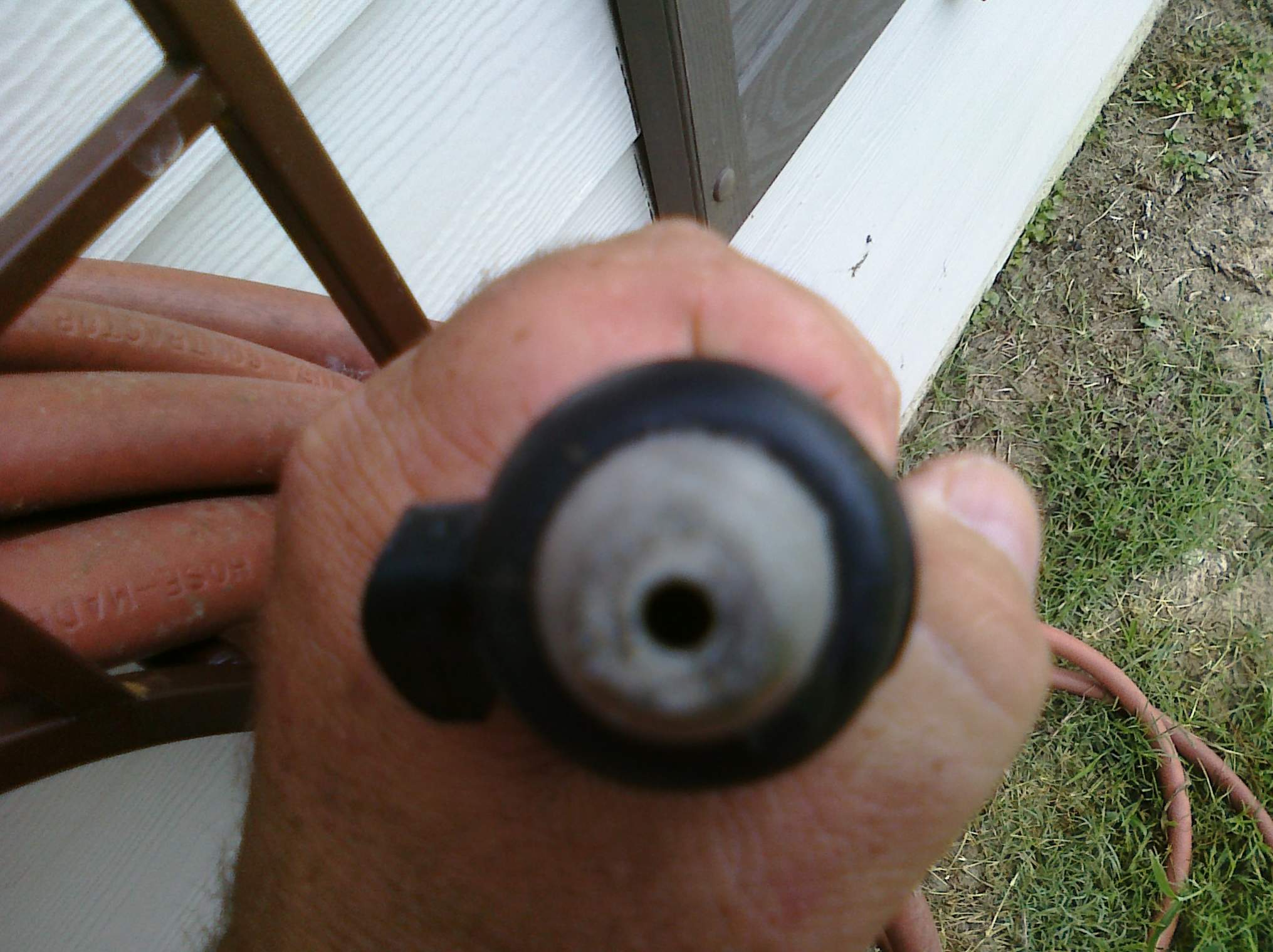

I have a started one myself, The wife wants a hand pitcher pump in the yard, She is going to build a flower bed around it. I figured if I was going to have to buy it ( for looks) I might as well try to make it work. So I work on it in my spare time. I am down about 16 feet so far. I used 3/4 pvc pipe with a jet nozzle on it hooked to a water hose. The jet nozzle cost about 2 bucks at Lowes. You just turn the water on and hold the nozzle to the ground and start washing a hole in the ground working the pipe in a up and down motion. You will be surprised how fast it will go down. I am washing a hole big enough for a 2 inch pvc pipe casing. I probably only have 2 hours in on it so far and my land is hard clay but has a springs oozing from the ground on the hills in places.

As Tim suggest jetting may be a good way to go and combine this with a pressure washer and 3/8" sch 80 pipe for the nozzle and add sections of pvc casing washing them both down until you get where you wan't to be.
Will need to alternate between the pressure washer and a hose with enough flow to carry the solids out of the hole though.

Guys, Keep in mind I am doing mine with just city water pressure connected to a 3/4 pvc pipe. I acualy did the first hole 5 to 7 feet with just the jet nozzle on the water hose but could not keep it going straight so I pulled it out and started over with the PVC pipe moving it over a foot. That being said I have already done 20 feet. It works very well with just the jet nozzle , pvc pipe and city water pressue.
