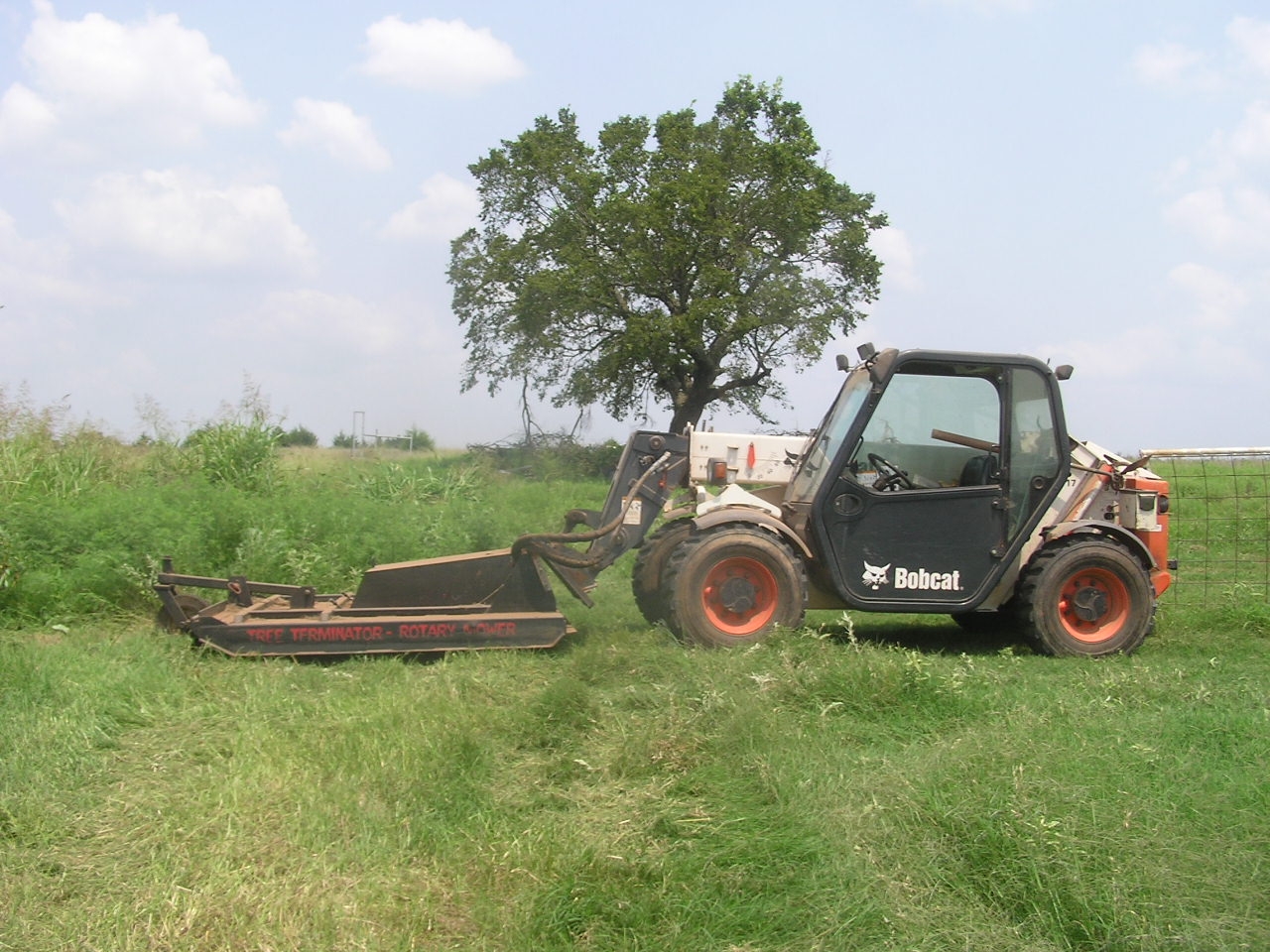

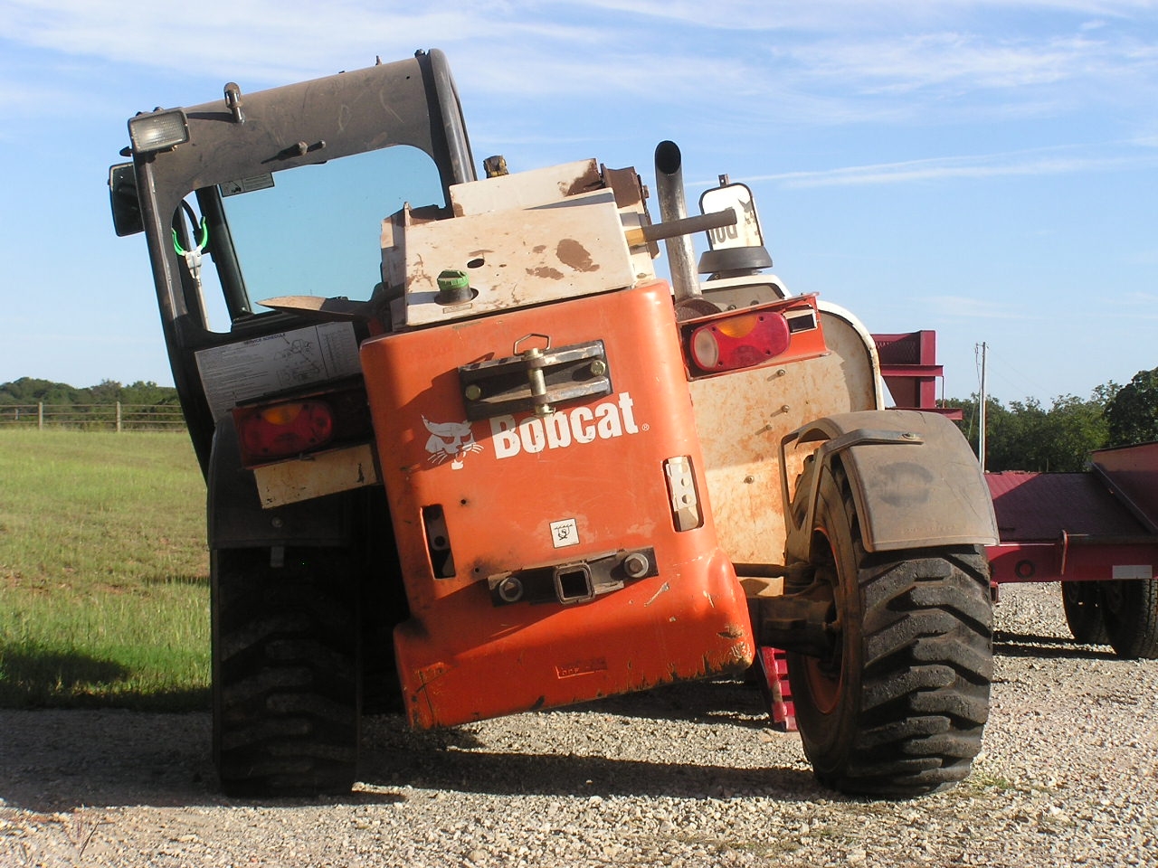

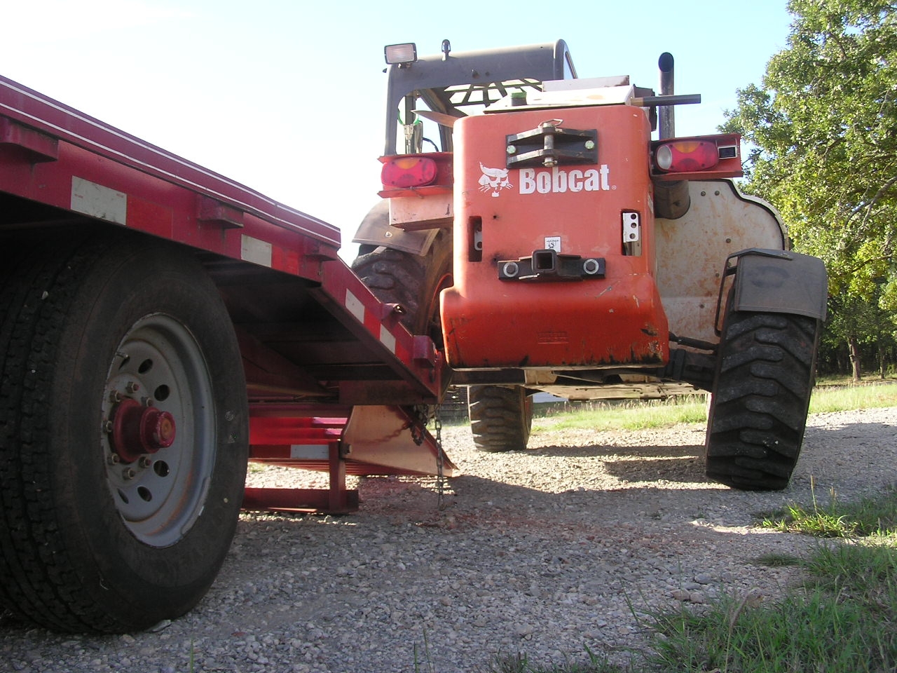

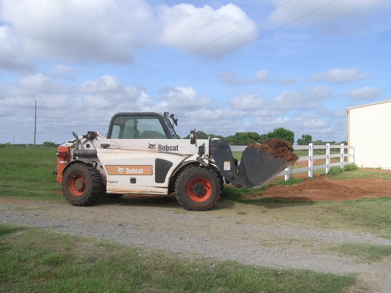

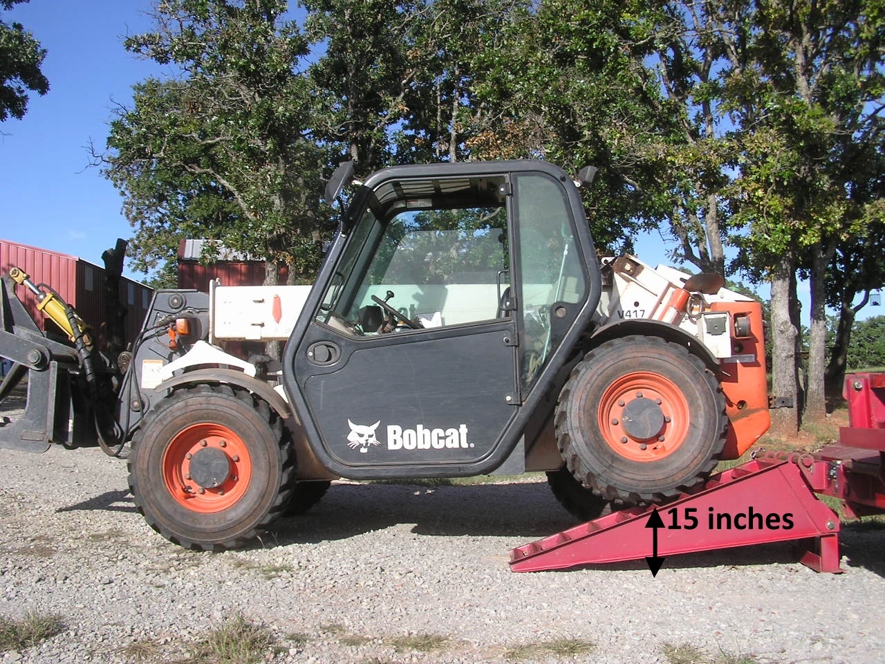

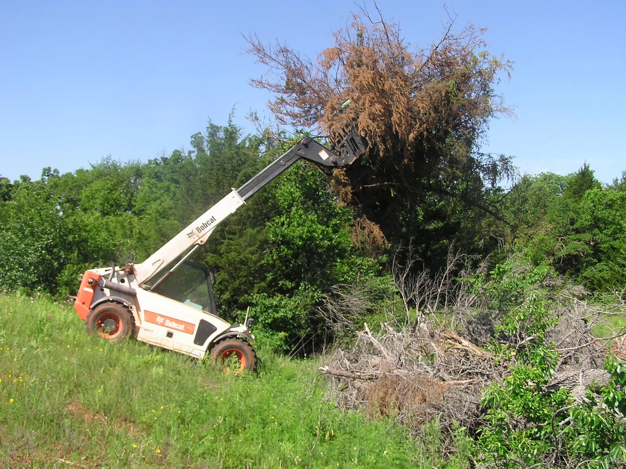

That looks like a mean machine.

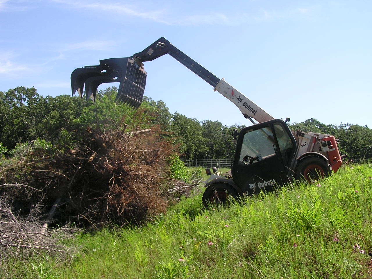

It is a “GADA” machine. "Go Anywhere Do Anything".
Great with the Monster Grapple:

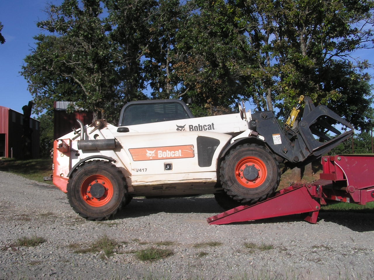

The front axle does not pivot like a tractor. The rear axle pivots:
Front axle on ramp:

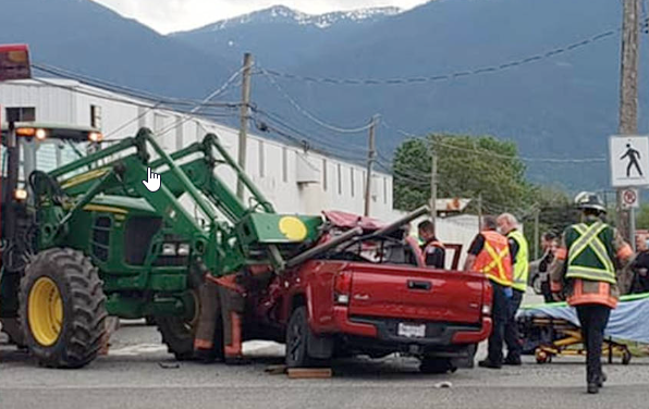

So this is the result of a crash with a loader in that configuration. I don't see any excuse for that negligence on the part of the tractor operator. It doesn't matter who was at fault. I know the tractor operator would not have wanted that outcome if they could help it. And they could have easily avoided it by putting the dang loader down. It's not hard. I would say most of them that I see roading in that configuration haven't even thought about the danger. But those that are aware, I must be holding a little contempt for because I'm getting mad while I'm typing this. Not at you, but I've seen some things that I would rather not have that were totally avoidable and it makes me mad to know that people's lives will never be the same due to an easily avoidable accident.
I'm just looking for the teaching moments. Please don't take this as an attack.
Not knowing the causes of this and the positioning of the vehicles prior to the impact can't really get much from it.
So it certainly isn't a teaching moment.
