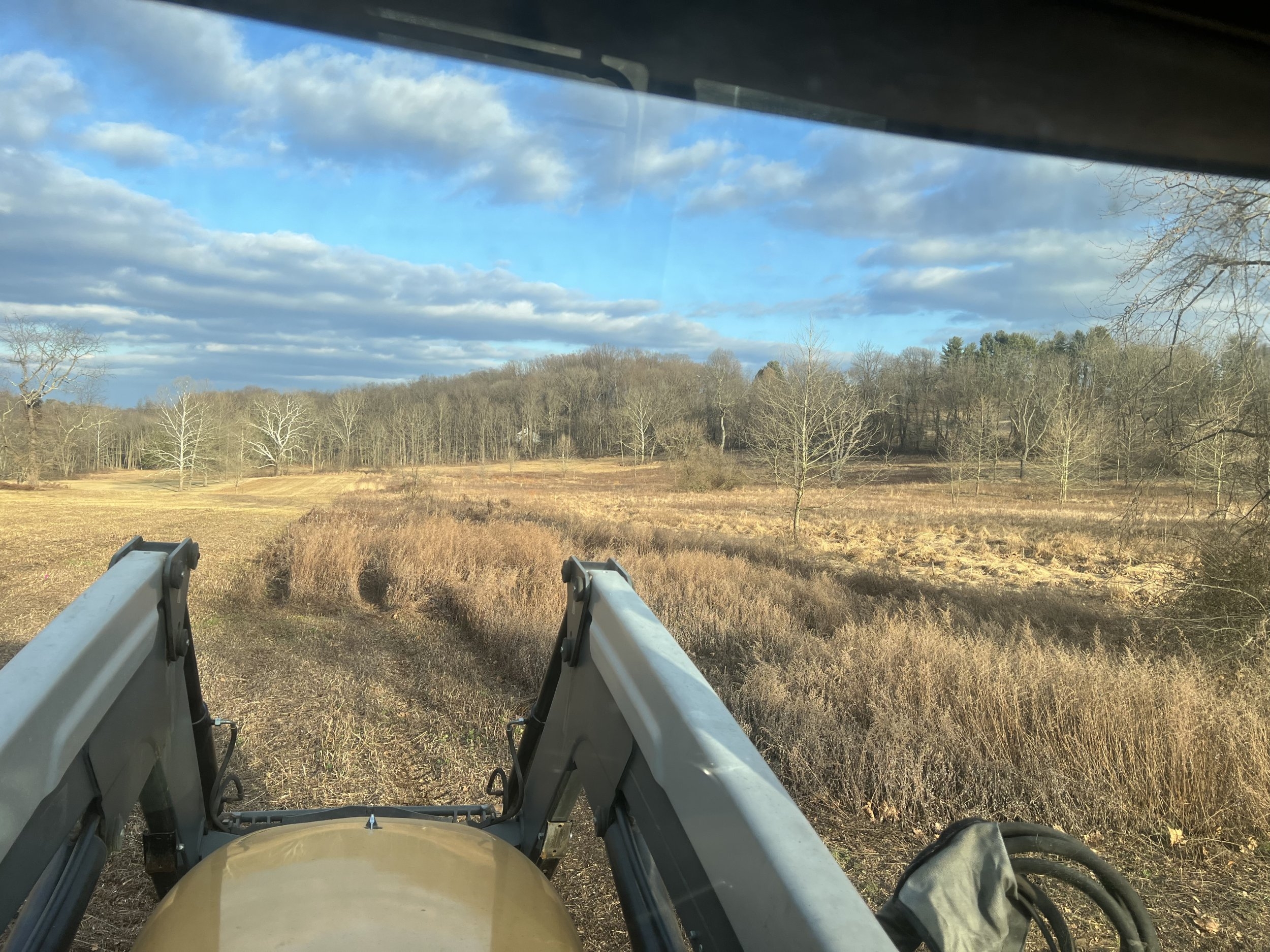

It can depend on many things.
I mow other people's fields for hire. Some fields I mow, it will be the first time I've ever been on the field. You don't ever get to see it for the first time "already mowed". Some fields, I've been on before, and I "know" the field.
I use my bucket as a tool to "find" surprises in the tall grass and weeds that "no one knows how that got there". I'm pushing the grass and weeds down intentionally with my bucket.
This field had weeds 10' tall in some spots, and at least hood high, all over the field, I'm using my bucket to push it down in front of me to see if "something" is in there:
In this field alone I "found"...
Stacks of pallets
Old vehicle tires
Old tractor tires
Chunks of concrete
Large mound of dirt
Right out in the middle of all these tall weeds, and randomly strewn about. My bucket, running low in front of me, ON PURPOSE, has saved me more times than I can count.

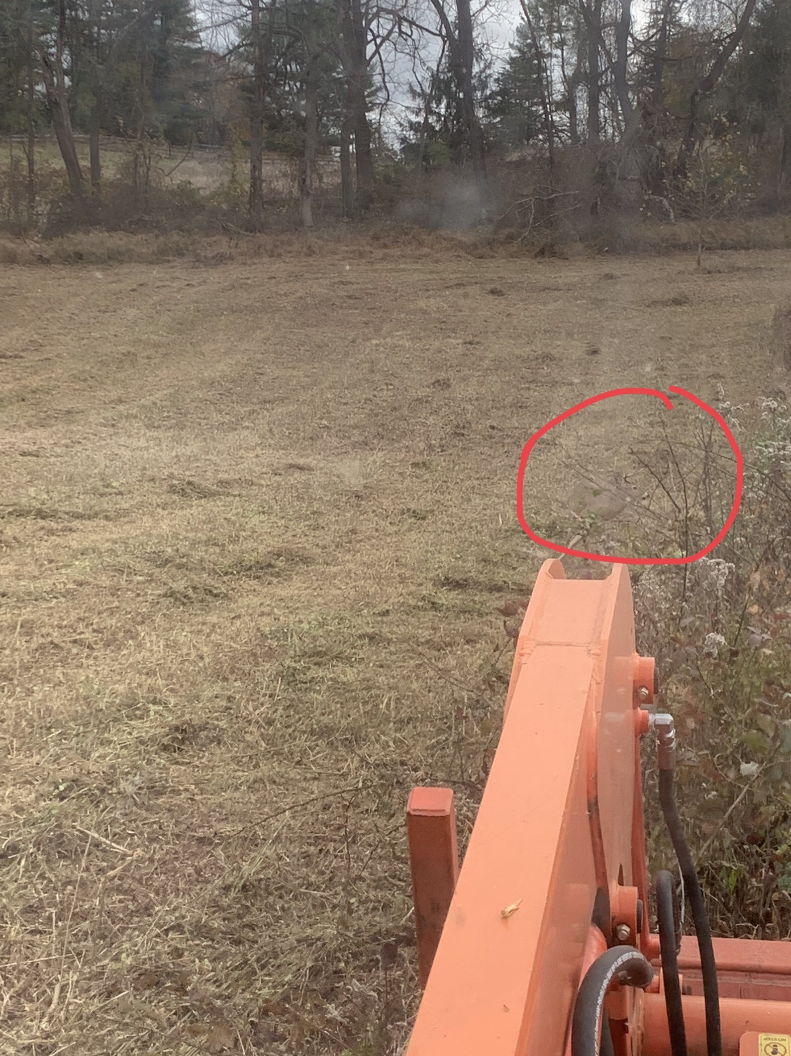

Things I have found with the bucket mowing overgrown customers' fields:
Ford Model A rusted and collapsed down to 2 feet.
Giant child swing set.
Forgotten cellar hole unknown to new property owner.
As well as numerous steel pipes, spools of wire, giant rocks, abandoned farm attachments, 100 foot pieces of log skidder cable, stumps(in ground and out), large logs, many grocery carts, guy wires attached to standing utility poles 40 feet away, stone and concrete spring houses. tops of 6 inch abandoned water well casings, and every other bit of trash you can imagine..
I always keep a bucket within 1 foot of the ground unless I know the field and can see clearly ahead. It does send up a lot of chaff.
You have to watch the temperature gauge and stop to clean if getting warm AND stop every half hour to open hood and clear trash off any hot engine part to prevent fires. Stop in an area you have already mowed to avoid picking up ticks.
I have even high centered on a rock I missed and backed off gently, looked under to check damage, and found the rock had caught the edge of the oil drain plug and started to unscrew it. Luckily it had started to drip and I noticed it.
On a mowing job, I agree with customer before starting, removing trash and large rocks from field is something I always do and charge for.
The customer never has seen what you hit.
Mowing with the bucket raised can cause an instant tip if you hit soft ground or a tree limb.

I have noticed some people driving there tractors with the front end loader bucket about 3' to 4'ft
off of the ground while mowing or brush hogging and I am wondering why some people do so . I always keep the bucket low to the ground .
