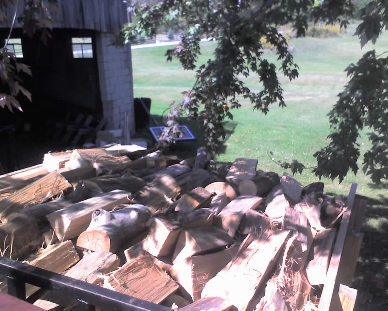

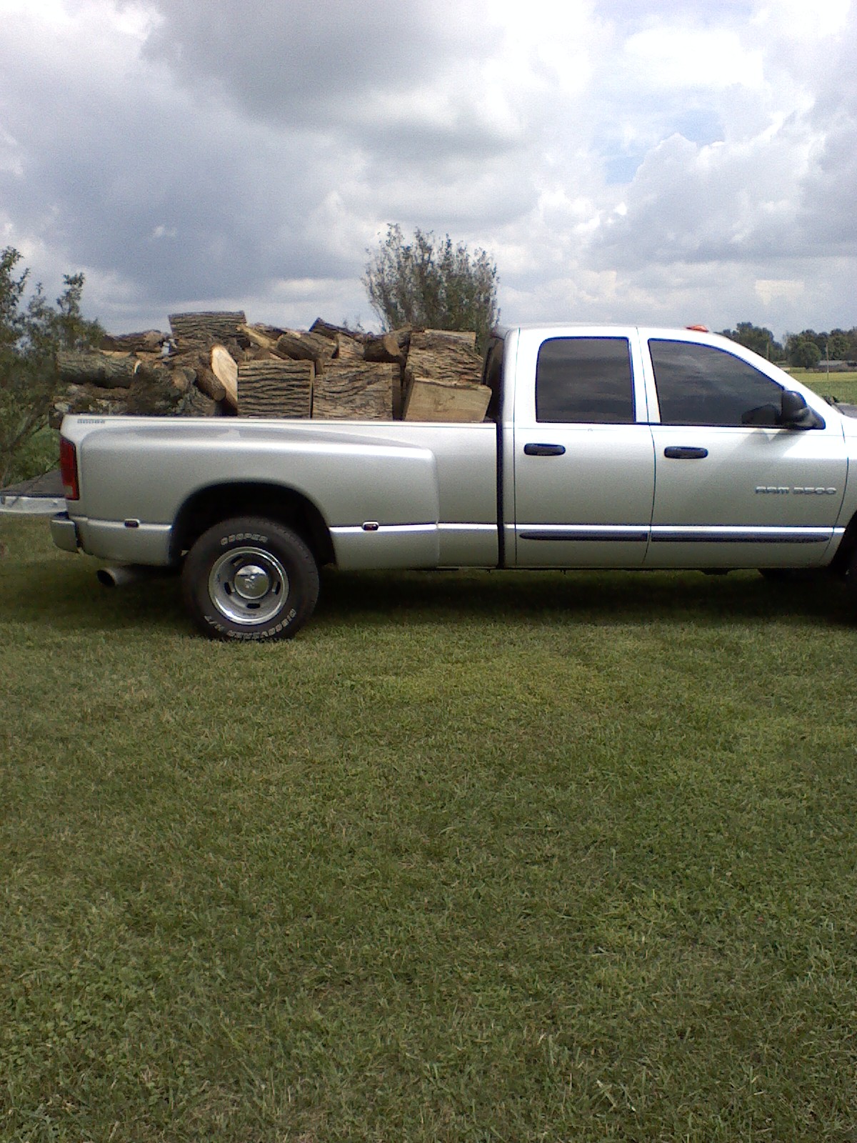

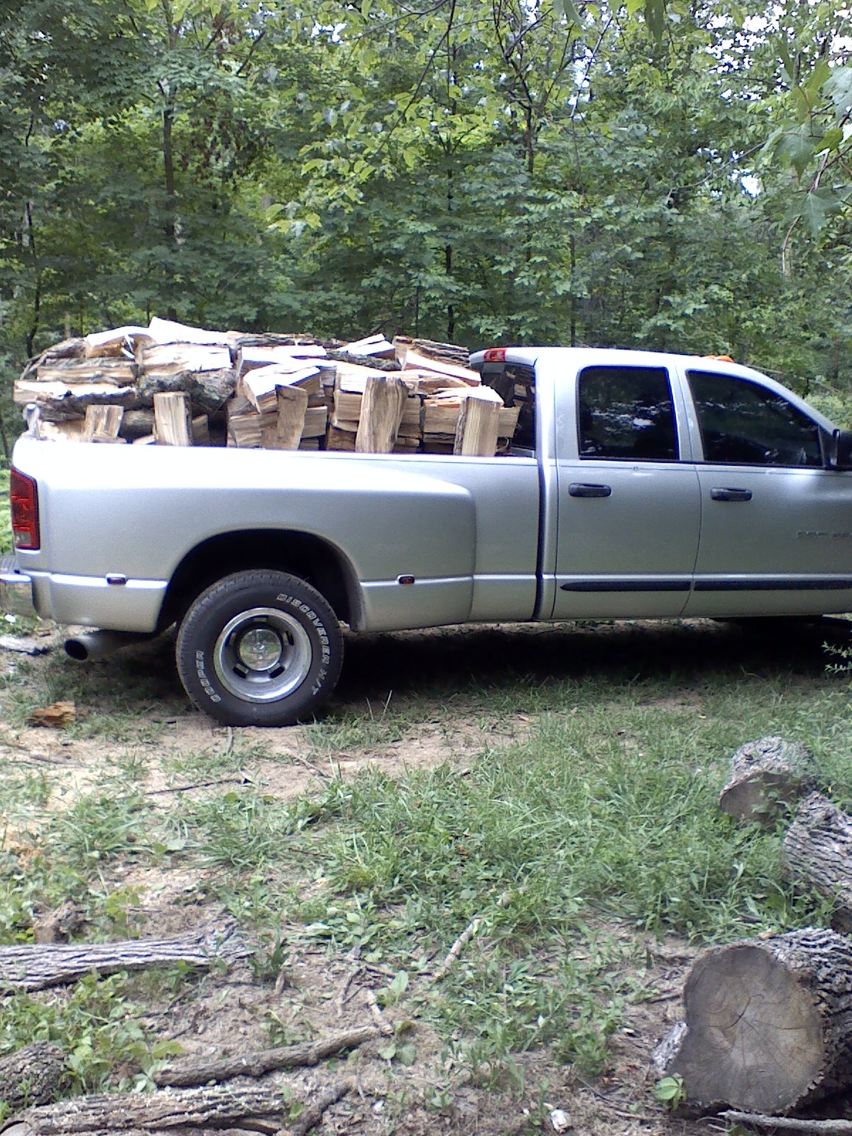

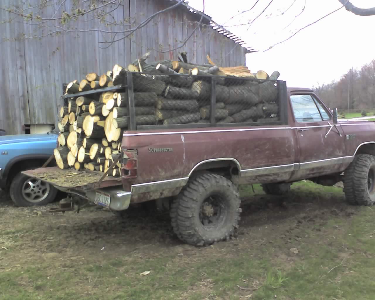

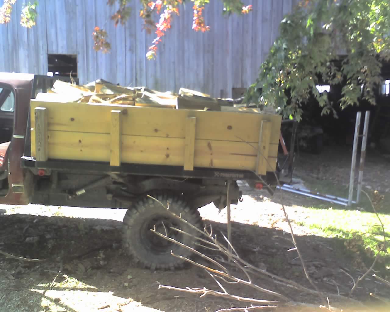

Probabally meant either rick or rack?? I think both are 1/3 of a cord. Which is "typically" the same as a face cord. A SINGLE stack of wood 4' x 8' (and usually 16" long peices)
And I have had a few "normal" trucks that would BOTH haul a FULL cord:D
