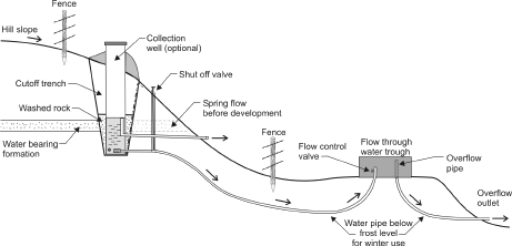

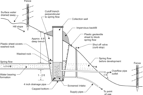

I don't know if these pics and article will help you or not.
Thanks.. nice idea and i might look at the high side of my property for and springs... I already do something like that but it's only surface water I'm collecting,,
Keep the ideas coming,, :thumbsup:
