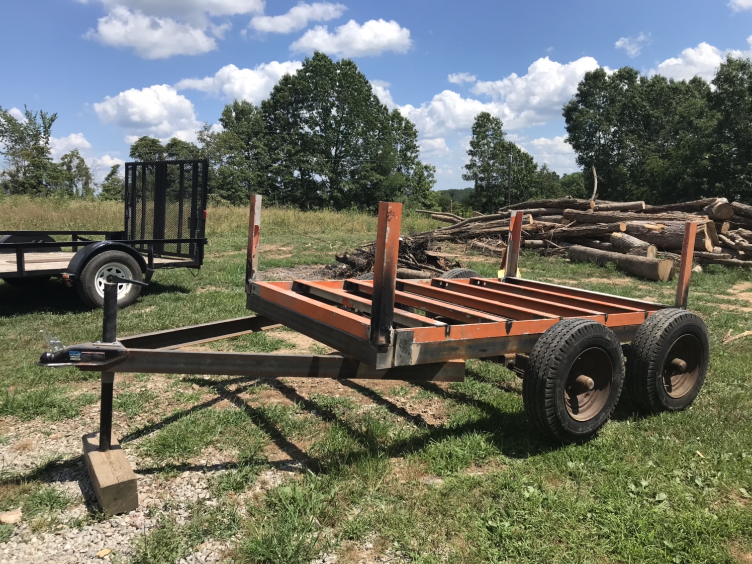

Mostly it will be behind my duramax. But I built it smaller so my kubota could handle it. I have a L2900GST

I liked the challenge of building it. So far I have less than 400$ in the whole project. I saved the dump hoist out of my truck and already had axles. I really like the ideas of the chains to have adjustments.
My down time I always like to tinker. Over the years I’ve worked at several farms and like the idea of building it myself. Worked beside many crafty farmers that have worked on and maintained their equipment. THe knowledge that these guys have had is amazing. These were the generation that built and started most of the factories in this area.

It’s been a long day but the floor is in. Ran out of bolts lol. Need one more row across the floor and then bolts to bolt the front boards on. The plan is to have the side boards removable. Tomorrow is wiring then it will be loaded with firewood for it’s maiden voyage.
