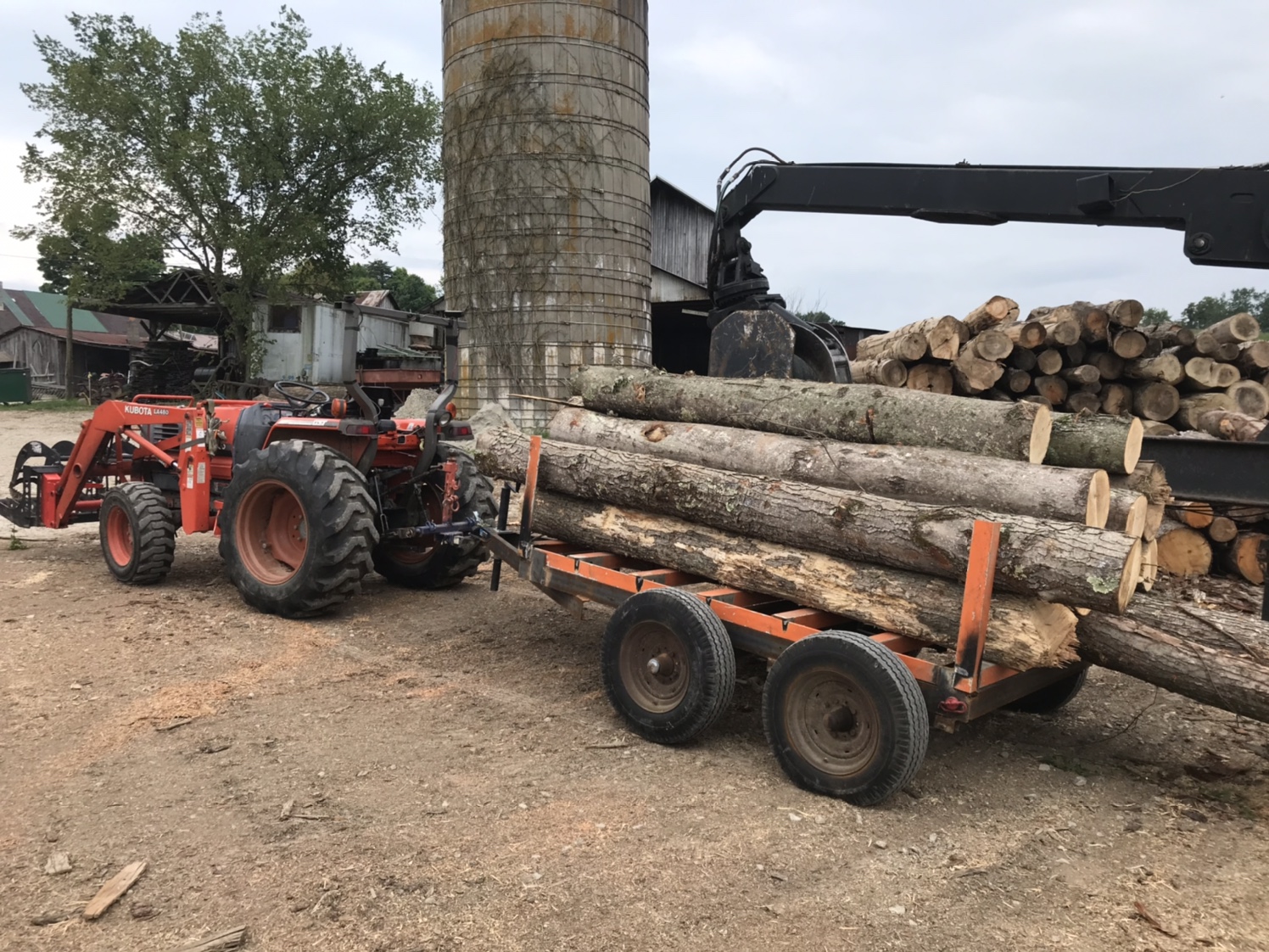

I don’t think I have a good picture of it but on the sides I welded a stake pocket. I’m going to get a piece of 3 in channel to support the sides.
/ Dump Trailer build #83
Itç—´ been a long day but the floor is in. Ran out of bolts lol. Need one more row across the floor and then bolts to bolt the front boards on. The plan is to have the side boards removable. Tomorrow is wiring then it will be loaded with firewood for itç—´ maiden voyage.

I don稚 think I have a good picture of it but on the sides I welded a stake pocket. I知 going to get a piece of 3 in channel to support the sides.
It will pin in the bottom. And I値l have a bolt with wing nut in the top board.
It shows in this picture:

There is 4 pins on the tailgate. I can pull the top 2 and lower it like a truck bed or I can pull the bottom two and the bottom will swing out like a spread gate. If I take all 4 out I can remove the tailgate completely. I’ll send some more pictures tomorrow. Unfortunately I did some work with the mini hoe today and it shut down on me. Spent most of the day messing with it. So now on top of finishing the wiring I have to pull the injection pump off the hoe. Nothing worse than a broken hoe. Lol
