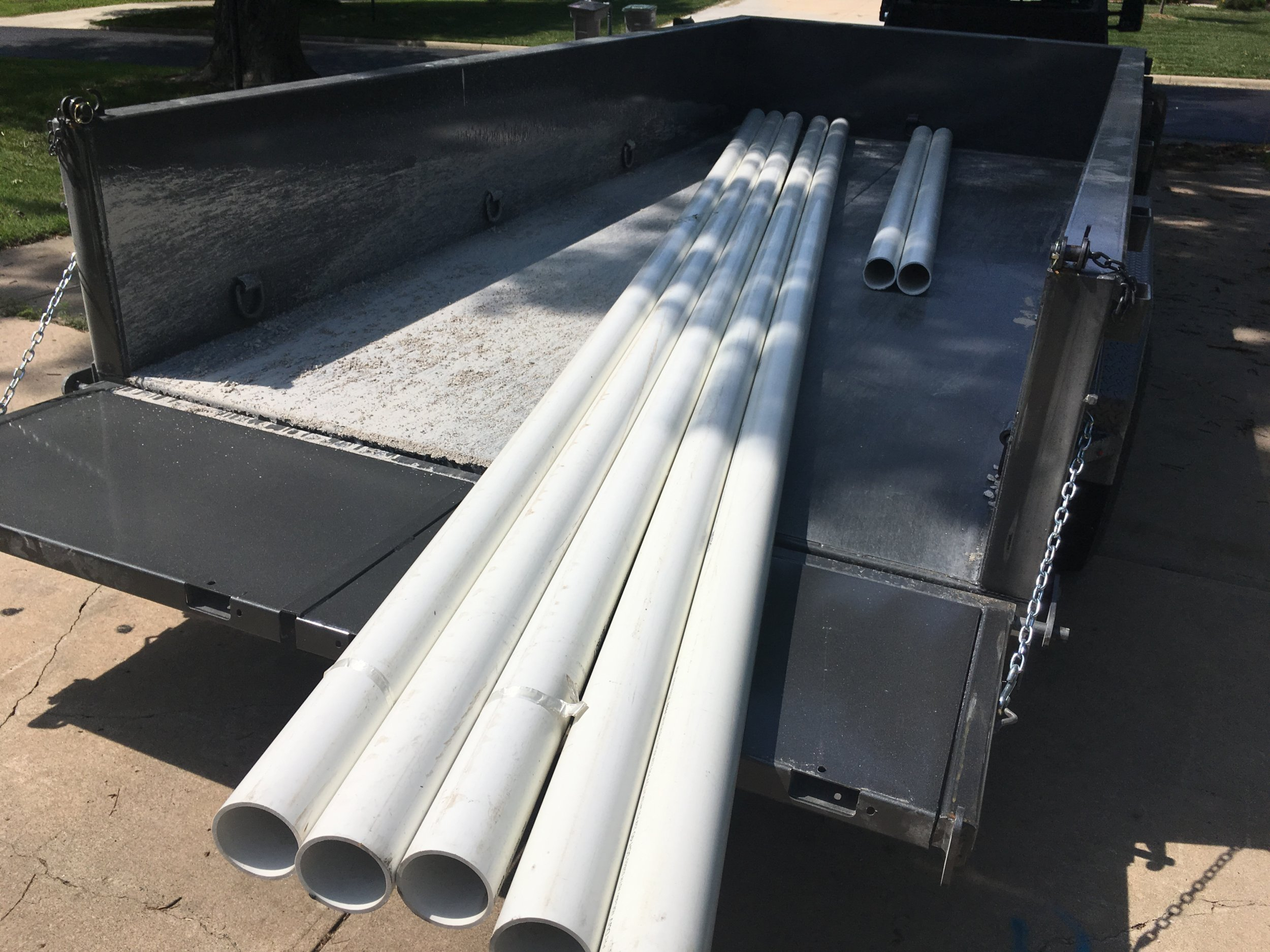

You can open mine from the bottom, open them in the middle like barn doors or open it from the top like a pickup. You’ll probably use the barn door function 90 percent of the time.
Mine, too. I’ve used it like a pickup one time….
/ Dump Trailer Questions #68
I use my ton dump truck like that all the time because the load gets stuck under it if you try to bottom dump and it doesn’t have a barn door option. Another bonus is it protects the lights and keep the back of the truck clean. But it doesn’t work very good to dump a trailer like that because they’re too low to the ground.
