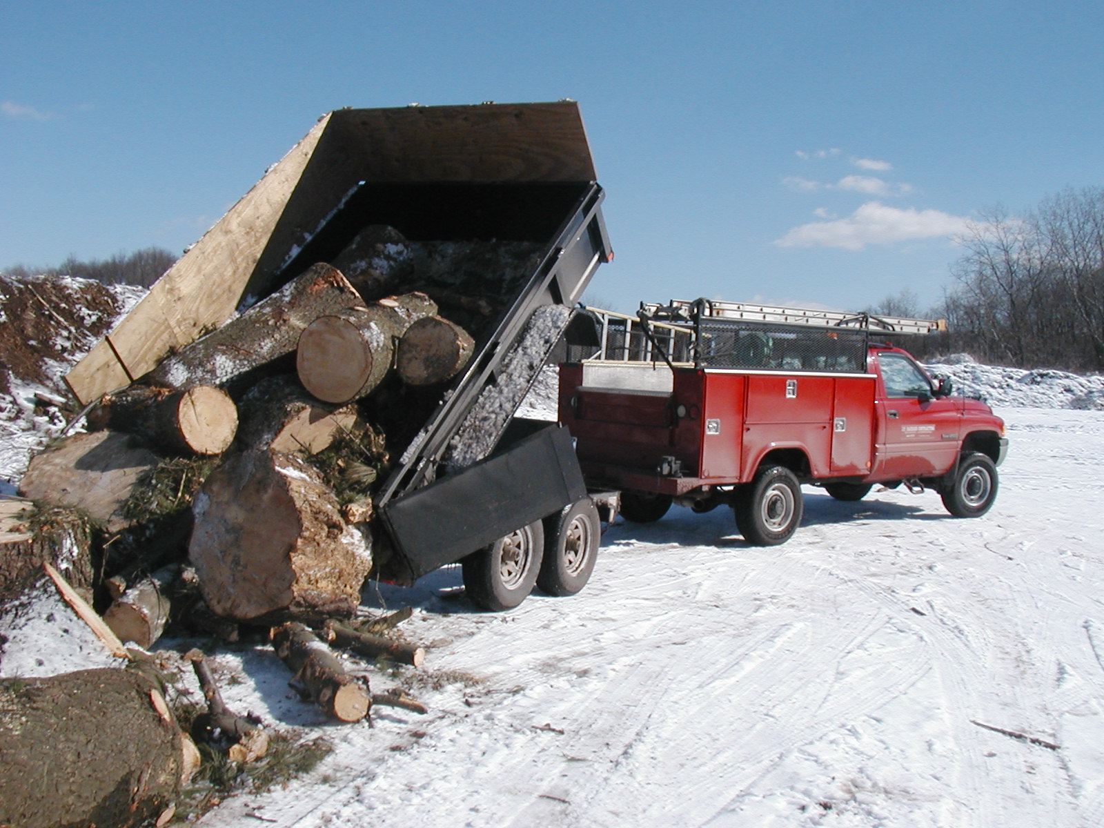

My 5 ton 6x10 EZ dumper is power down, never gave it much thought but it must be for more than just quicker return in cold weather,
I remember the salesman making a pitch about how it helps when loading a machine up on the ramps, preventing the bed from lifting, I think that's what he said.
It does make it nice to bring it down snug against the frame, makes for a quiet ride, no bouncing or banging. Probably safer when you have a machined tied down inside for that same reason.
JB.
