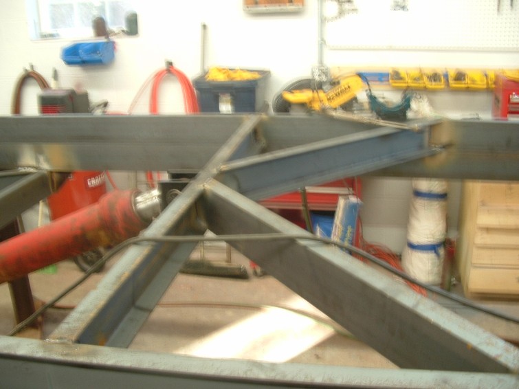

Nat, did you use some 'rithmetic on where to place the lift cylinder or just mount it where it looked good?
To me, that seems a critical placement.
ron
/ Dump trailer #38
Nat, it still looks good so far, but i have one remark.. i dont know how thick the steel is you used, but i think the C beam is going to wrap at the cylinder mounting point, and the strip of metal and the angle iron it is mounted to, will just be pulled towards the hinge point.. just my opinion.. /forums/images/graemlins/ooo.gif
/ Dump trailer
#39
Well, I used some "higher mathmatical functions", but I also lifted the bed to the correct angle and made sure the cyl.placement would work . I used some imfo from several people to get my cyl placement and I also looked at a factory trailer. Mine is in pretty much the same place as a foctory one, except I stood the cyl up a little more and used a larger dia. cyl. A guy down the road has one that I took some ideas from, and his is a 7000 lb trailer and uses a 2 1/2" dia. cyl.
I used a 4" dia. and had to get a pump with a larger capacity volume, so mine should be stronger. Later, Nat
/ Dump trailer
#40
Renze, sorry for the confusion, but it was just tacked together enough to make sure nothjing was binding or hitting together in the pic. The welding is being done and the bracing so the way the chanel is sitting in the pic surely isn't all I am going to do. I have since welded the chanel in place with brackets on each end and diagonal bracing, That was just a hurry up and snap it pic to show how it will dump. Later, Nat
