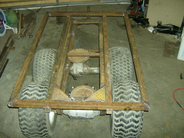

well here is where I am so far. I weled all the joints and finally attached the tow bar to it. I have the ring coming for the pintel hitch I have to connect to the front of the tow bar.

Keep those progress pix coming. Looks stout with those gussets.
I wonder why you wouldn't want to have those load bearing assemblies out closer to the axle bearings/wheels where the load would be more direct instead of cantilevered? This is not to say your structure isn't adequate, I was just wonderin'.

the bed frame for the trailor is that width and after that the side of the dump go upwards in a curve. so that is the widest I could go with the angle iron frame.
