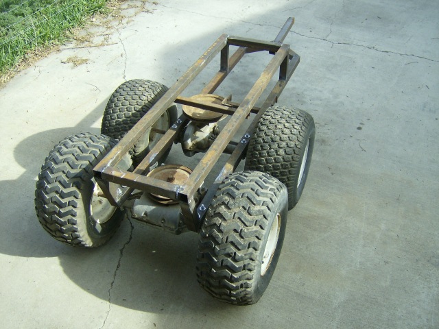

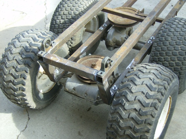

I finally got some time to get back to working on this dump trailer. I didn't take any pics because the work I've done lately hasn't really changed the overall appearance much.
I bought some 1/4" bolts, drilled holes, and bolted the sides into the stake pockets. While I had the trailer tipped on its side to drill, I touched up some of the welds.
I cut a sheet metal pan and welded it in place to mount the pump.
I bought a 90 degree elbow and installed it at the top port on the ram so the hose runs neatly down the side of the ram.
I welded 1" sections of 1" pipe in place at the front top corners of the sides and of the front. Then I cut a piece of 3/4" rod and welded a head on the rod so that I can use it as a pin through the sections of 1" pipe to hold the sides and the front together.
I took the front axle off and added some shims between the axle mount and the subframe of the trailer. The front tires and rear tires were mismatched enough that the trailer had a pretty severe slant forward. The shims have brought it back to level.
I keep thinking that I'm almost to where I can start cutting wood, but I keep finding all of these little things that I really should do first.

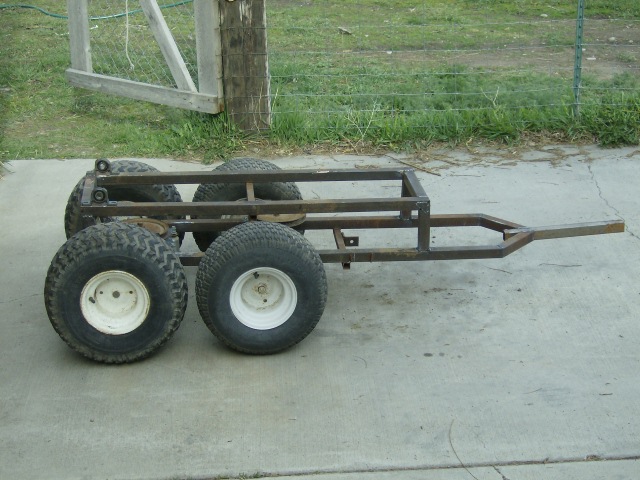

Well she's a long way from finished yet, but I finally got the hitch fabricated so I could hook it up to the tow vehicle.
The first picture below is the hitch. I decided to bolt the hitch on so that it can be at least a little bit adjustable. In order to make this work I drilled all the holes in one side of the square tubing with the bent plate clamped in place. Then I clamped the plate to the other side and drilled the holes in that side. This made sure that the holes lined up whether the plate is on the top or on the bottom.
I included a picture of the hitch pin too. A hitch pin really doesn't cost that much, but I'm pretty proud of myself for getting this one to work. I'm especially proud of myself for being able to weld the wire ring with my old beater AC stick welder.

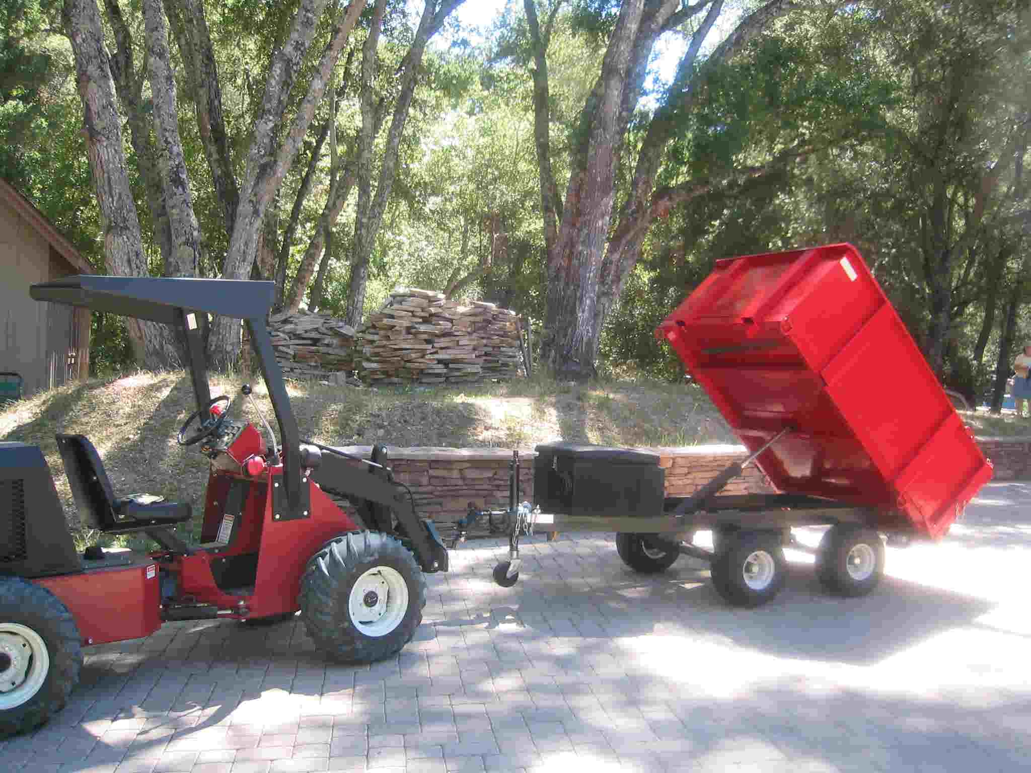

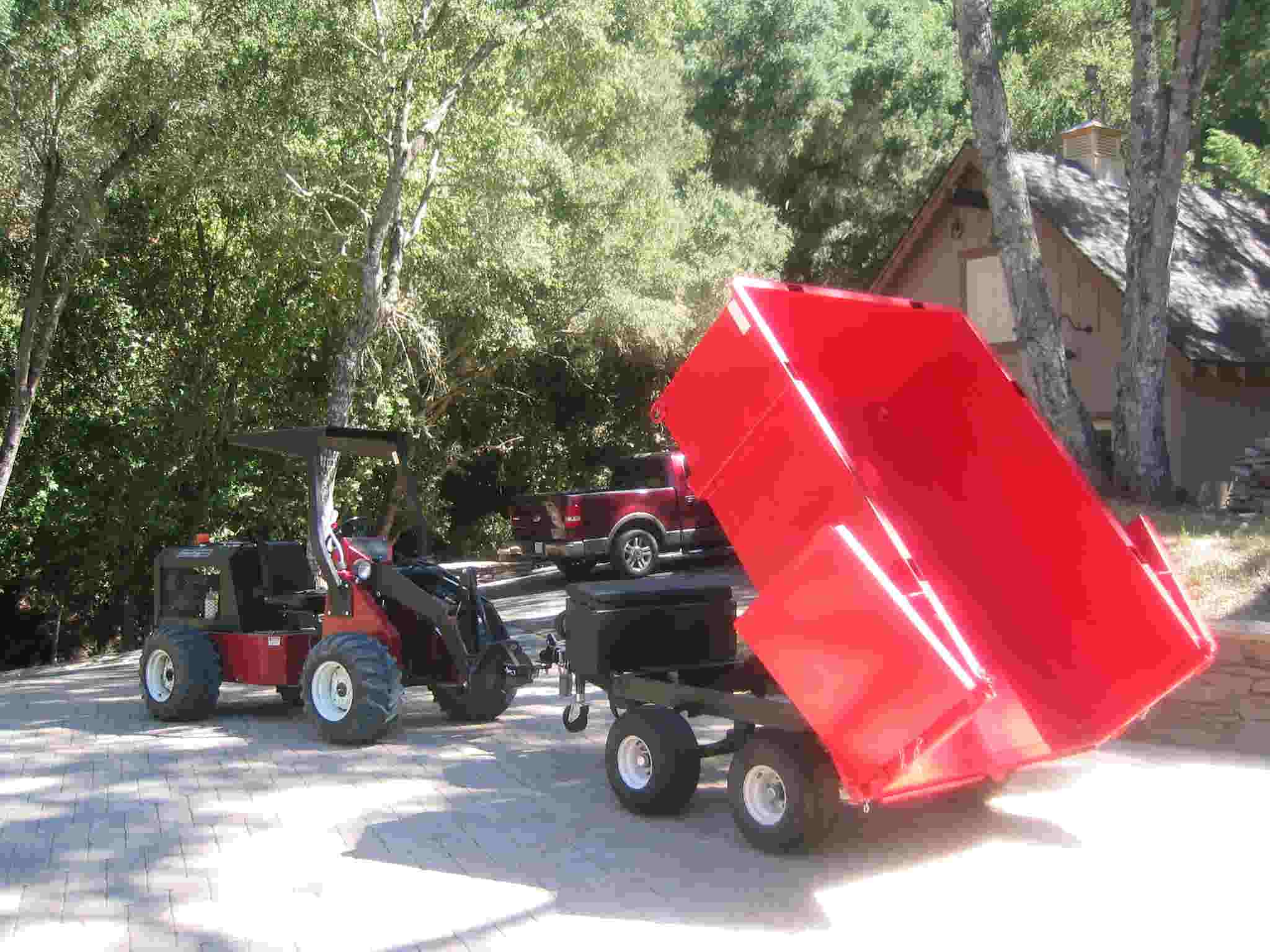

Here are my pics of it hooked up to the tow vehicle.

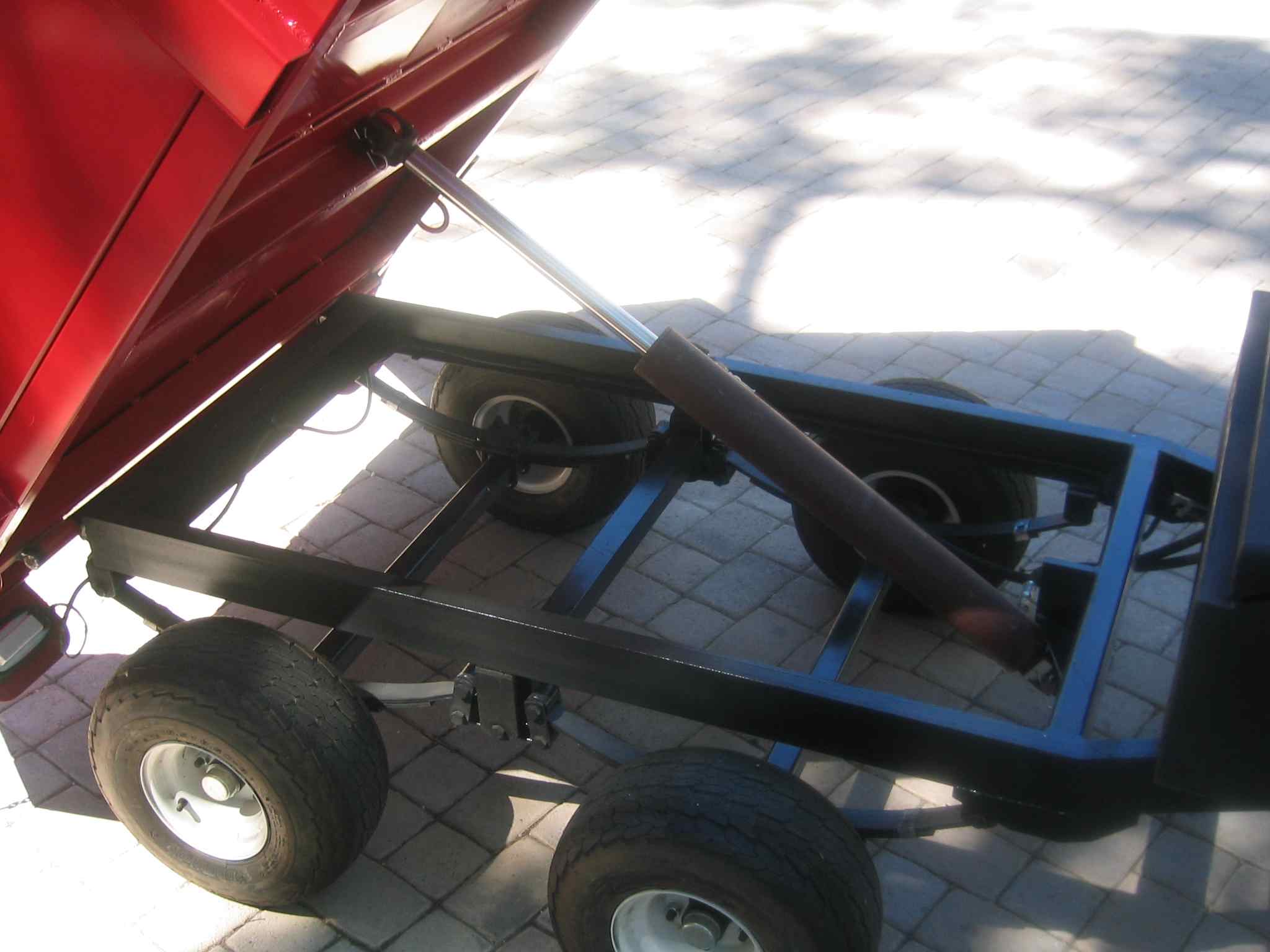

The way I've got everything situated on the trailer, I need a way to operate the hydraulics without leaving the tractor seat. I've put an eyebolt in place of the pump valve lever (pictured below).
My plan is to mount a lever on the front of the tongue that is high enough to reach from the tractor seat. This lever will be attached via a connecting rod to the eyebolt. This way I can run the valve from the seat while still having the pump tucked in close to the bed.
I think I'll end up making the eyebolt a little shorter to get it more out of the way of the bed coming down.

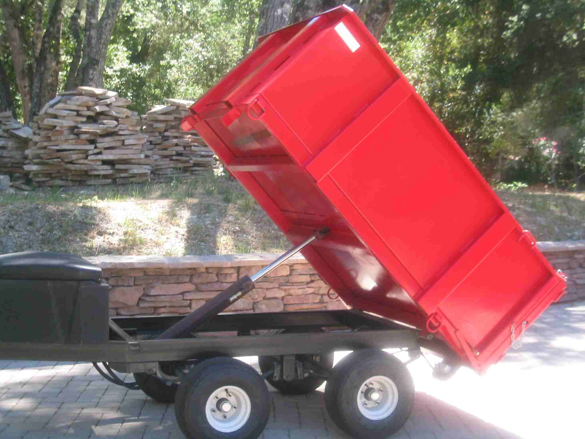

One thing though, I think you might need to reinforce the mounts for your hydraulic cylinder, particularly the one on your bed. Looks to me like its going to twist off.
If you are dumping a 1000lb load, due to the angle of the ram, you could easily have several thousand pounds of force on that point.
A few triangular gussets should do the job.
After I get all of the parts and pieces fabricated, I'm planning to break it back down into several component parts for prep and paint. When I have it broken down, I plan to add some structural support to a few places. I need to adjust the lower hydraulic mount about 1/16 inch, and I'm putting triangle gussets around both hydraulic mounts. I'm welding some angles in place on the bed frame and putting "trusses" in throughout the subframe to add rigidity. I may try to add some additional metal around the tongue to give it more strength, and I'm going to put angles into the bed sides. I'll seal weld some of the joints that I can't really get to with everything in place.
Then I'll prep and paint. Or pay someone else to prep and paint.

I'll make an attempt at answering this question.
You need to know four things...
1) the upward force needed to dump the load.
2) the rise of the ram (the difference in height between the top of the ram and the bottom of the ram)
3) the length of the ram measured from pin to pin.
4) the hydraulic pressure of the system that you are using to power the ram.
I start by figuring the force needed to dump the load is equal to the weight of the load itself. This is a rough guess since the weight in front of the ram attachment point is different from the weight behind it and both are altogether different from the weight behind the hinge point of the dump bed. But, it's the rough guess number that I have started with.
The needed force of ram is calculated by multiplying the actual length of the ram as measured from pin to pin times the force needed to dump the load divided by the rise.
If you are dumping a 2000 pound load with a 24 inch ram with a 6 inch rise, your force needed is 24 X 2000 divided by 6 = 8,000 pounds of force.
The cross-sectional area of a ram that will produce 8,000 pounds of force is calculated by dividing the needed force by the system pressure. If you have a 1500 psi system, 8,000/1500 = 5.33 square inches.
To calculate the ram size, divide the cross sectional area by 3.14159 (pi) and then take the square root of the result. Multiply the answer by two to get the ram diameter. 5.33/3.14159 = 1.69 The square root of 1.69 is 1.3; 1.3 X 2 = 2.6 inches.
In this scenario you'd either need a three inch ram (since they don't make 2.6 inch rams) or you'd need more pressure or a bigger rise to make a 2 inch ram work.
