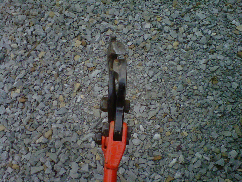

WEll, I got my chains modified but not without bending the snot out of that cheap tire chain tool. I finished one set and they didn't survive to complete the next set. Good thing I had some additional side hooks that were already open and I could just cut the old ones off and crimp the new ones shut! It made quite a difference in the little bit that I got to test them outtoday! I dont know if its in my head or not but they seem to feel alot heavier to!
You must train and lift weights with the Kioit factory filter-installer dude! (See some of the horror stories of removing the filters for the 50 hr service).
Did you buy the large chain tool? Mine is the 3' one and quite substantial. I'm sure I can't bend it.
When opening the side hooks, I place the blunt, 3/8" square shank of a centre punch between the two hooks so they don't close together while prying them open.

Well, I should admit I started using them on the floor, then on a bench and it was definately a work out. YEs I got the biggest ones they had. I had to take some pictures to send to them. I did try and straighten them a little bit to try and use them but that was a waste of time. IMG-20130220-00063.jpgIMG-20130220-00064.jpgIMG-20130220-00065.jpg

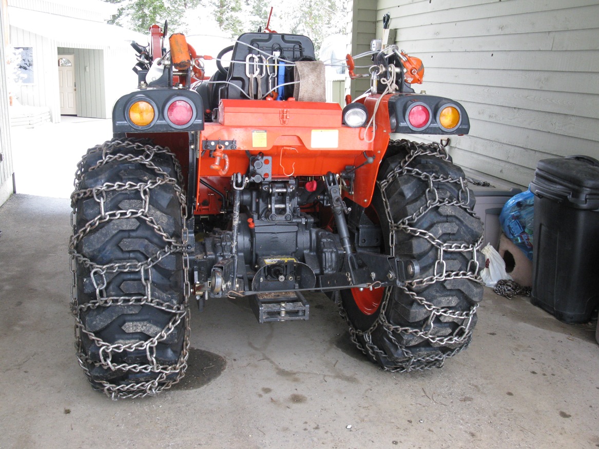

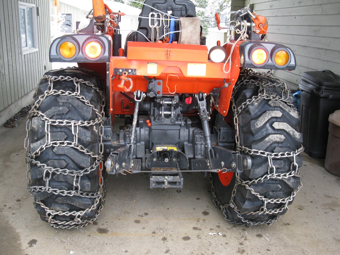

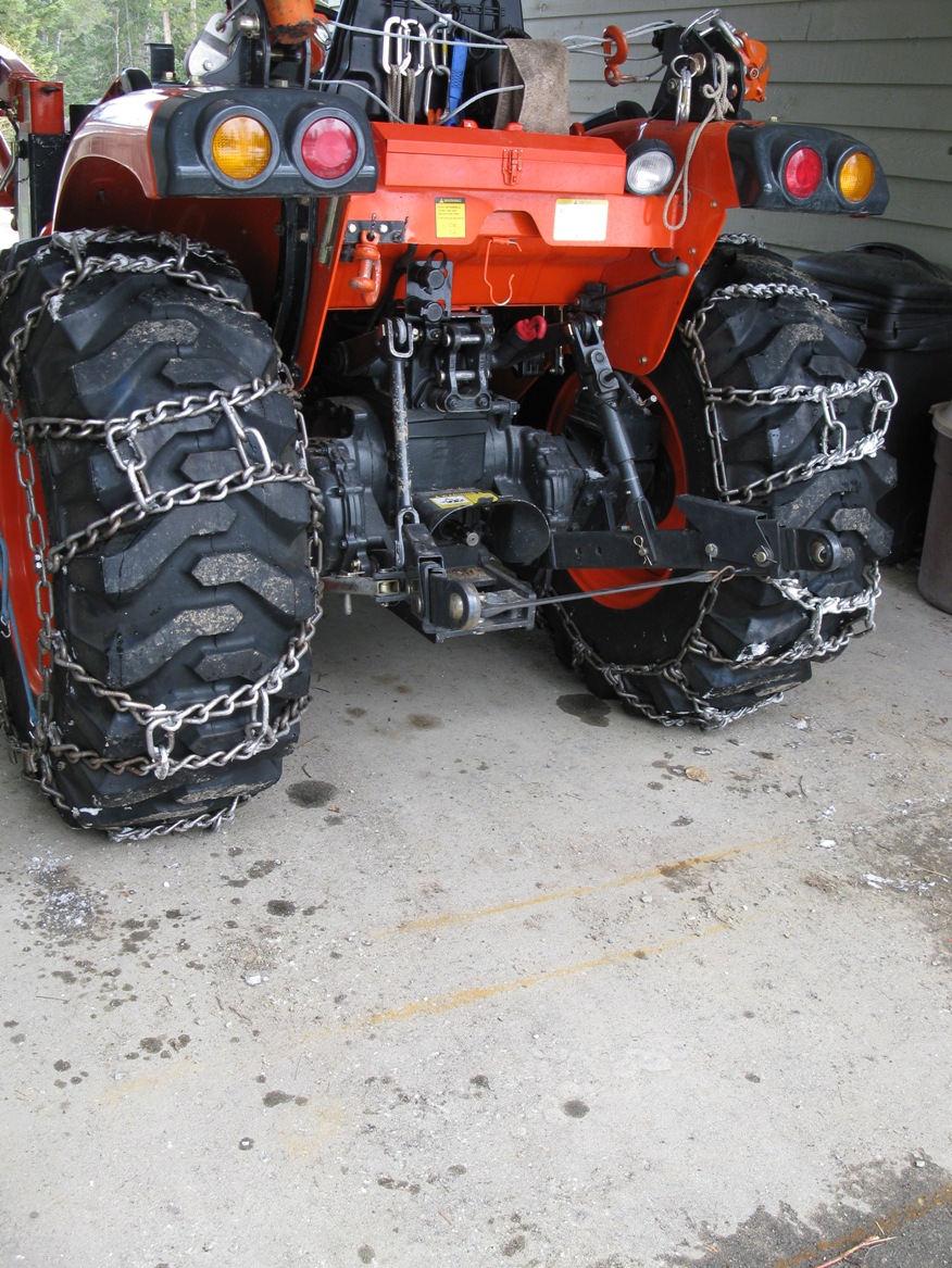

I finished the chains Thursday and mounted them today. They are MUCH smoother and will be more effective. Part of my original roughness is that the cross chains are a link longer than they should be, leaving a larger gap between the DUO patterns.
The modifications went much easier than anticipated, taking around 4 hours working time but with lots of breaks.
As hoped, adding 4 patterns to the existing 7 tightened up the end-gap. The DUO patterns end at the best possible location but I will still fill in the end gap with one single cross chain, where I required two cross chains before.
Photos of the original chains:
The DUO pattern gap was about 4 tire lugs and 2 cross chains were required to fill the end gap.
Photos of the new chains:
The DUO pattern gap is 2 tire lugs and I will add 1 cross chain to fill the end gap.You can see the gap on the right tire in the last photo.
The original chains made for a rough ride because the inter-pattern gap caused the tractor to go from on the chain, to completely on the ground, and back on the chain. With the new chains the tractor is always riding on one of the cross chains.
