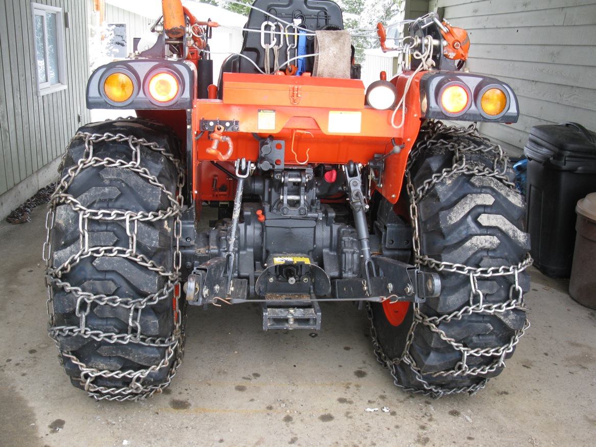

Since modifying my DUO's two years ago, I wanted a better solution to using a single chain to fill the end gap seen on the right tire of this photo:

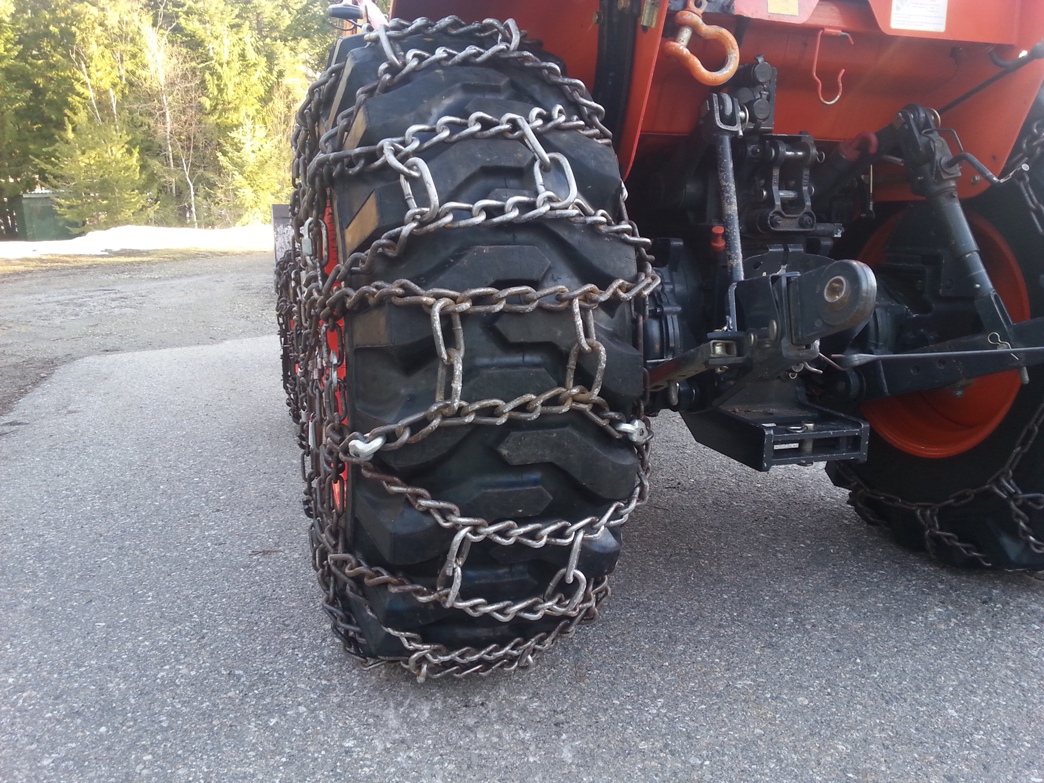

The single chain worked, but after much use the patterns can shift as shown here:

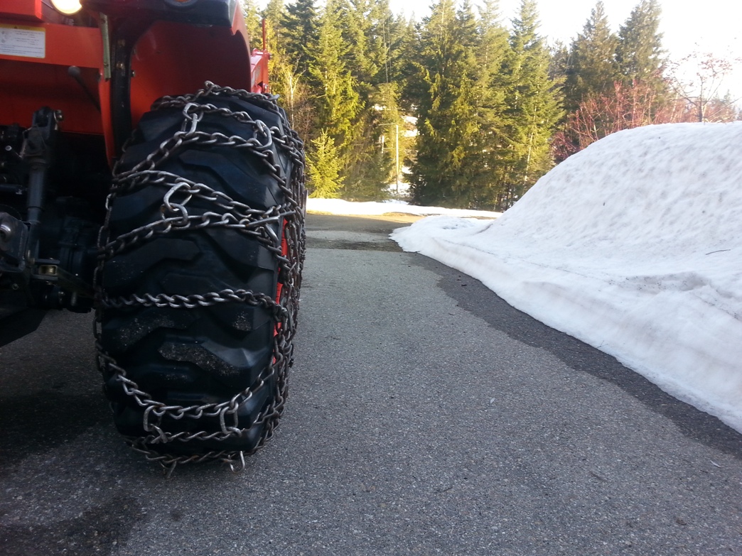

I ordered a couple more DUO patterns and 10mm link couplers to rework the end gap as shown here:
I have not used the chains but I think it will stop the shifting around the end gaps.
Purchasing the pin couplers was interesting. CanadianChains.com quoted $15.00 and $16.00 EACH (including delivery), for 8mm(which I will use for some smaller chains) and 10mm couplers. I got them from a local shop (Western Equipment, Vernon) for $2.78 and $4.92 each.
