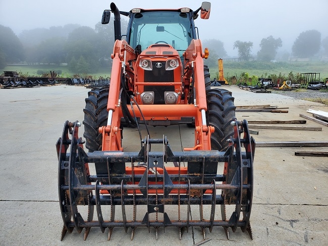

The design in that area has been the same since the beginning, on the 60 and 66, and the first 66 we made, which has been totally abused by our 141hp Kubota, still lives on that tractor today(took this pic last week), with zero wear issues there. Actually, it went a few years with no grease there, and does not have 0 rings, which aren't really necessary, IMO. If something is gonna wear, it'll be the bolt, which is very easy to replace, even though, with thousands in the field, I've never heard of anyone needing to.
Bottom line: From the outside looking in, everything can be nit picked. If something needs to be changed, we have, and will change it. This Wickedness is Amazing, and thousands of reviews from very proud owners solidifies that claim. It is the absolute best, in numerous regards.

Glad ya like it, man. Yeah, if Ted has taken out massive trees with that thing, which doesn't even have the Wickederrr improvements, with zero bends or signs of wear, I don't think anyone has anything to worry about!
Travis
Here's one of those fun(and kinda scary) moments..
Four years ago, btw..
