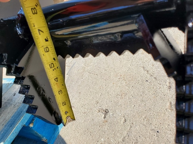

What's the height of the tine at the round tube?

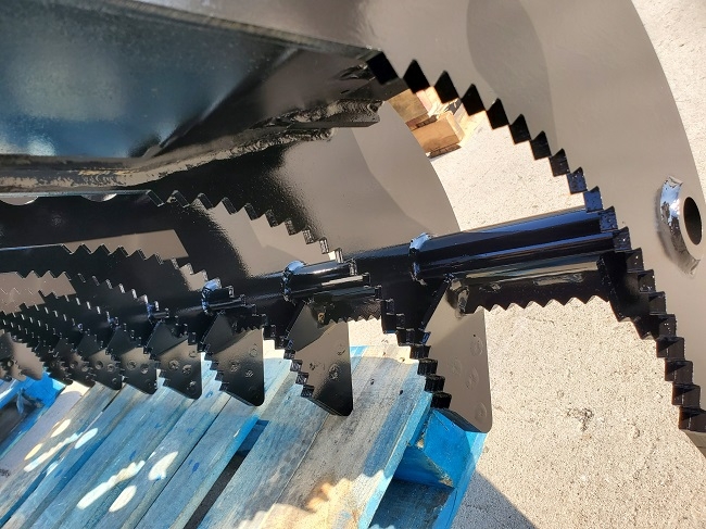

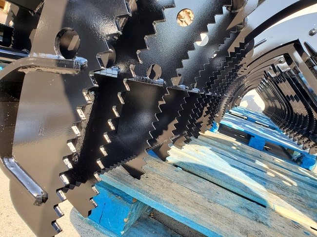

I just went out to refresh my memory, and snapped a few pics while I was at it.
I also verified that it's the same for 250 pound Wicked 55, 400 pound Wicked 60, and 660 pound Wicked 66.
66 is best for an M59 TLB, and that's what I photographed..
Travis
Lid tines are every bit as Wicked nasty as the lower ones. Great for gripping and spreading/smoothing loose dirt and material.

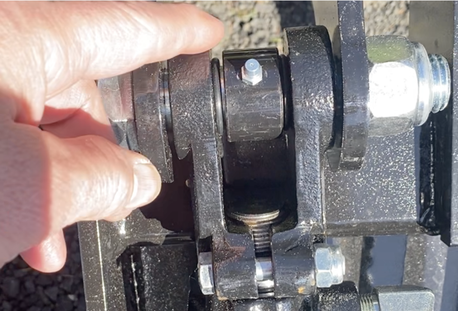

I bought the 60 also. The ETA was brutal for mine also, but it was worth the wait. It seems to be a great piece of equipment.
The only thing that I could see that could be improved, and pretty easily improved, is the grease points on the lid/cylinder connection points. It looks to me like the pipe between the o-rings should be longer.
I reached out to Travis via email about this (who was great to work with during the decision making process, by the way). He wrote that the grease will get to where it needs to get, or something like that. As it is, the grease just makes a mess between the pipe section and the cylinder clevis. It looks greased, but is not. If the pipe was longer, tight to the o-rings on each end of the pipe, it still wouldn't be ideal, but I think grease would have a much better chance of getting to the friction points.
I would be interested to know if others have noted the same condition that I did.

The picture I added is slow to load for some reason. I think is because it is a screen shot from a video that I posted to Youtube. Here is that link:

IMO you’re absolutely correct 99%of the grease is just taking the path of least resistance and not getting under the cylinder clevis where the wear is gonna be. If it were mine I’d drill a tiny hole in each clevis ear then a little bigger hole sized to tap for grease fitting. I use Molly grease on all pins and bushings at 10 a tube I’m not a fan of wasting it. Poor design

Hmm, I have to admit, that has me concerned about my choice, now. And I note that the video you posted on YouTube was made a year ago. So they haven't improved upon the design since that time? Grease would just squirt out of the sides of that collar with the grease fitting on it. Any grease that got to the actual friction areas would just be minimal, at best.
I believe that most of their stuff is likely manufactured via CNC machinery, so I would think it wouldn't be an insurmountable problem correcting this issue. The appearance is that the problem is just being ignored. Which really doesn't give me a real warm and fuzzy feeling about it.
Heck, now I am rethinking my purchase. Not that I expect to use the grapple excessively, but the reason I decided on this EA grapple is because I thought I would be getting the BEST.
Maybe I will ask Travis about this. Then based on his answer, decide whether or not I really want to buy this particular grapple.
I do not know if the design has improved since I bought mine. It would be great to hear that it has improved. If it has, I might be inclined to acquire the improved parts and retrofit mine.
