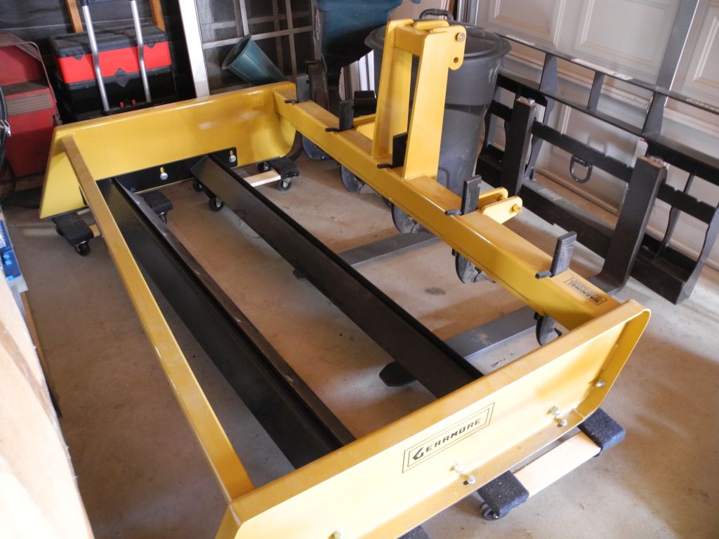

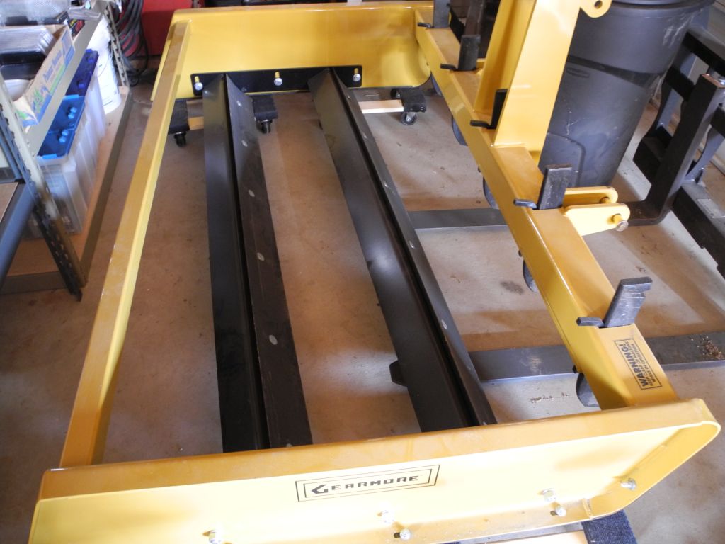

Brian, Scrambler82 - I'm feeling quite stupid... I don't have a Land Pride unit, I have a Gearmore GS6.
I believe they are in Ontario (So Cal, not Canada) - one of the few mfg outfits on the west coast.
   / EA Land leveler for driveway, comments please #10
Actually, Gearmore is nothing more than a middle man. To the best of my knowledge and I have been there, they build nothing. They are just middle men with their logo on things. So Dave, when do we get to see your equipment dirty???? :eek: ;)
