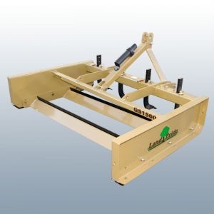

Just a novice's opinion and yes we know everyone has at least one but also my opinion is based on looking at the Land Pride (LP) unit in person and looking on the web to,see the EA Unit.
The LP unit is built rugged, compared to what I see on the web, as rugged as any and the lowest priced unit with Stratisfiers of any.
The EA unit is rugged looking, built to last but the $1600.00 price tag is almost $500.00 more than LP, why should it be, I for one do not see any justification for the additional cost.
the Gearmore does not look very rugged and it too costs more than the LP Unit.

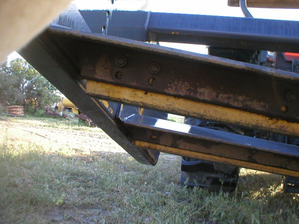

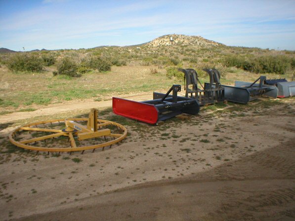

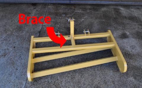

Travis, maybe look again regarding the back brace. From the looks of it they all have some back bracing, just different amounts per size of unit. As far as side bracing, not sure that it is needed between no real load on the mast and probably 3/8" or 1/2" tube. Don't the top links have ball swivels to allow side-side movement? I know that on my Road Master LPGS, no side braces, no problems so far after some 8 years of use.
As far as the none reversible cutting edges, typically these types of setups have a second set of holes to allow for lowering the cutting edge. I know that is how mine are. :cool:

Yes, a tiny triangular gusset and no side bracing. I'm not saying that would be totally necessary for general use with a 40hp and under tractor(which is what theirs is rated for), but we all like a little extra don't we?
A unit with back and side braces would withstand more punishment and be more likely to survive a side impact from a blunt object.
Regarding the cutting edges, wouldn't flipping the blade and having a brand new edge be better than moving down a worn out edge?
I'm not saying that the other wouldn't get the job done, but i think they're far more than a couple hundred dollars of extra value packed into ours.

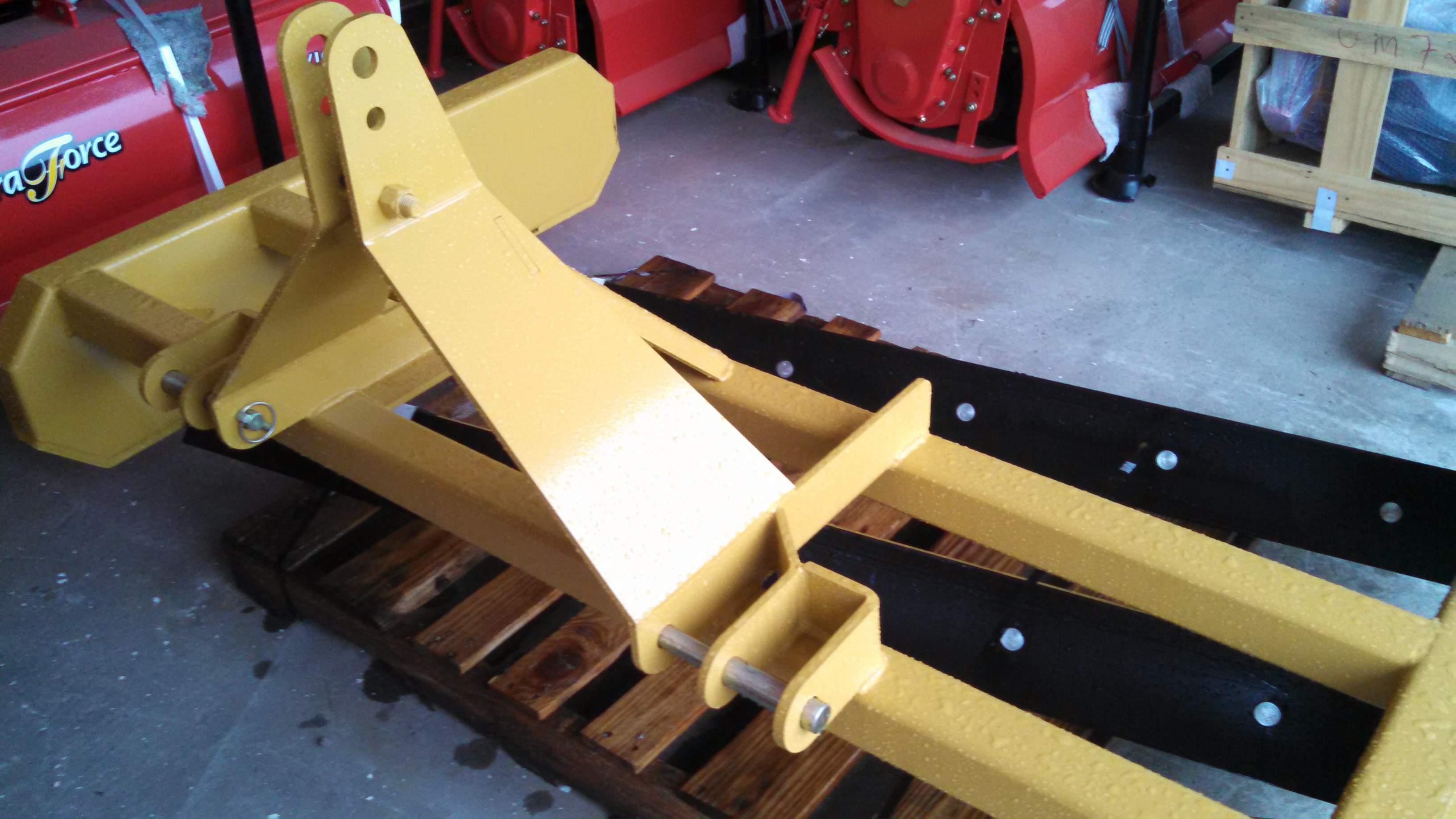

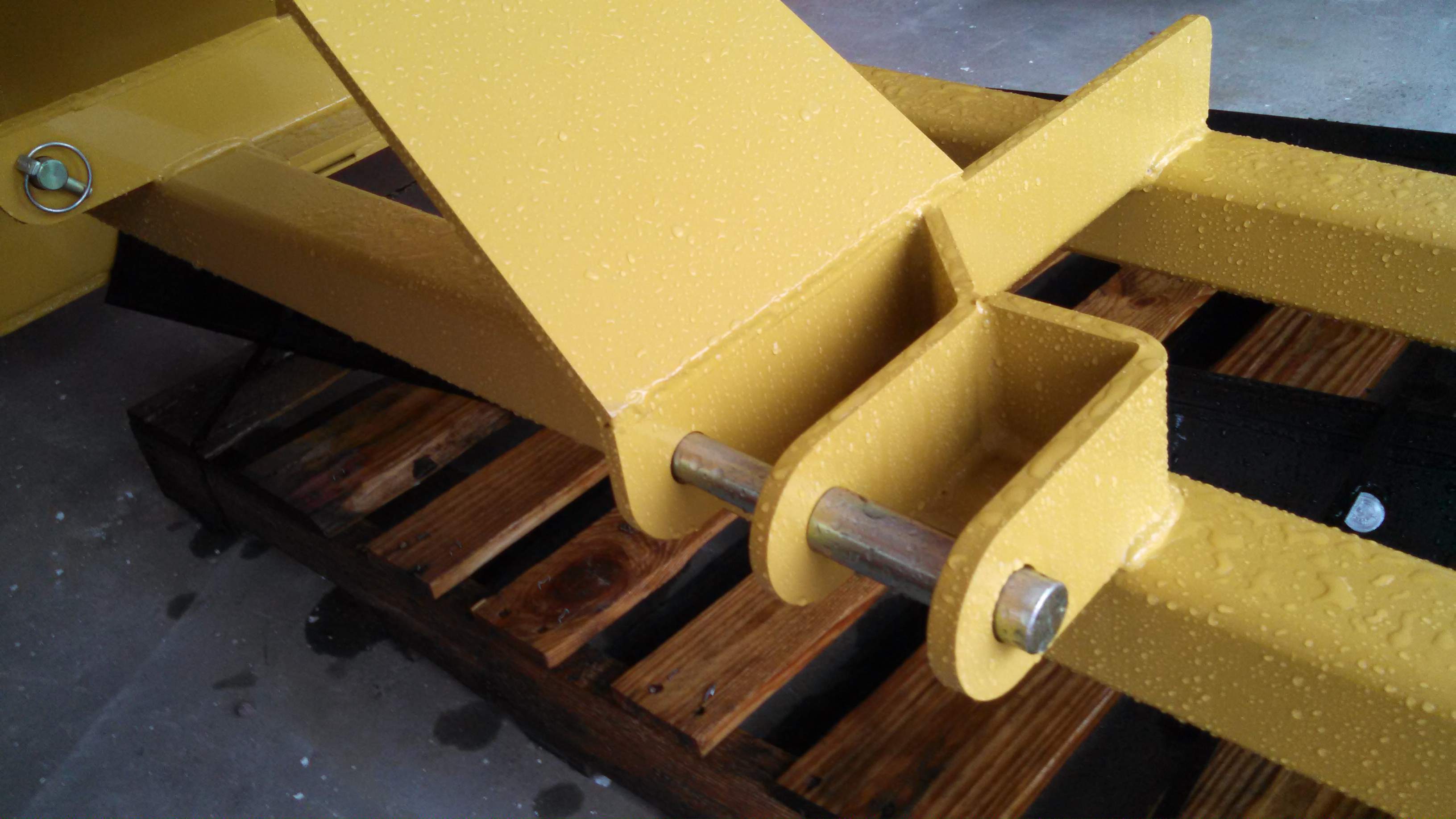

Laser cut steel with rounded edges. Tabbed assembly points for extra durability and uniformity when welding it together. US Made reversible cutting edges. Category 1 and 2 step pins on the clevis hitch.
A trip to the wash booth prior to electrostatic painting cleanses and etches the metal.
Rainy day cell phone pics:

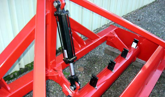

I agree. I prefer the reversible cutting edges too. What I would like to see on a landplane are hydraulic rippers like this. Even a handle operated system would be great.
I'd also like to eliminate the bottom skids and have thick replaceable wear bars on the side. It would require more operator input, but make a cleaner "cut" on the edge of the gravel. IMHO... The skids are a crutch.
