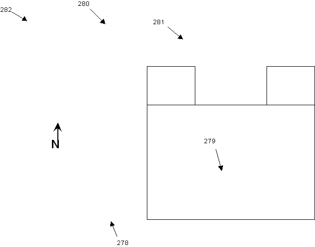

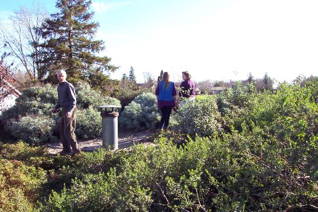

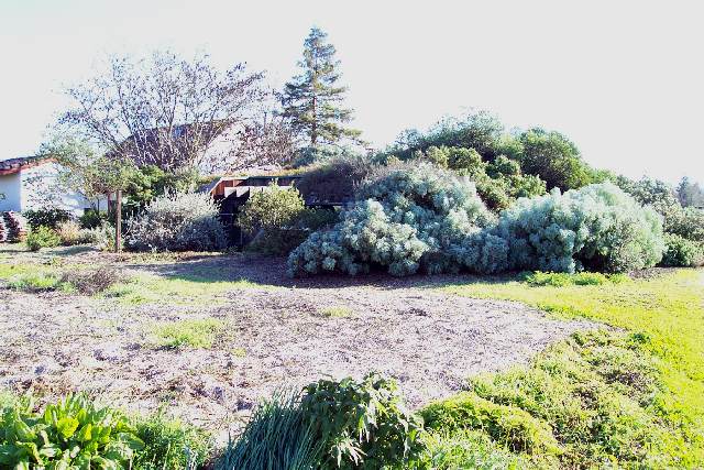

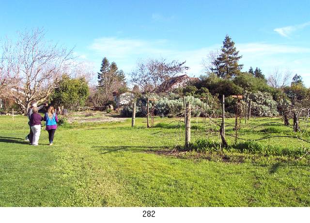

OK. As I promised, here's the pix of the first place we looked at. I did not do justice to this house, as I didn't get any photos of the south side or the inside. The main reason we saw this was that it was designed and built by the owner/architect, and we were interviewing him to do our new place.
The house itself is quite small; only 1025 square feet. The structure is entirely made out of wood, and was built in 1979. The owner raised 3 kids in this little place. The small size was an exercise in efficiency.
All the wood is PWF (Permanent Wood Foundation). The walls are on 12" centers, as is the roof, so it's relatively stout compared to conventional construction. The whole place is sealed with a membrane of hypalon-impregnated fabric. It has never leaked. Because it's in Davis CA, there is only 11" of soil on the top, yet this is more than enough for the mild climate in which it's located. Also note that the structure was built on flat land, and the earth was piled up the sides (and over the top). Amazingly, this home is in the middle of a planned community (of more conventional homes), near UC Davis.
This first attachment is a diagram that shows the basic layout of the building, plus numbers indicating where each photo was taken (notice dummy me didn't get enough pix to show you the whole thing /w3tcompact/icons/crazy.gif). Download this, or load it into another window to use as a guide to help you "visualize" how the place actually looks.

Pic number 279. This was taken standing on the roof looking southeast.

Pic number 280. This was taken about 50 feet northwest of the structure. It's that mound with shrubs on it. You can see the pergola sticking out of the north wall, as well as the edge of the structure on the one side.

Pic number 281. This was taken from almost the same spot as 280, except zoomed in a bit. It gives the impression of being taken a little closer to the structure.
