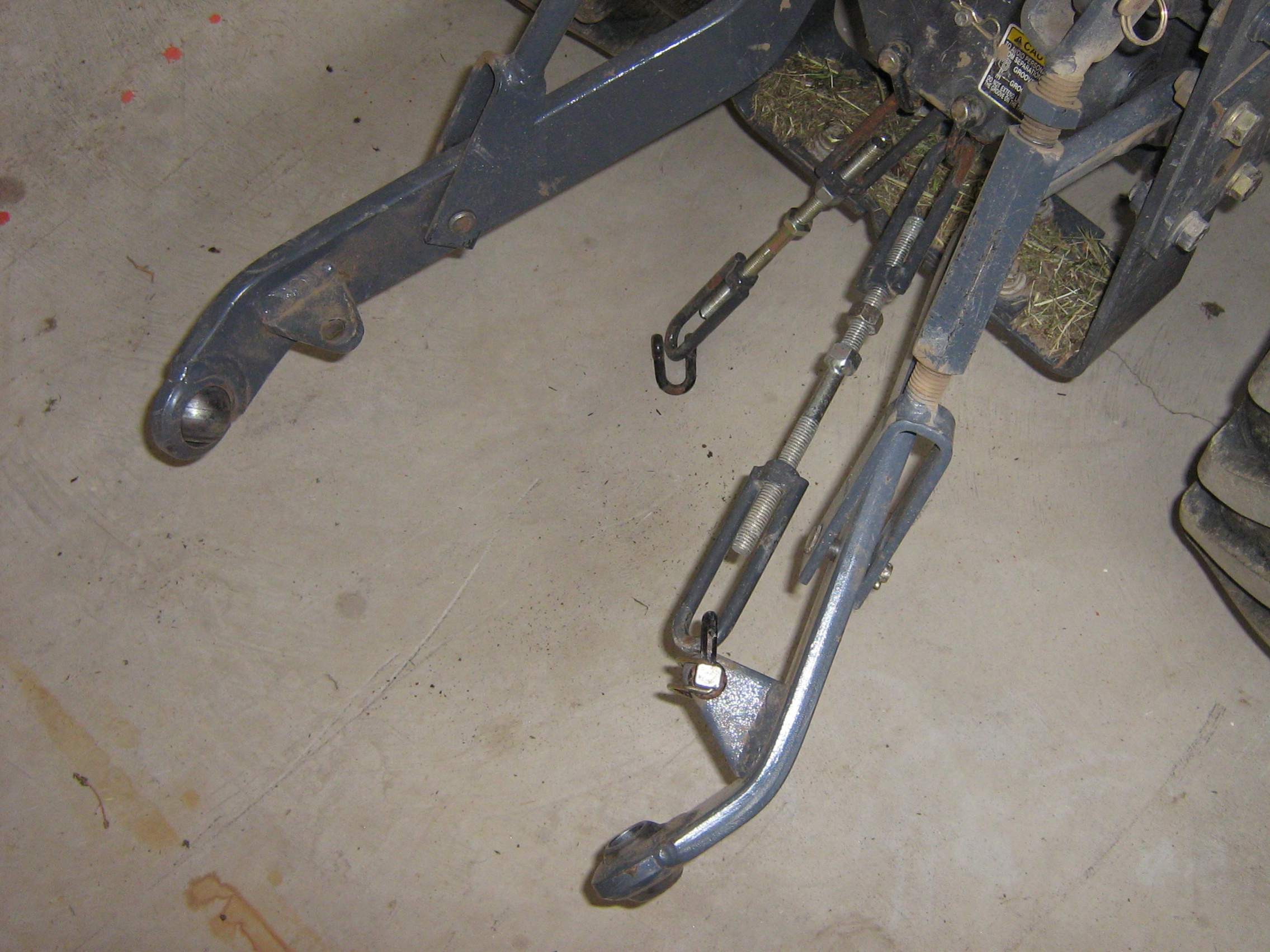

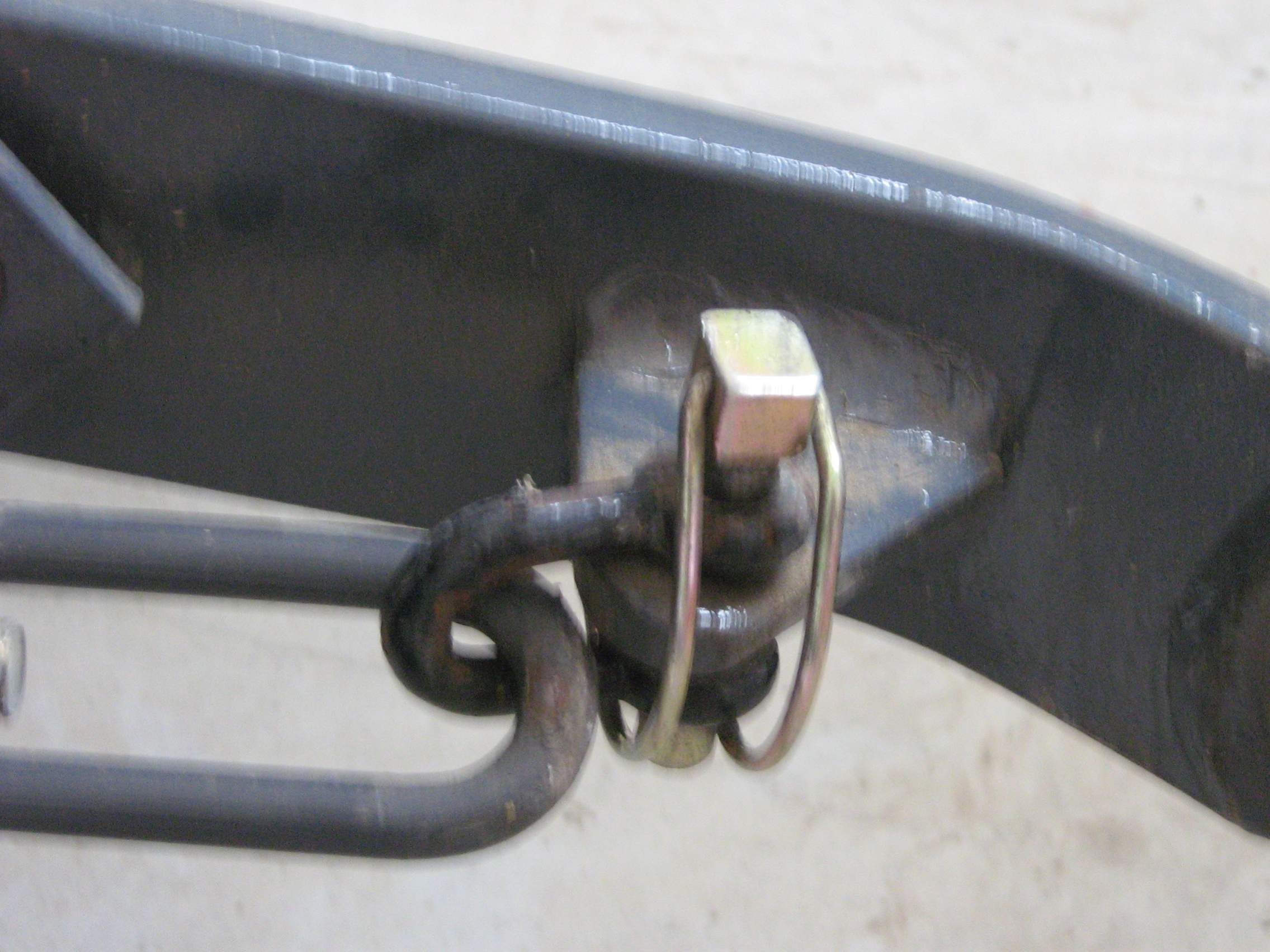

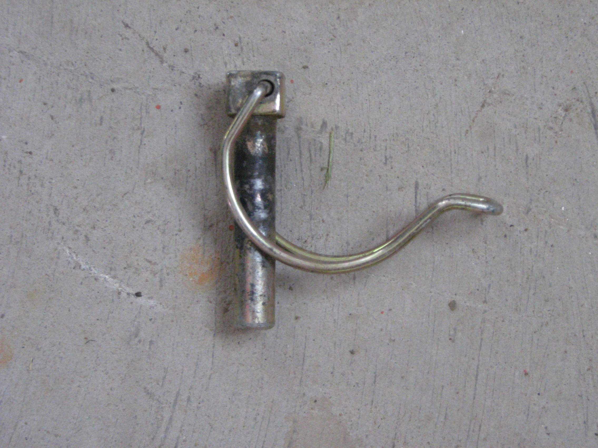

Thought I'd share an idea that has worked well for me. The most time-consuming step when I changed implements was loosening and retightening the turnbuckles on the 3 point hitch. Replacing the pin in the clevis at the end of the turnbuckle with a snap ring allowed me to quicklly pop them out and spread the arms to attach a different implement. Some fine adjustment of the turnbuckle is still required, but much less than the tedious fully opening and closing. There are linch pins/snap rings designed to work with tubes that have a semi-circular ring that will close around the clevis. I think they were 3/8" but not sure. I got two for less than $2. A little WD40 helps keep the pin moving freely. Hope this is helpful to someone else.

I have Pat's and it's a great Quick attach. What fullbucket shows that he uses has nothing to do with quick attach hook ups like Pat's. His suggestion is concerning adjusting the turnbuckles easier. Great contribution fullbucket.

A close reading of the OP states that the modification is for attaching different implement. Thus the comment about Pat's. However, less than $2 is much more economical than $200, if that is a concern.
His turnbuckle comment was that it requires a slight adjustment since apparently he wants the lower arms tight without any swing. I like a bit of looseness in case something solid is unintentionally struck with the attachment.

My tractor doesn't have the chains, as it uses blocks on the side of the pto housing to prevent sway. That allows me to move both arms "out", but if attached to an implement, the pair prevent it from swaying. Even easier than a snap ring on a clevis1

Why didn't I think of replacing those darn pins myself? I too would remove the pin, but I stuck with the factory clevis and spring cotter pin. Therefore, I just had an extra part to drop while holding them in my mitt. I actually lost a spring cotter pin or two in the process.

I did the same thing on my B7100. Worked great! The turnbuckles on my B7610 don't have a pin, so I bought the B2710/B2910 style telescoping stabilizers (still haven't had a chance to install them -- maybe this weekend).

I've been doing this trick for a little while now.
One thing to be careful of:
If you're maneuvering the tractor with the check chains detached and dangling, be careful when backing. If they're set long enough, they can dig into the ground and become wedged. I've bent one and I'm pretty sure i did it while backing with the check chain dragging on a concrete floor.
