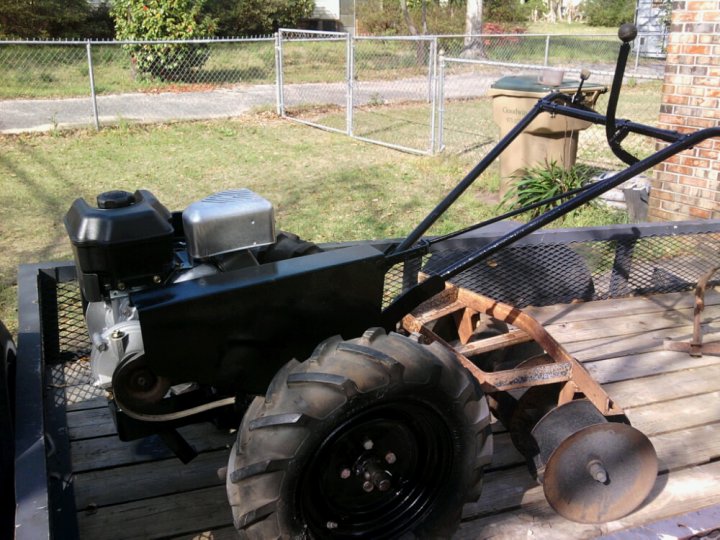

When we bought our house, which was my grandfather's, in the shed there was this Edko walking tractor. The motor would not crank.
I was wondering if it would be worth putting a new motor on it and cleaning and painting it. I have the old motor but I think it would be a waste to rebuild it. It had a 5 h.p., 6:1 reduction motor on it.
I have a small disc and another attachment. The attachments pin to the frame. I also would like to know if it would be able to pull a little cart and seat with me on the seat. I weigh about 260 and am 6' 4" tall. If not no big deal. I like old equipment like this.
I searched for the manufacturer and came up with nothing. Any information would be greatly appreciated. I wil post a few pictures. I think it would be neat to have this running again.

I think the two pins are for holding the cultivator attachment straight when 'transporting', but when cultivationg (ground engaged) they are removed to allow some steering ability, to keep on a straight line.
If me, I'd rework the old engine and keep this as original as possible. It has more value as an antique than as a working tool (IMO). It appears to be similar to the Gravely walk-behinds.

Well finally getting around to working on this old thing. I am looking for a motor for it now. I have tore it down and will blast it and repaint it. Any idea where I could find a good motor at a decent price?

I take it that the old motor ain't fixable? Lots of places to get a new motor, Smallenginewarehouse.com, Tractor Supply Company, Northern Tool, Tulsa Engine Warehouse to name a few.

I have another thread going in the two wheel tractor forum with some new pics. I got a new Briggs 5hp from tractor supply for 280.00 shipped to my door. I also sand blasted and painted. I hope to get it together this week sometime.
It does not have a pto. It only tows the implements,
   / Edko Walking Tractor
#13
I got it together today.

Sure looks good with that new engine powering the old girl!
