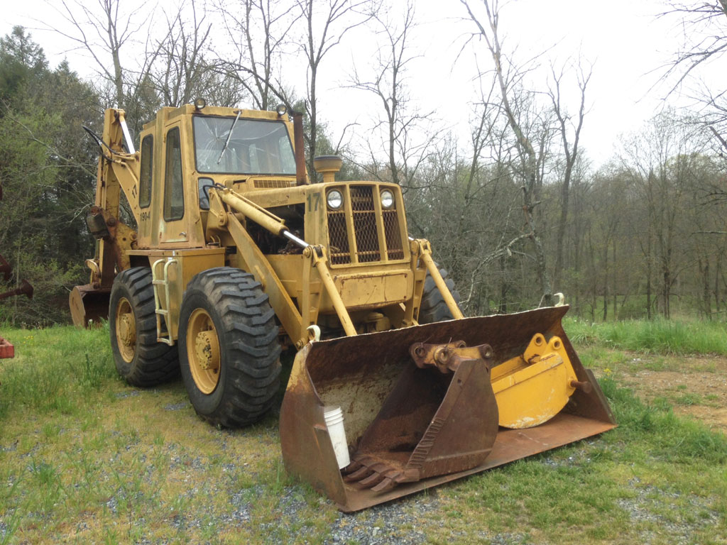

Before we put the drums back on, we put a chain around each brake shoe, and bled the brakes. This way we would know if the wheel cylinders were leaking, and take care of it first. They bled good. So we will have brakes now, woohoo! :drink: but first we killed three hours trying to figure out why we did not have anything happening up front, we were not getting air to the front power cluster. Last time we worked on the air component of the brakes, we had an air brake mechanic (mutual friend) helping us. He told us to tie the relay back in, me and my mechanic friend that usually helps me had bypassed it. Well the last thing we checked this time was the air, so it took three hours and five minutes to get something happening up front. Doh!! I think we would have got the brakes adjusted and the wheels back on otherwise, we will have to do it later now. It will not be long before the snow keeps me from working on it for a few months, I at least want to get the wheels back on and move it away from the standing dead trees before that happens.

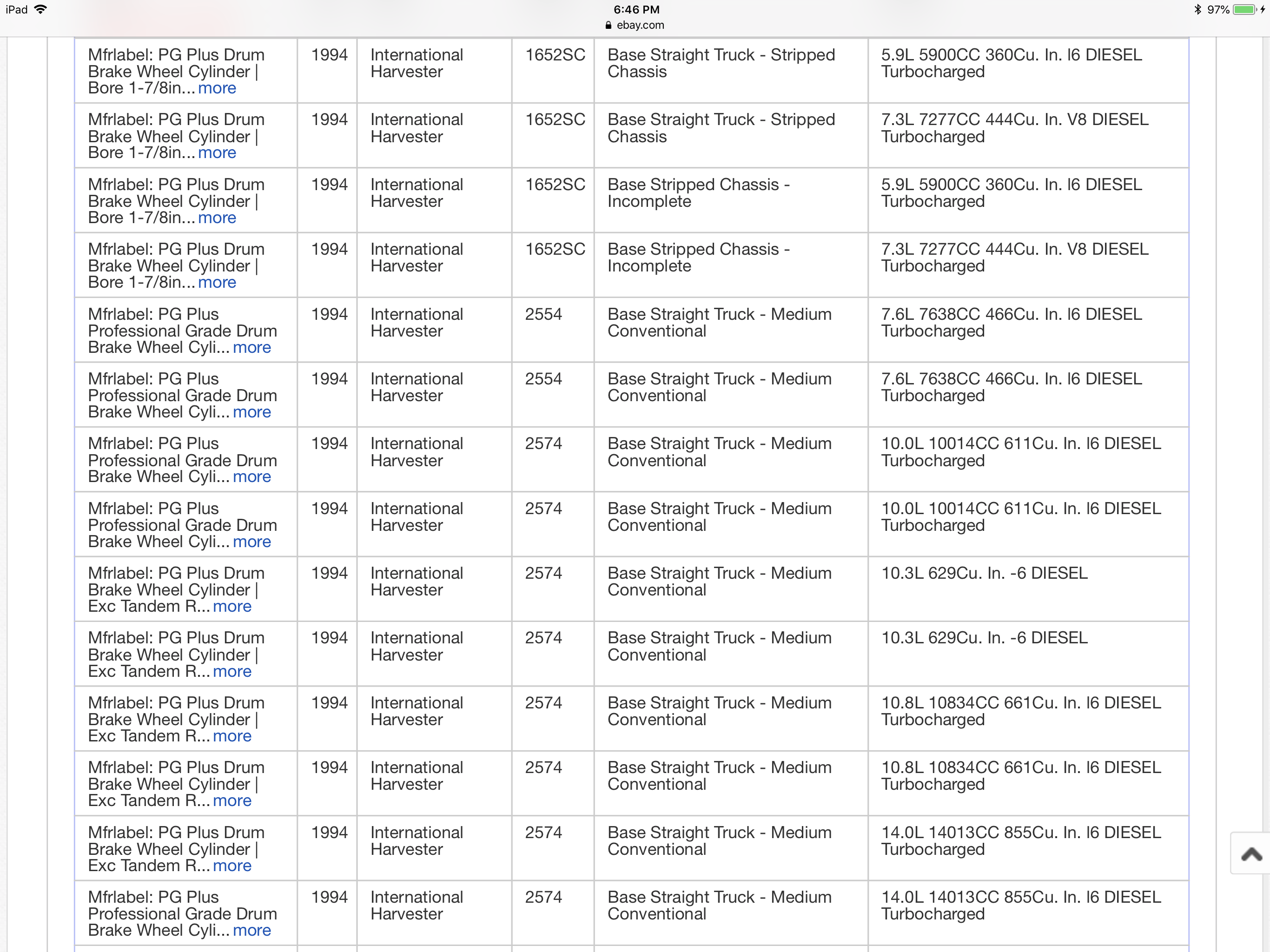

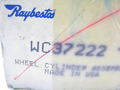

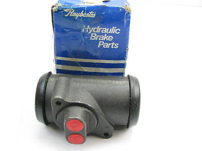

The wheel cylinders were also used on International trucks, so they are still readily available.
