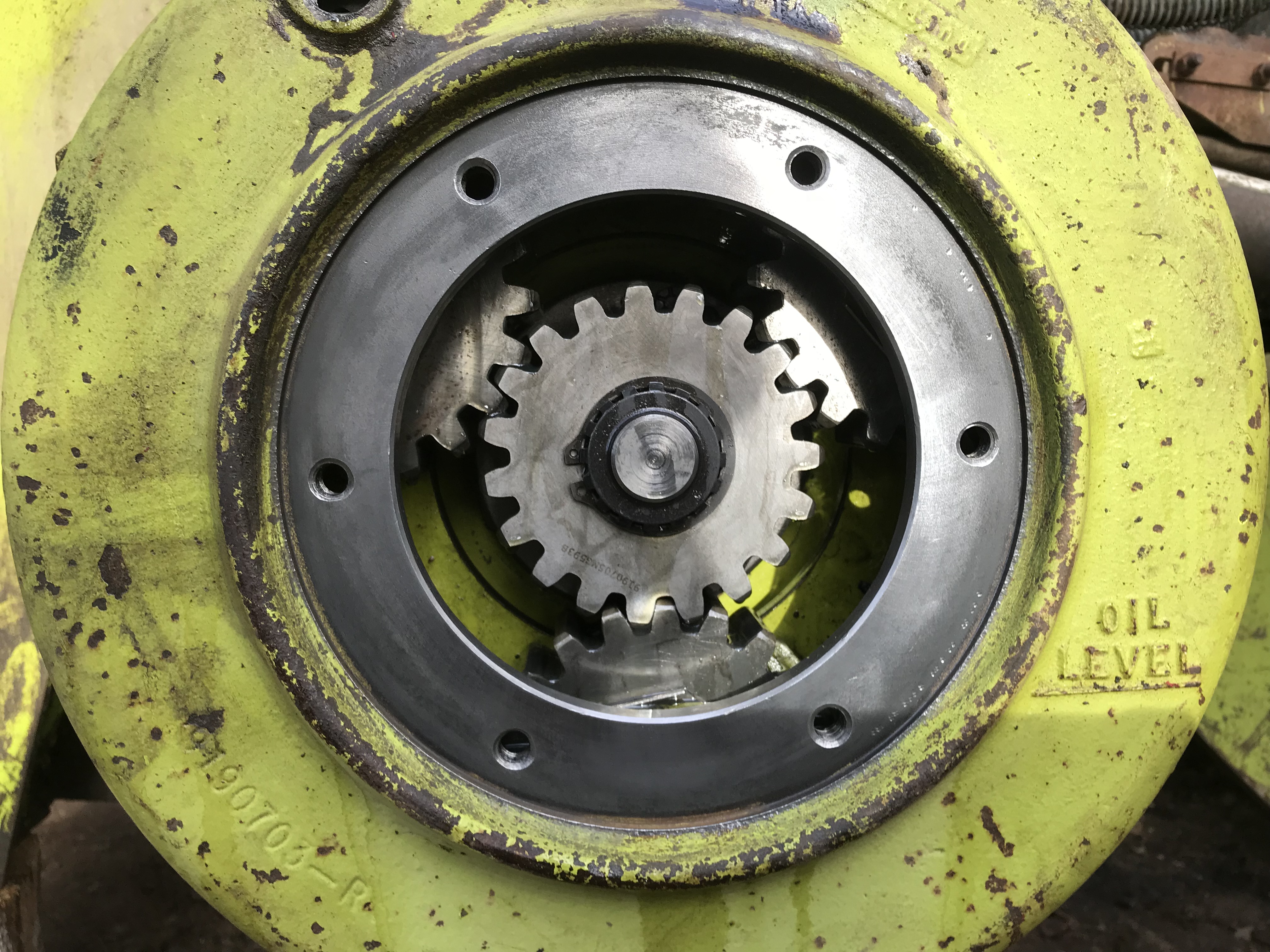

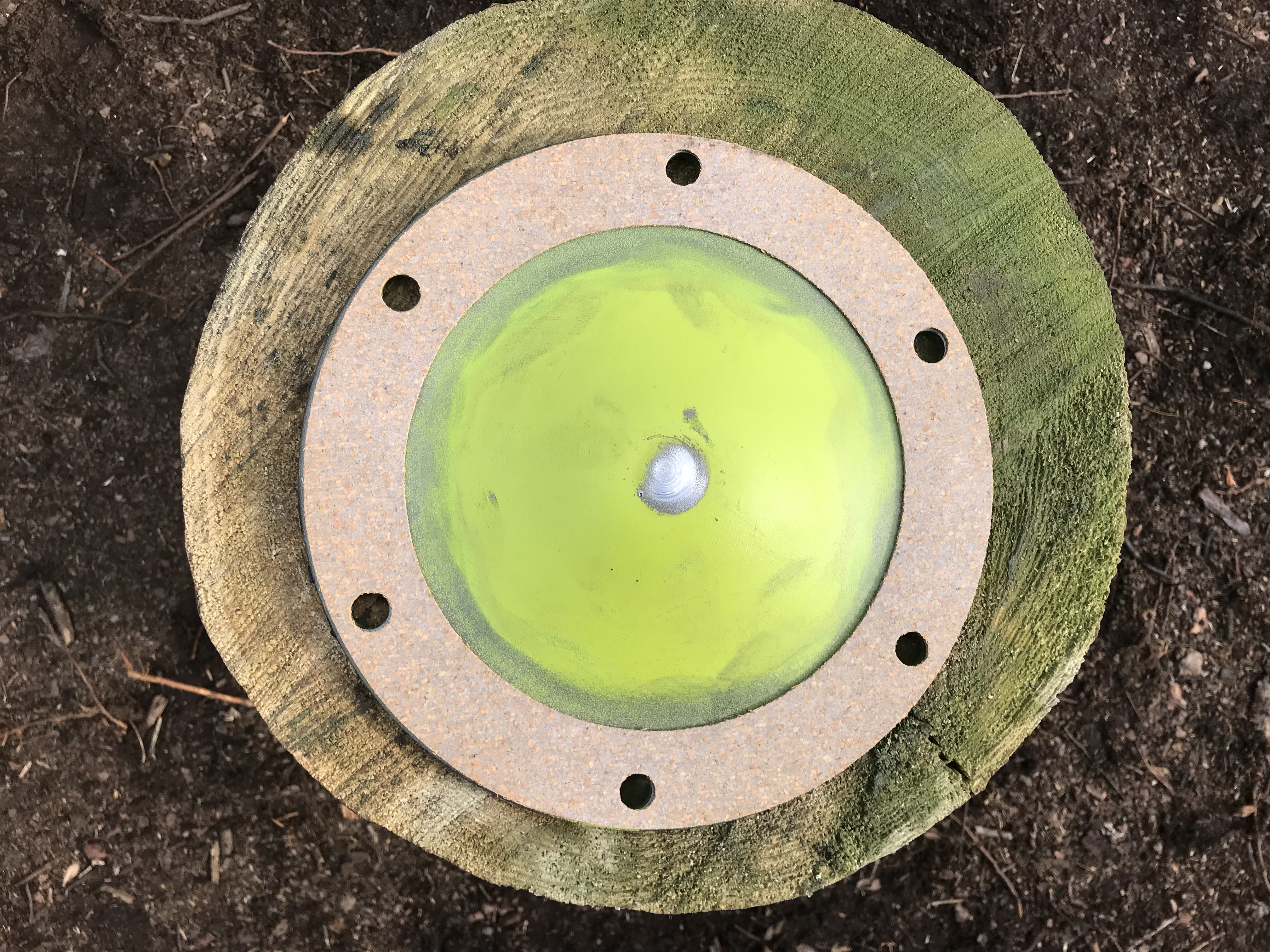

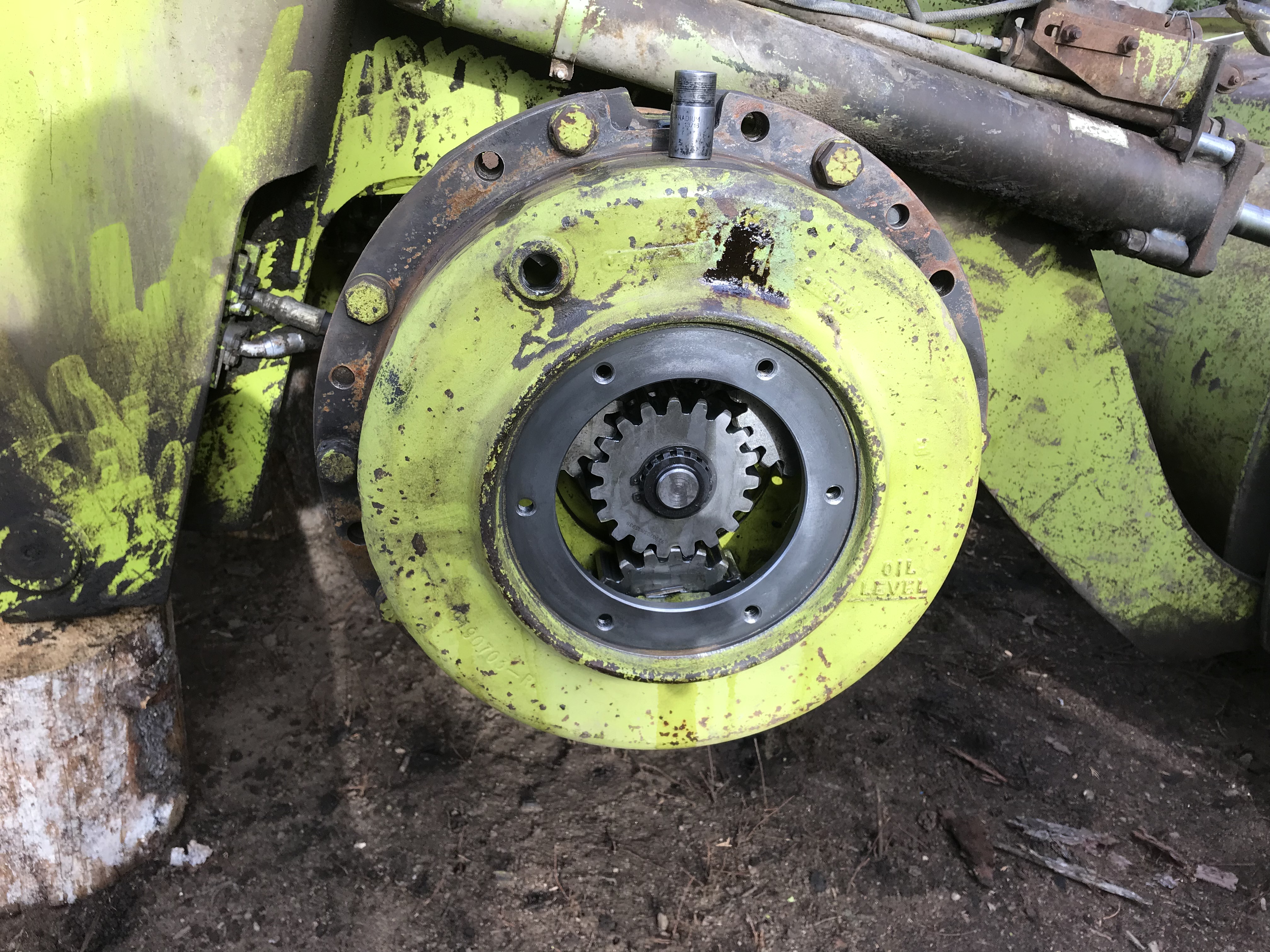

This is what I was doing today. When we put it together last week we did not have the gaskets yet, so we just used silicone. It is outdoors and rain was coming, so we needed to button it up. I also added the gear oil today.
Started putting the oil back into the transmission, and noticed it was coming out the bottom faster than before. Doh! I do not know what went wrong, I have done a lot of seals before without that problem.
Also adjusted the front brakes. Followed the manual, it said to adjust until they drag, then build air pressure and step on the brakes a few times. Then adjust again, and back off three clicks after they drag. All seems good.
I did not have time to do anything else. Next time I will put the wheels on, remove the transmission yoke, and try to figure out why it is leaking.

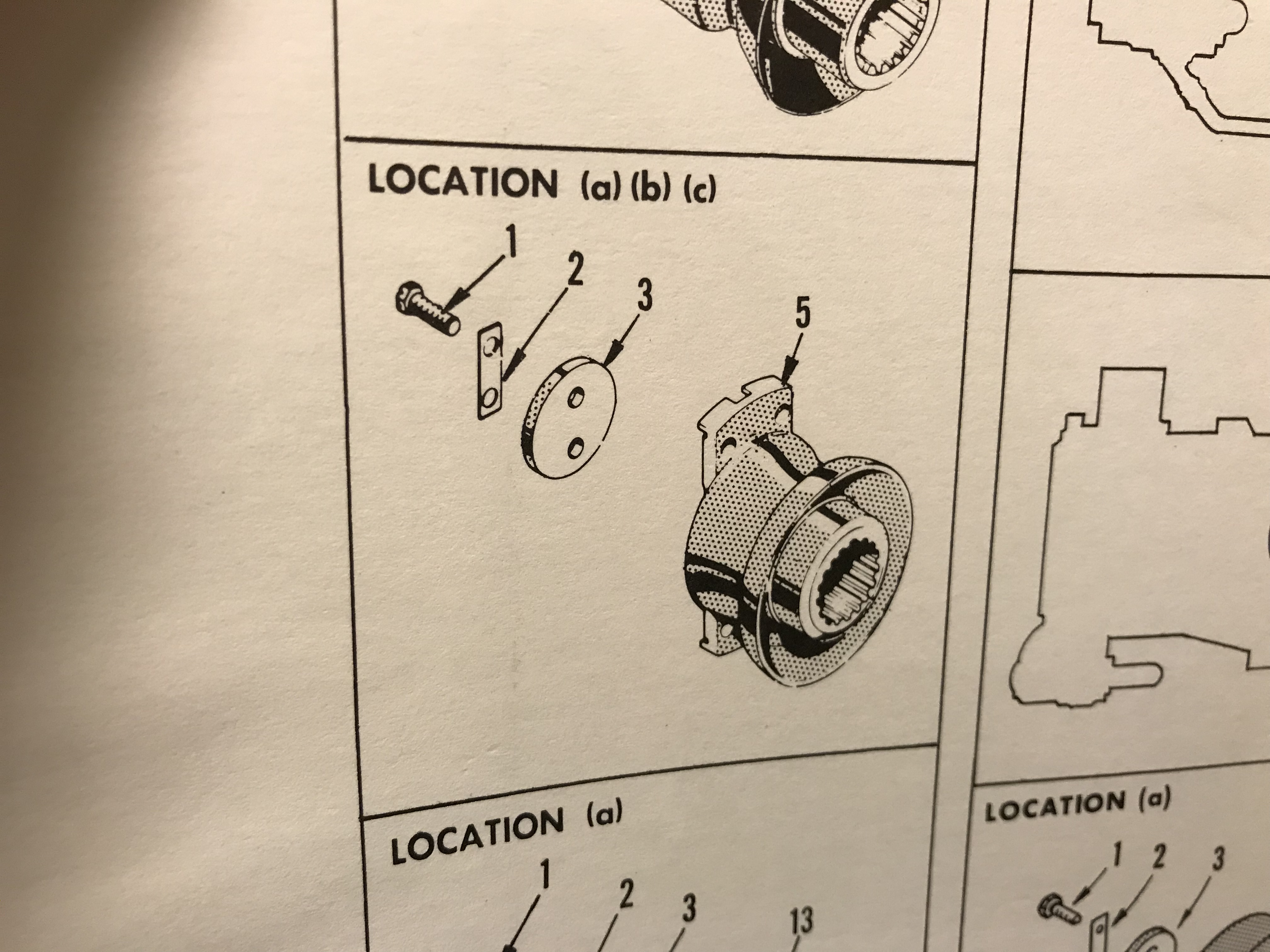

The transfer output is like this, it does not have a big nut on it. It is leaking past the seal though, not the splines. My mechanic friend thinks the spring may have popped off the back of the seal, I did not think of that possibility. He wants to take off the retainer the seal is installed into, and look at it from the back side.

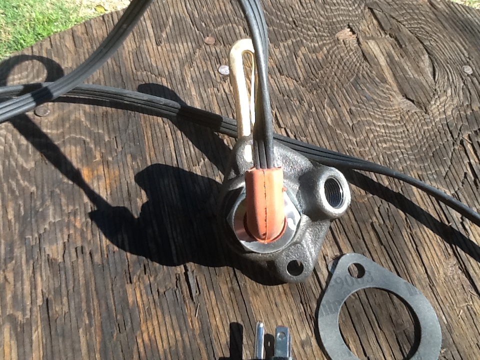

I gathered some parts over the winter, I was up Monday gathering more information.
This is a block heater
I still can not figure out where the block heater goes, I think what I got is for a later engine. The people selling these things are no help. Well almost no help, their product information says it replaces the water jacket plate on the side of the engine. They have two options, with and without water cooled compressor. Mine is water cooled. So I think if I follow the hose back from the compressor, it will go to where this thing installs at. It is just a pipe fitting though. I can not find anything with two bolts like this.
So I guess the question is, what/where is the water jacket plate?

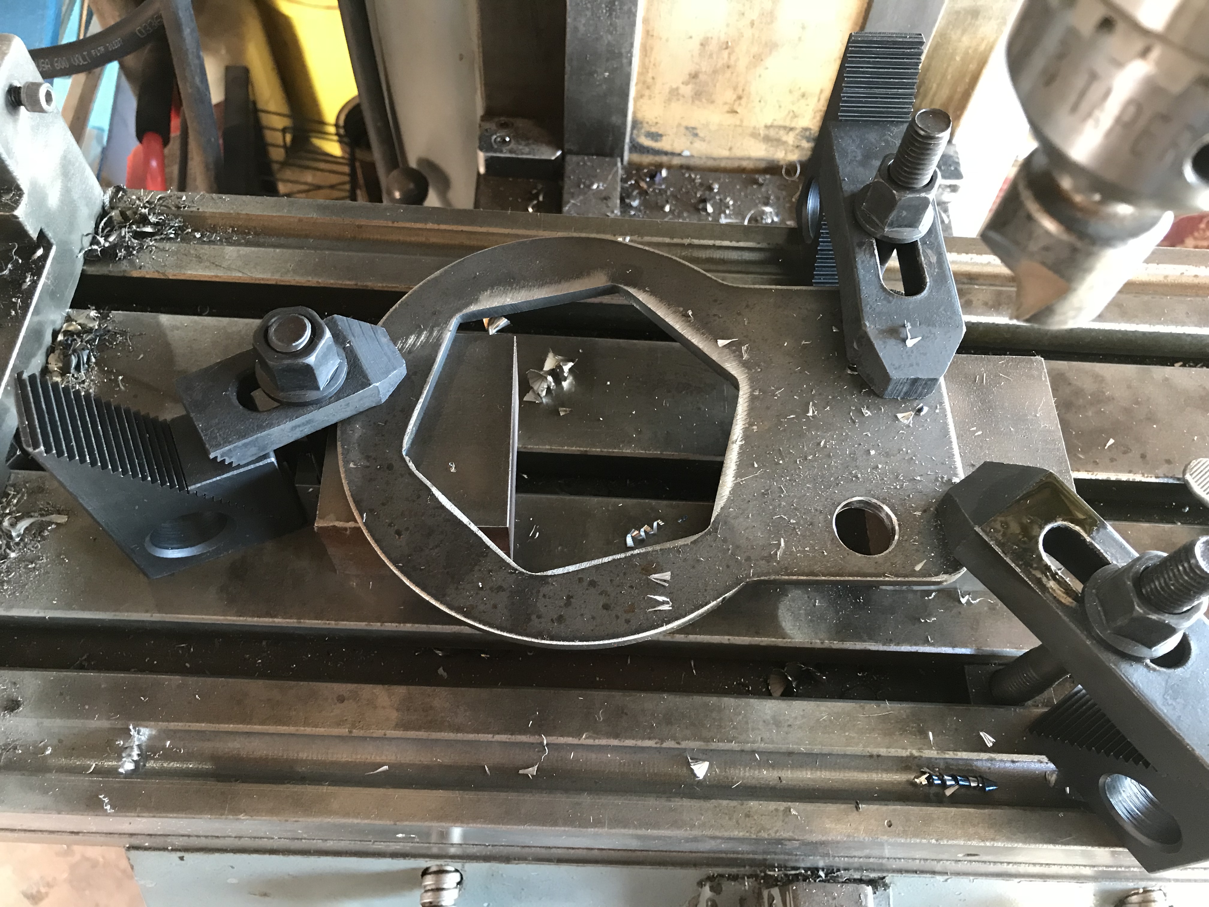

#160
Only drilled where it was transfer punched. I will install with one bolt, and transfer the other hole location. That will insure it will fit.
