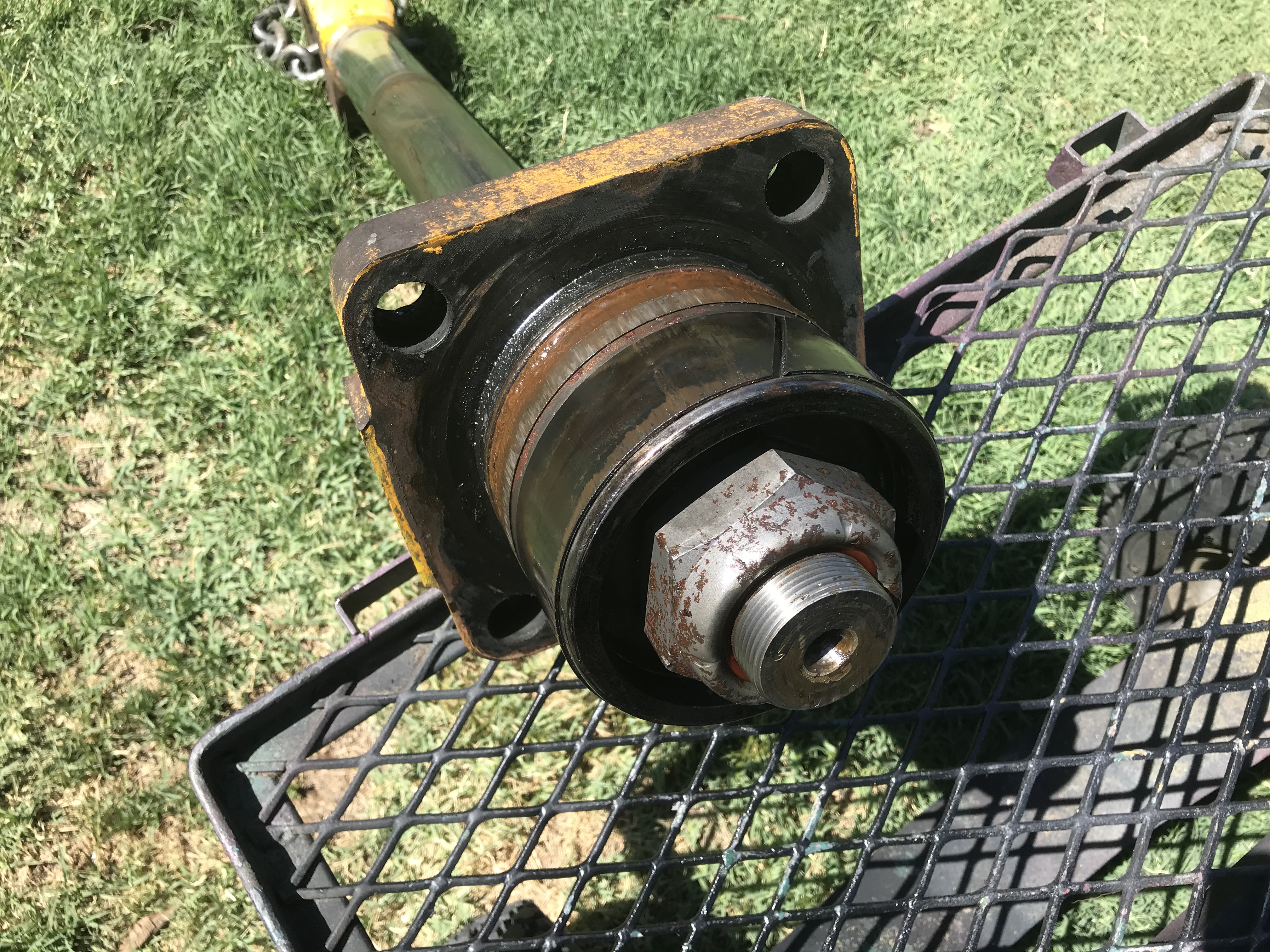

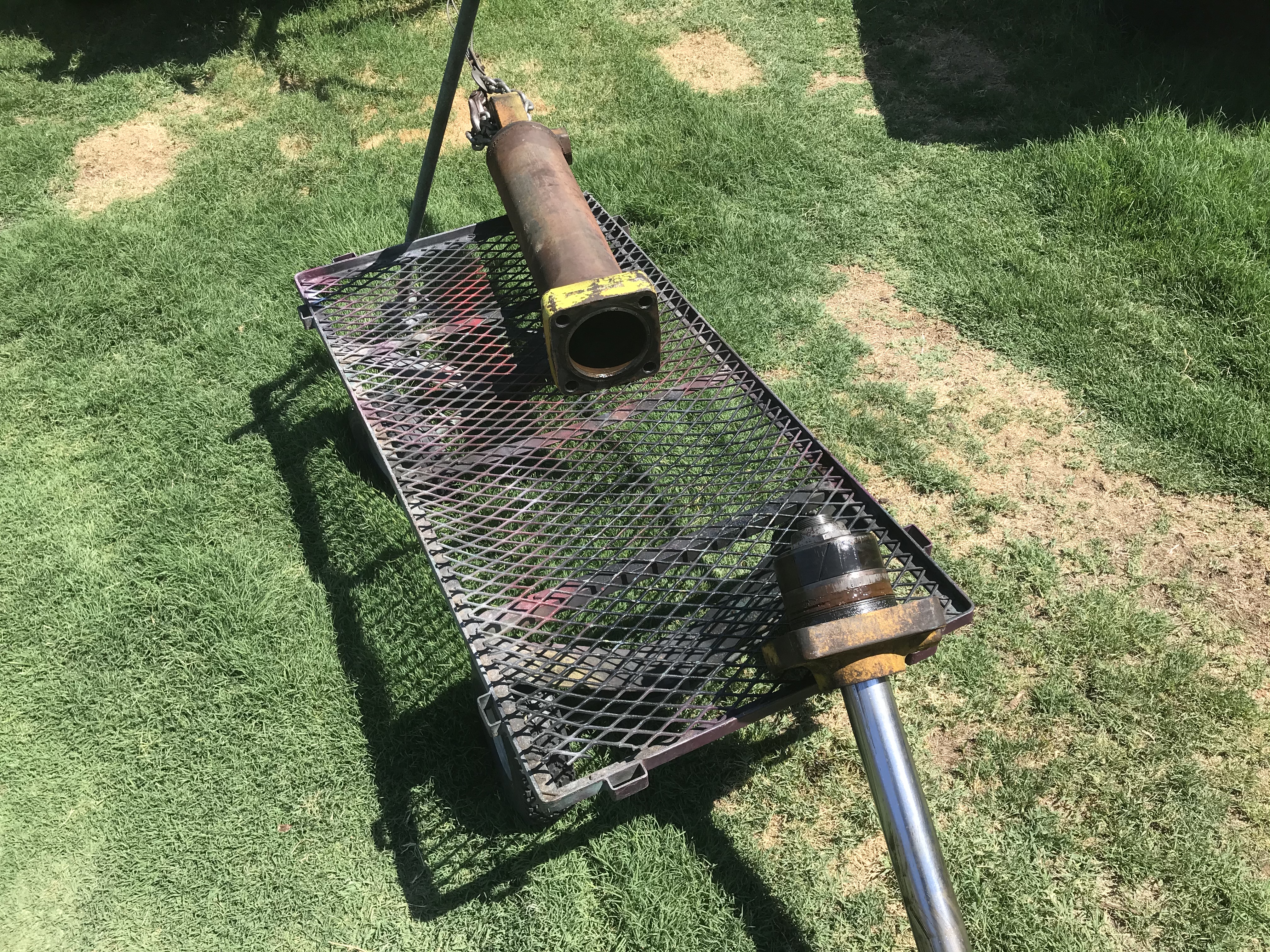

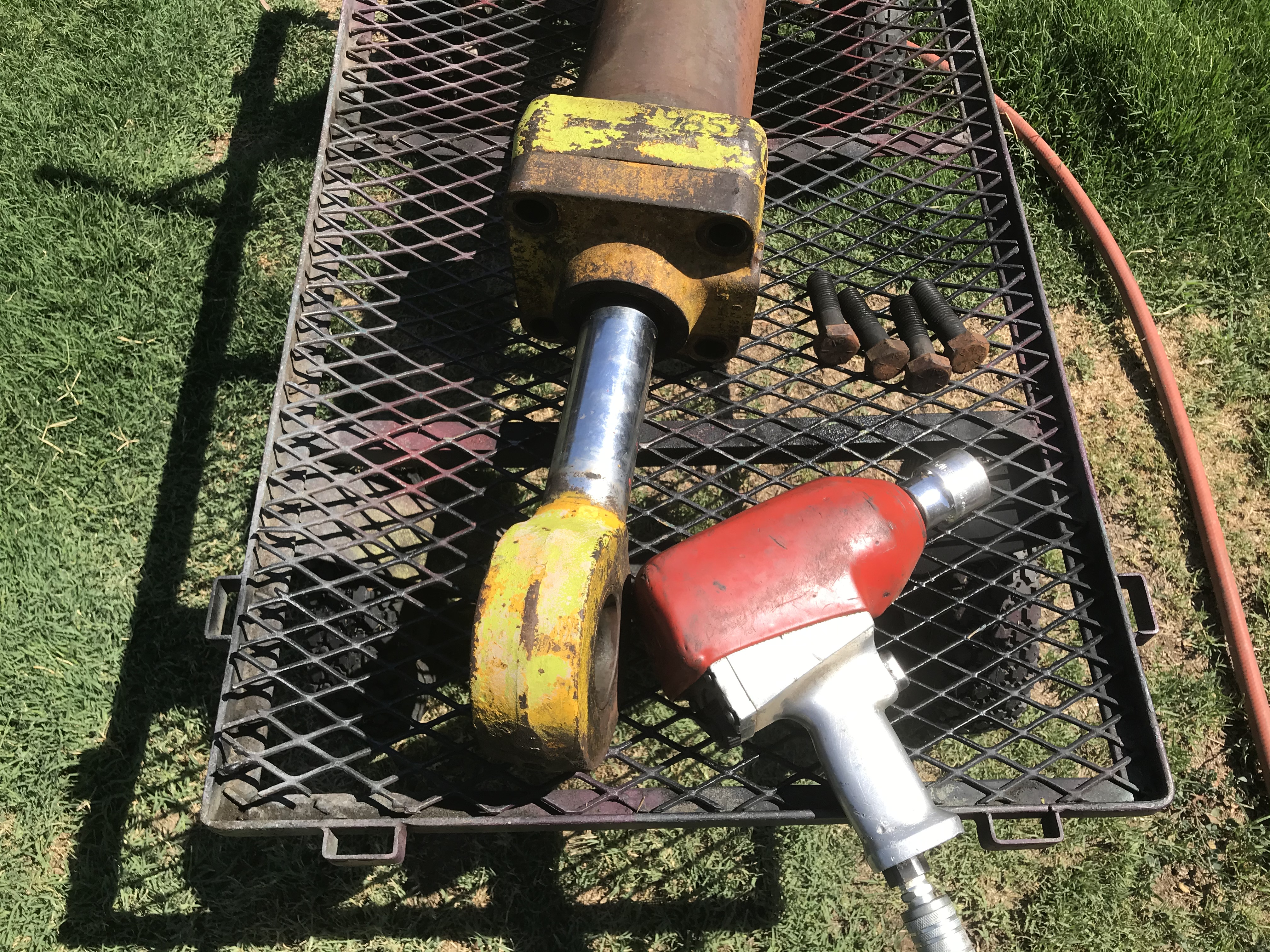

Got it apart.

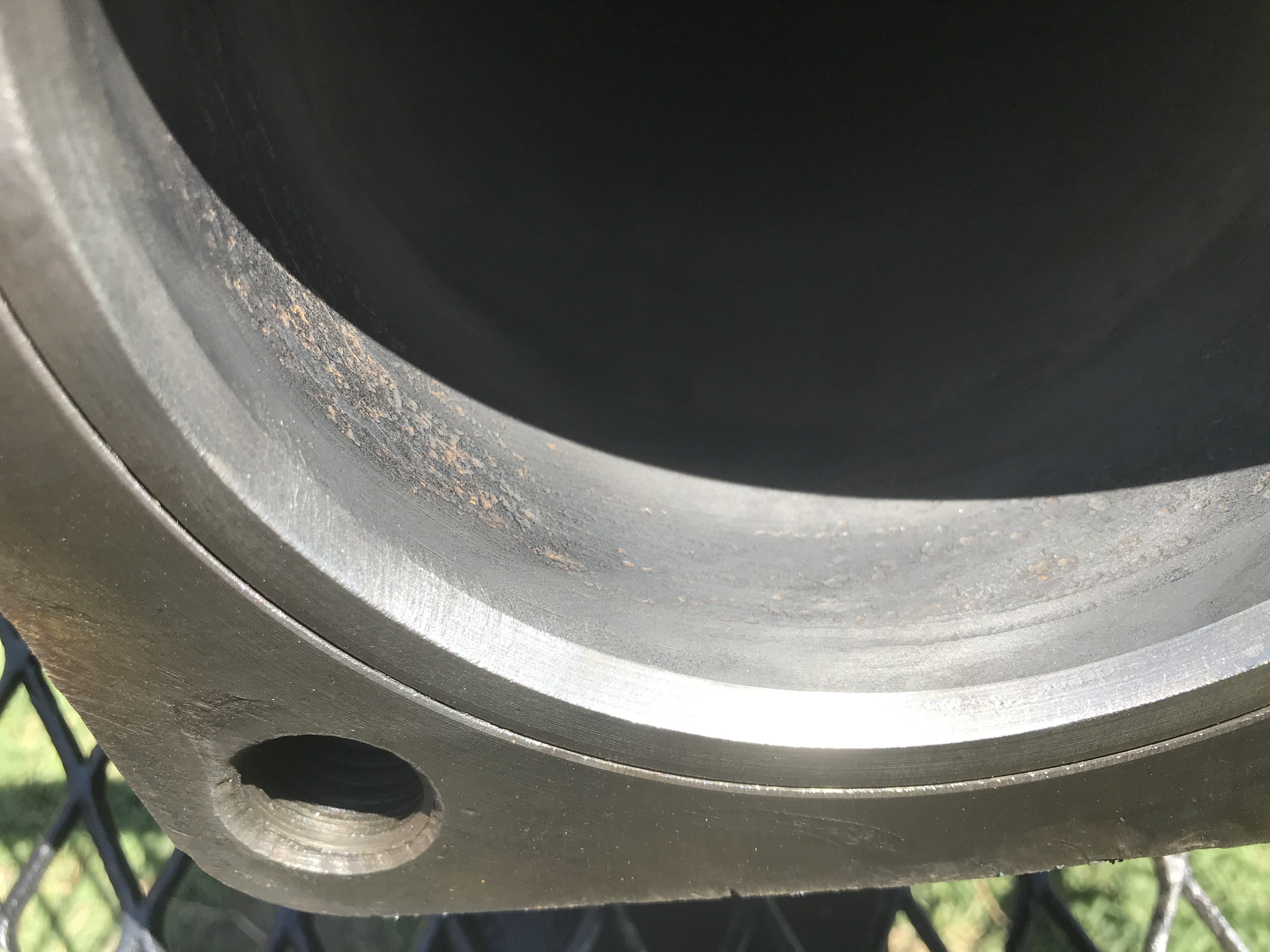

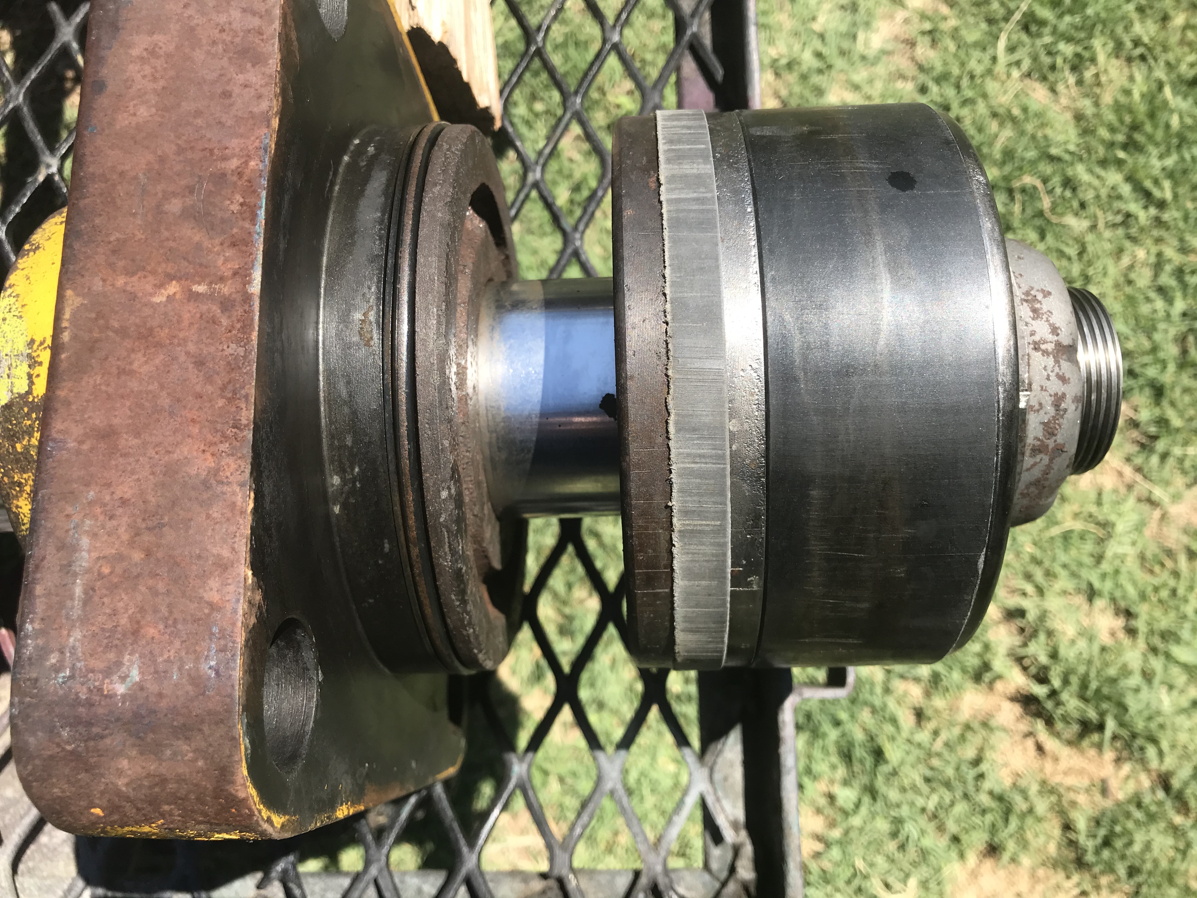

It has some rust. There was no fluid on top of the piston.

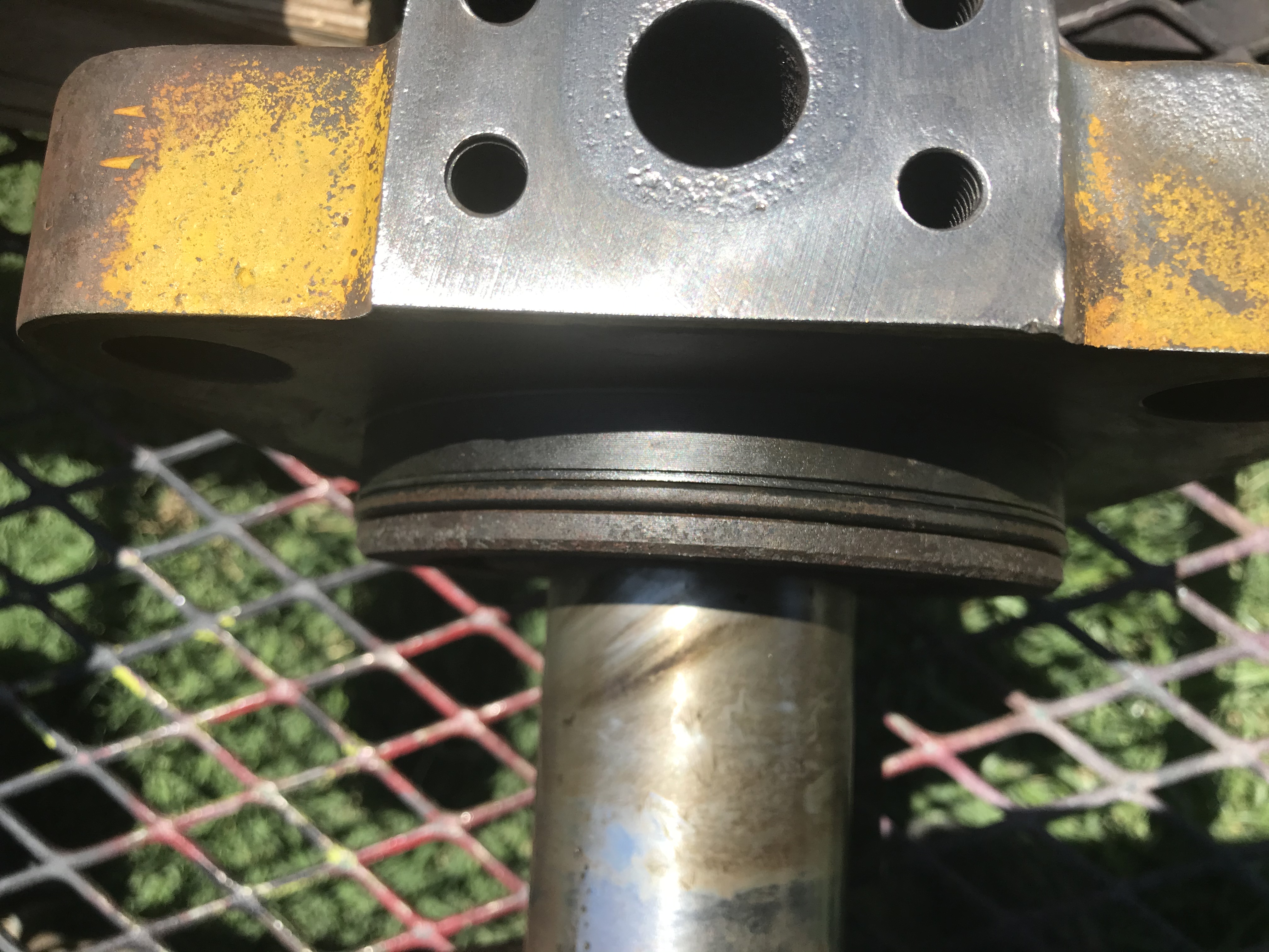

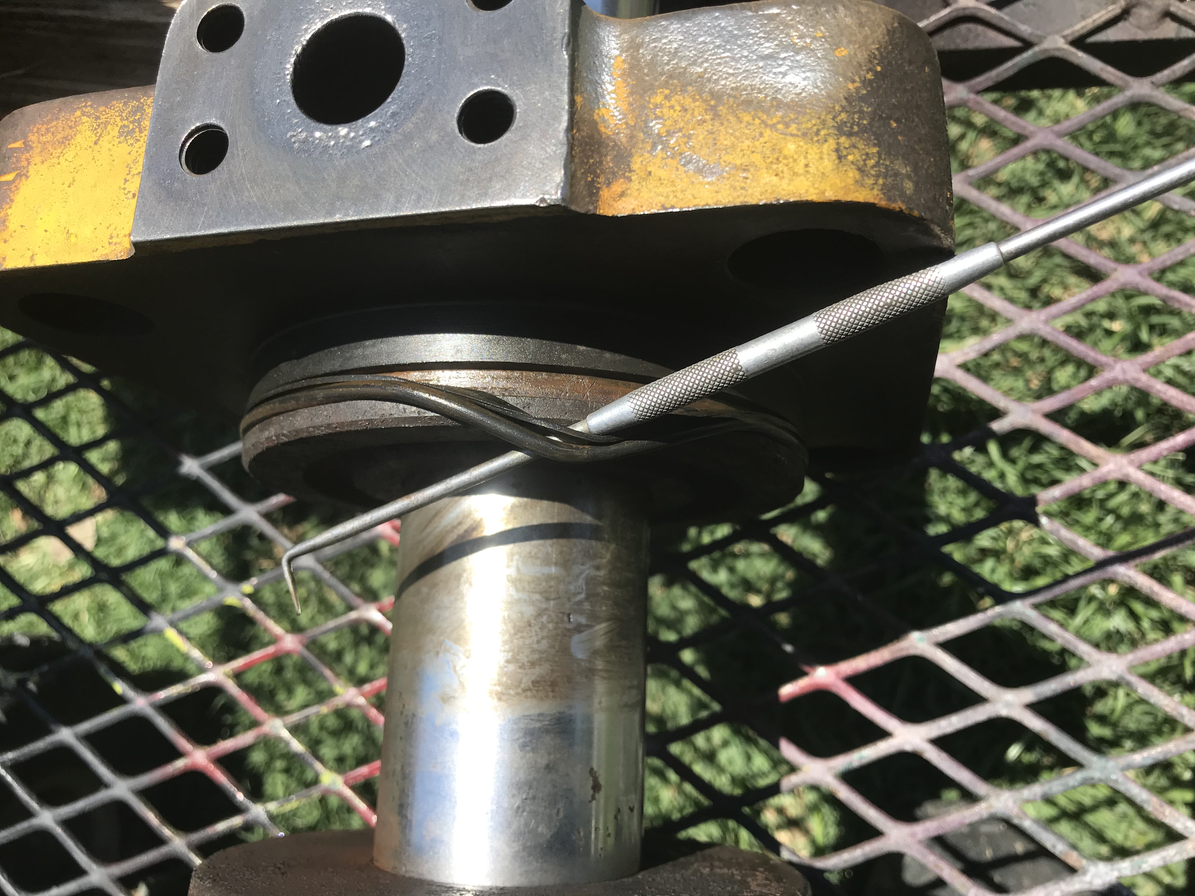

Hose connection seal area is pitted.

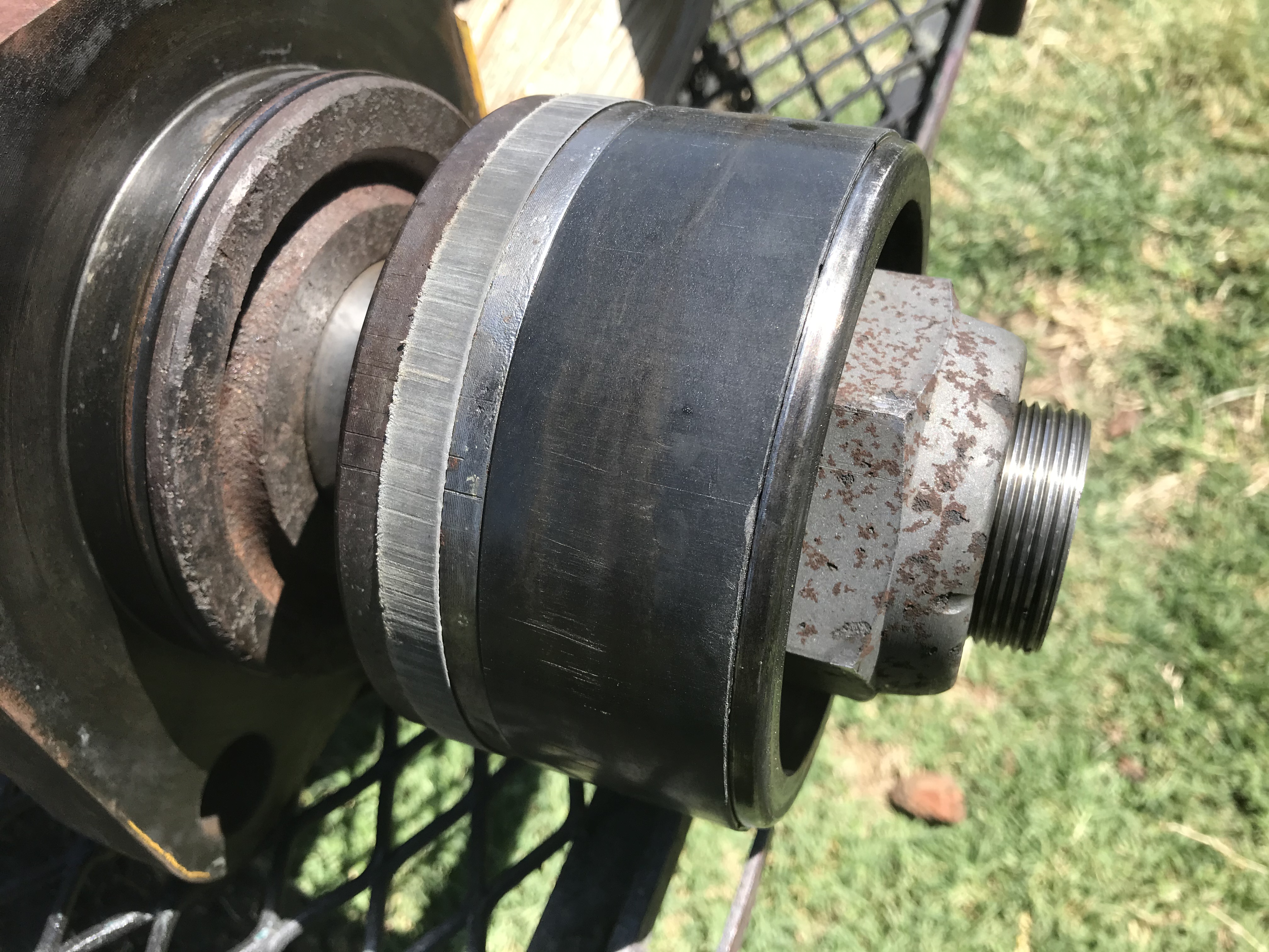

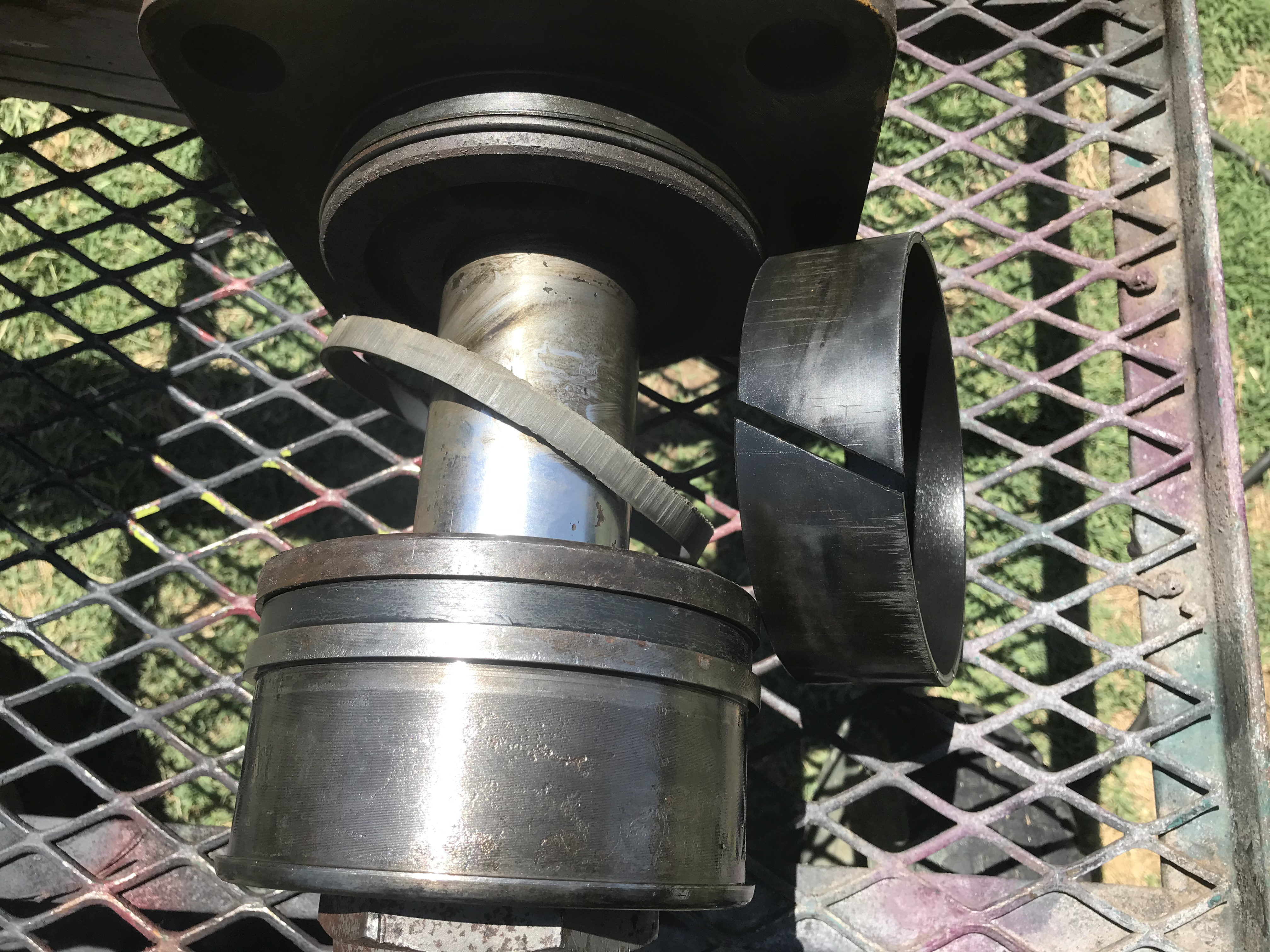

Barrel is pitted, but it is beyond the end seal area, and before the piston seal area.

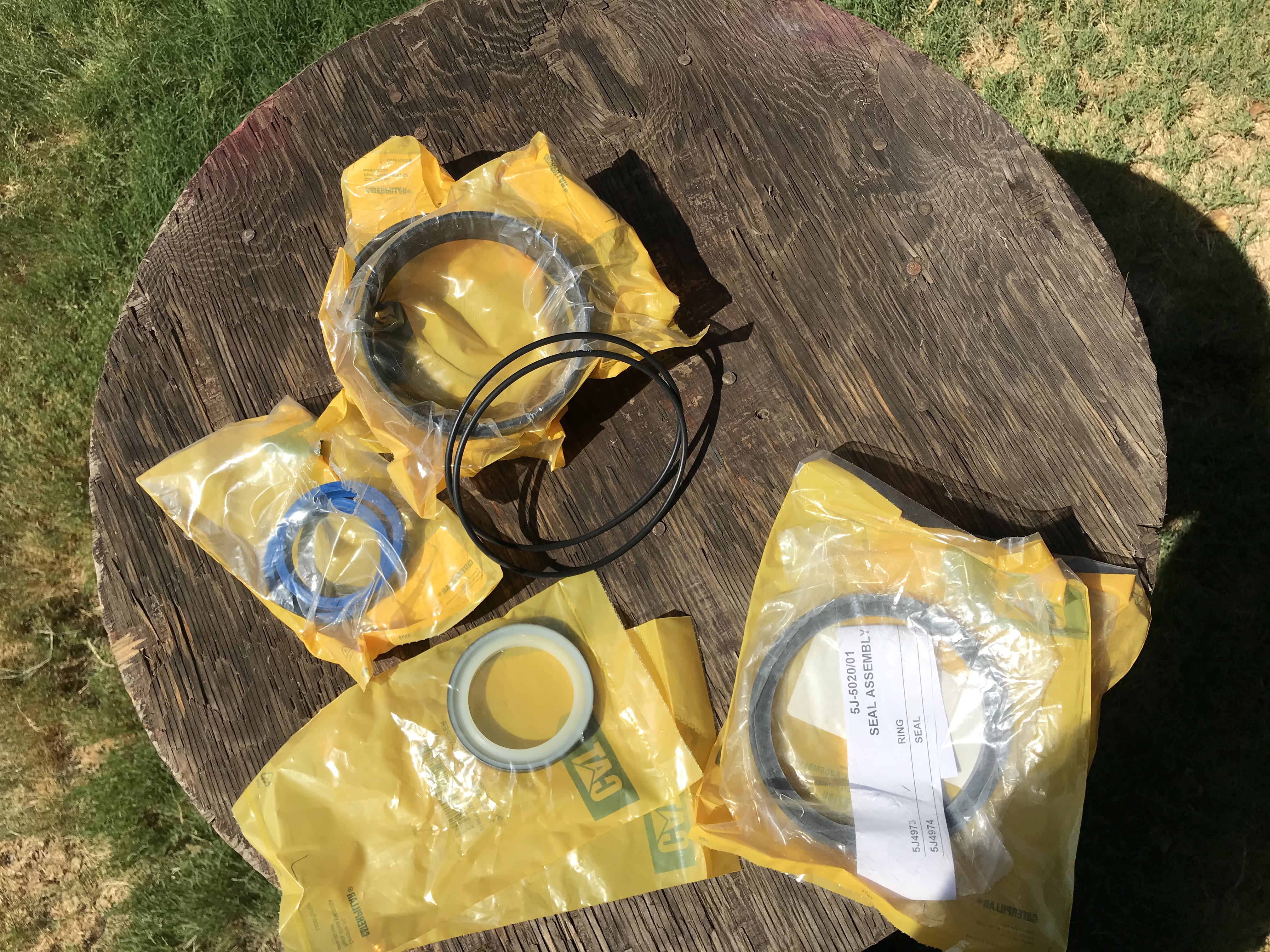

I got the parts from UPS. The backup rings are missing, even though they are on the packing list.

   / Ed's 77 Terex 72-41 Wheel Loader #419
Does the packing list show the backup rings as “backordered”?
