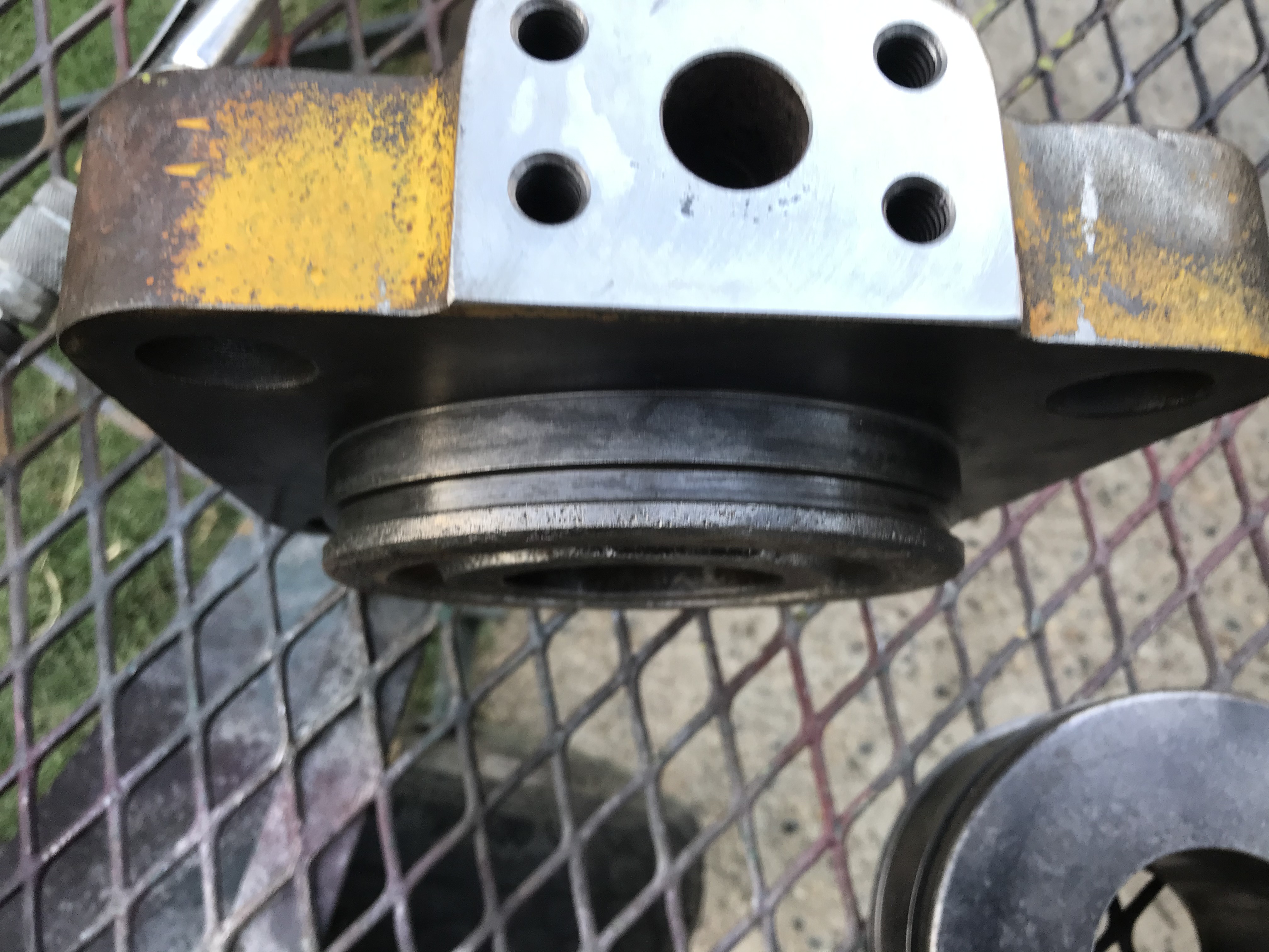

Got it back together.

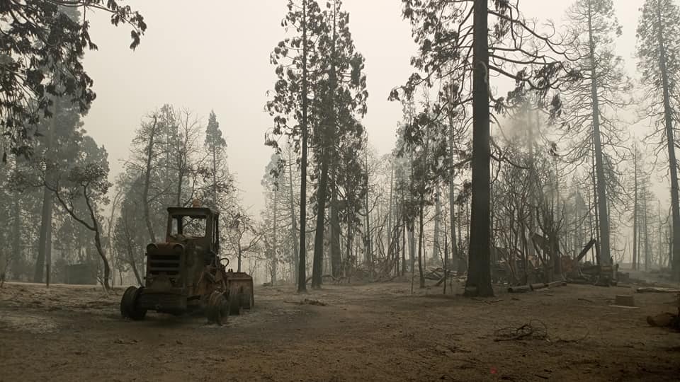

Might get back up to the loader in a few days, they are lifting the fire evacuation orders little by little. Still a few more zones before we can get to it.
This is one of the ways in, and the fire that did this was heading for our place. A fire break stopped it, a fire break that was intended to stop fire from going the other direction.
Creek Fire leaves road near Shaver Lake an apocalyptic landscape - YouTube
This is not my loader. It is a Case W7 that was along the way in shown in the video, it was operational. I do not know the guy, but I remember seeing it.
