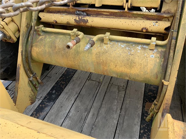

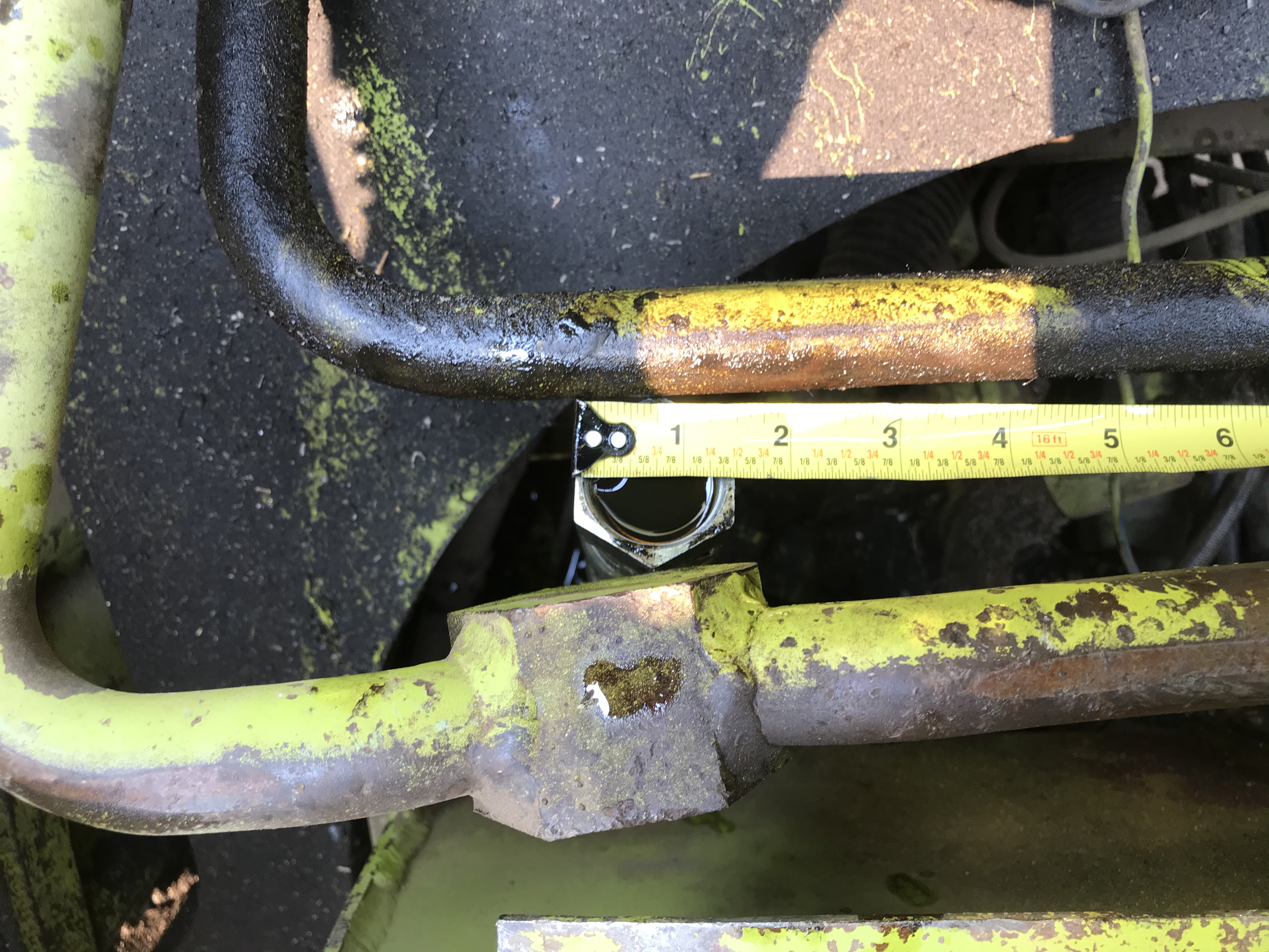

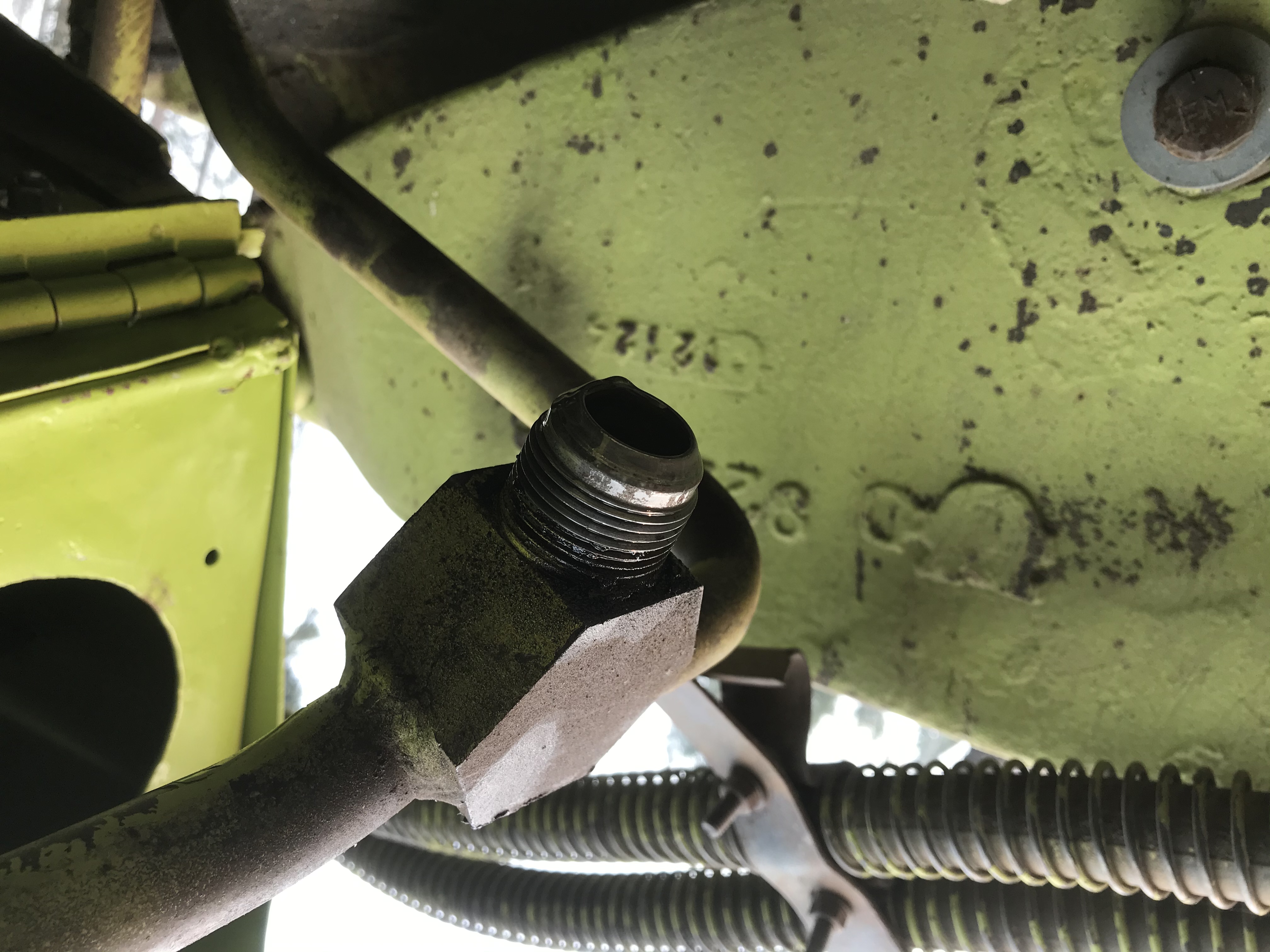

I got a diverter valve, and looked into where it will need to go. I know which hoses need to go where, I need to mount it and take measurements for hoses to be made. I have an equipment dealer service manager friend saying to make hoses all the way out. Mine has the clamp blocks like in the far left picture, but no tubes. The hoses hanging down in that picture are for forklift side shift. I would need separate hoses with elbow fittings to make the same routing. Then what? Wire the hose to the clamp blocks to keep it secure? The clamp block corners would dig into the hoses eventually. I posed the same questions to him, no response yet. I like the cleanness and secure, durable fastening of the tubing. I know it is not as straight forward to accomplish though. I plan on using a momentary foot switch, and then the dump lever will clamp and unclamp the logs. Pushing forward to clamp.

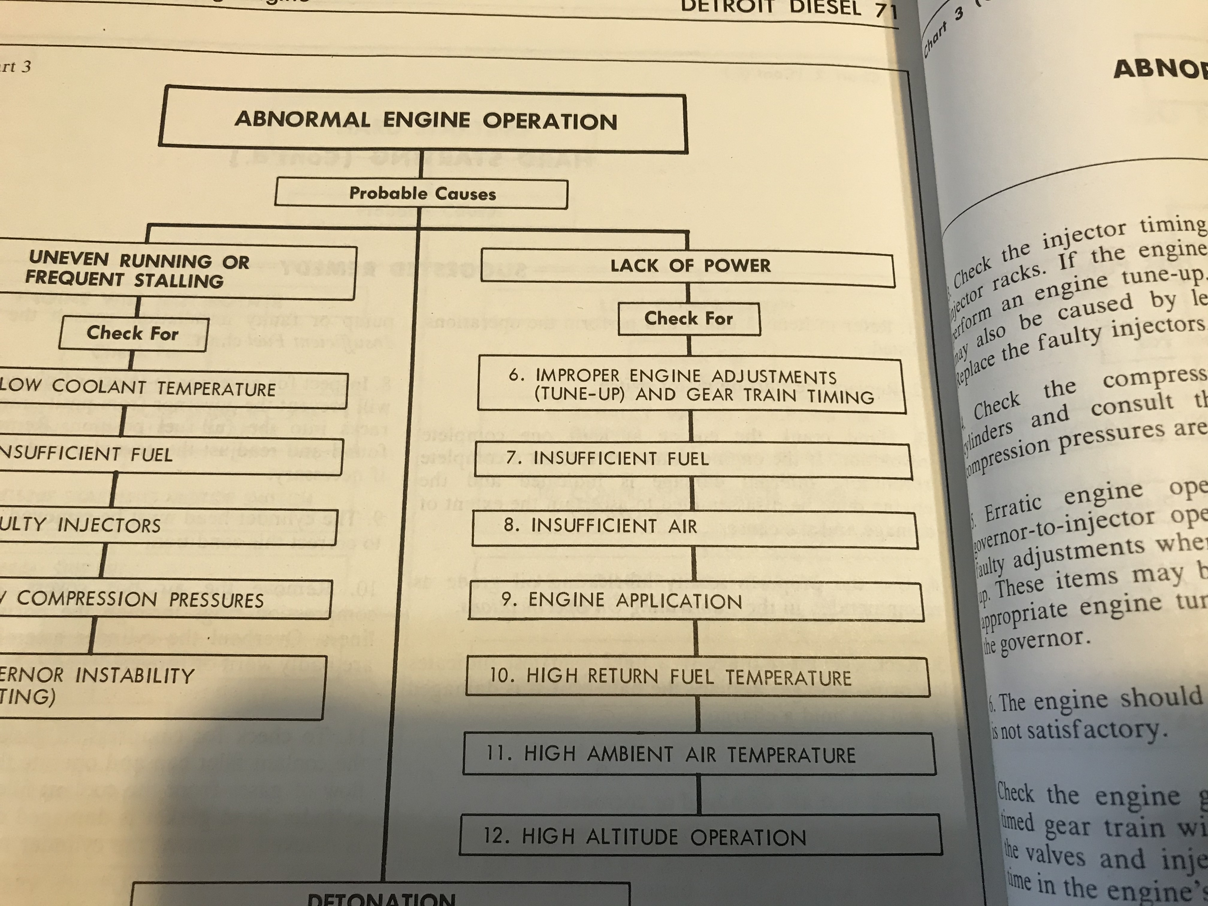

Got the manual now.

I might go up next week, I’ll make a list of forum members suggestions, and also do what the troubleshooting section in the new manual says.
