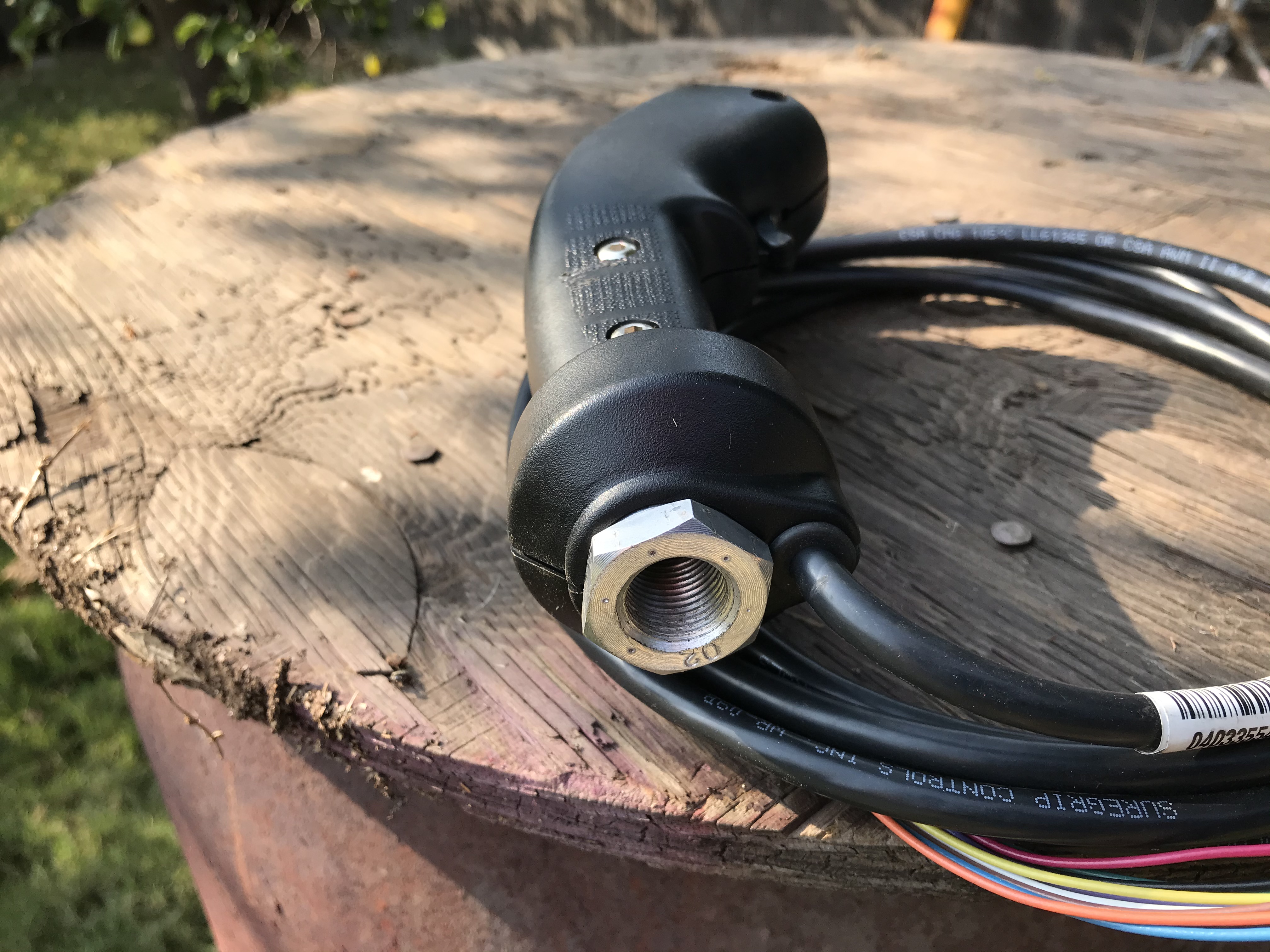

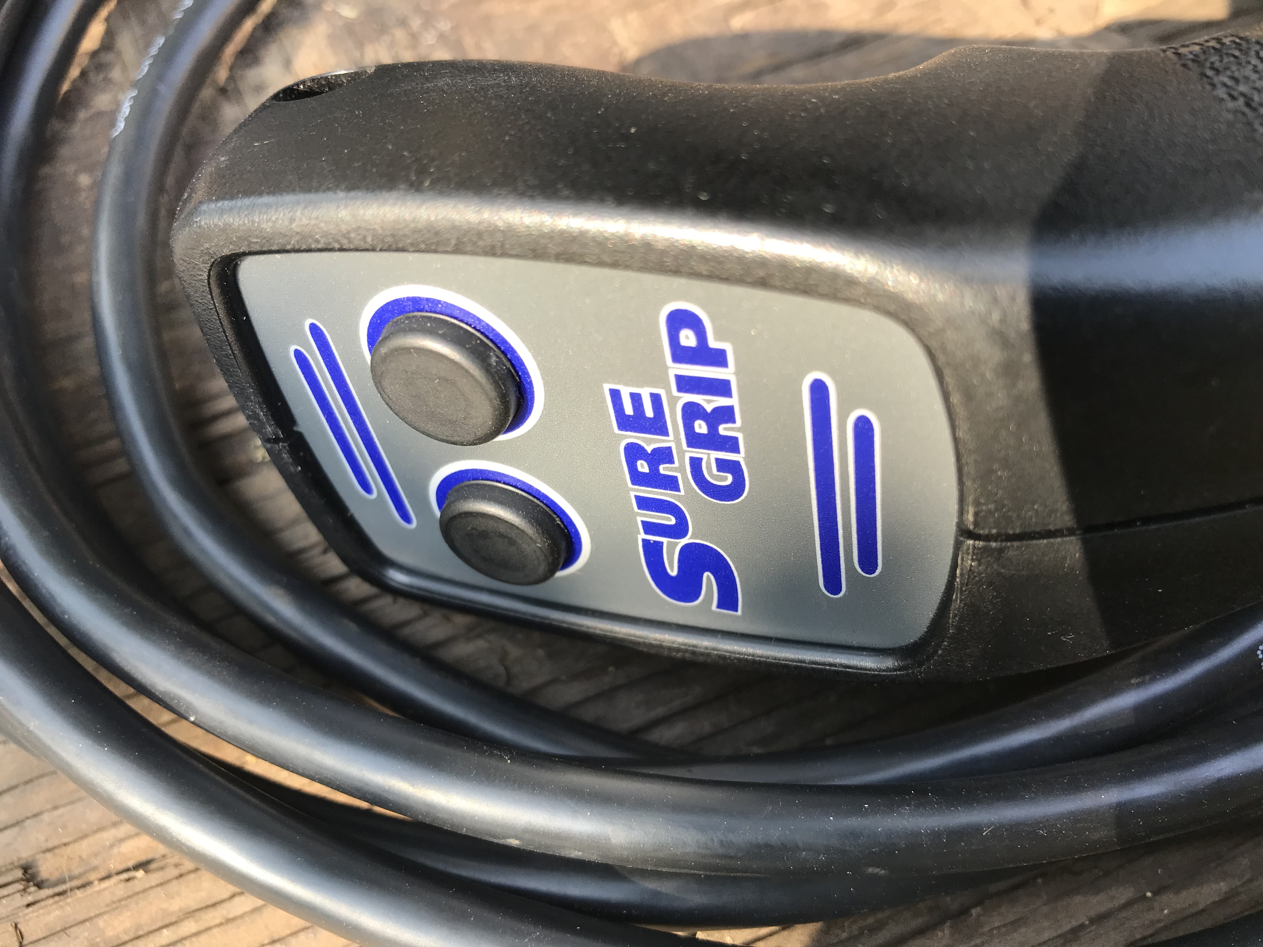

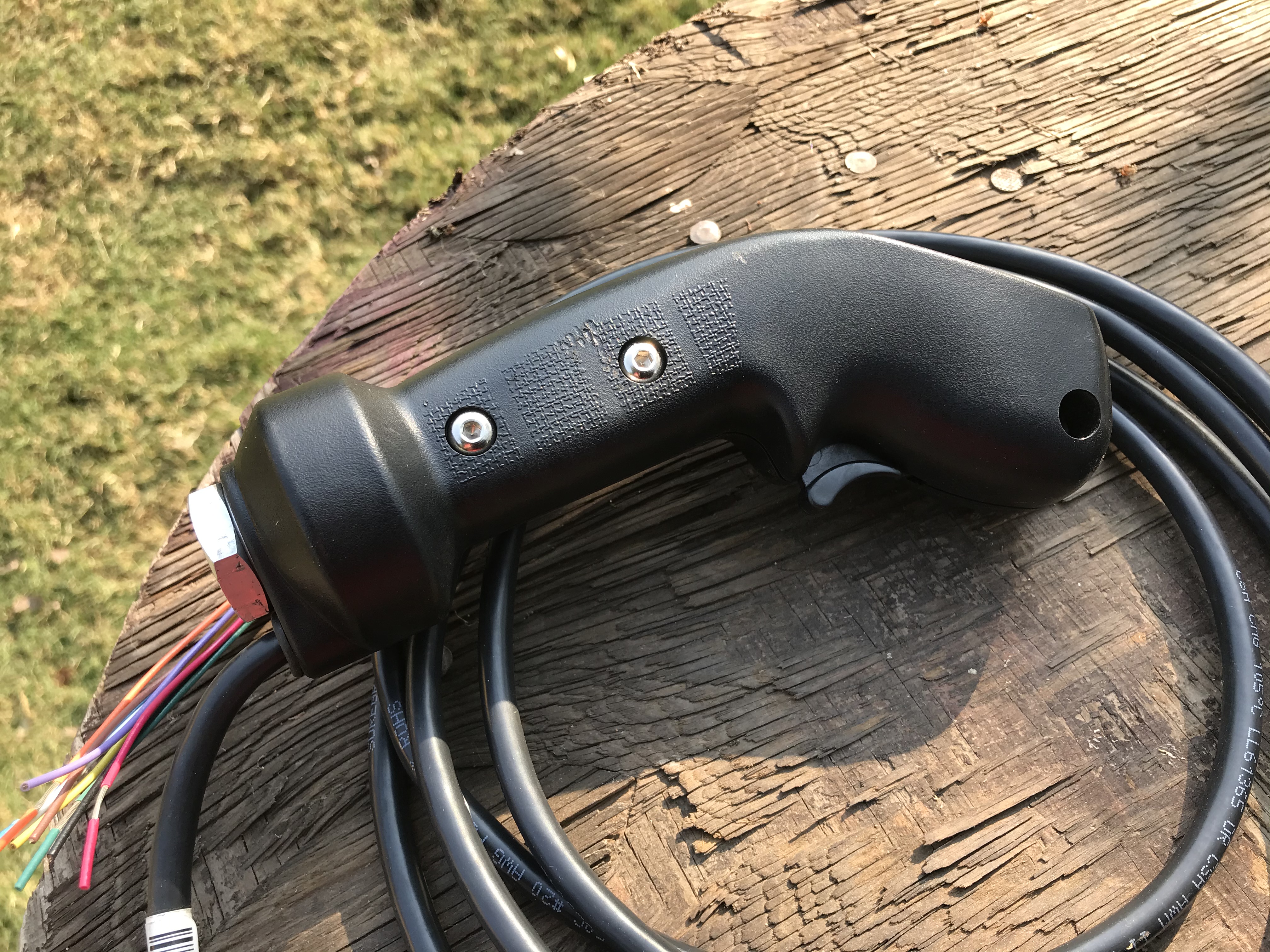

This is what I am going to use to control the grapple.

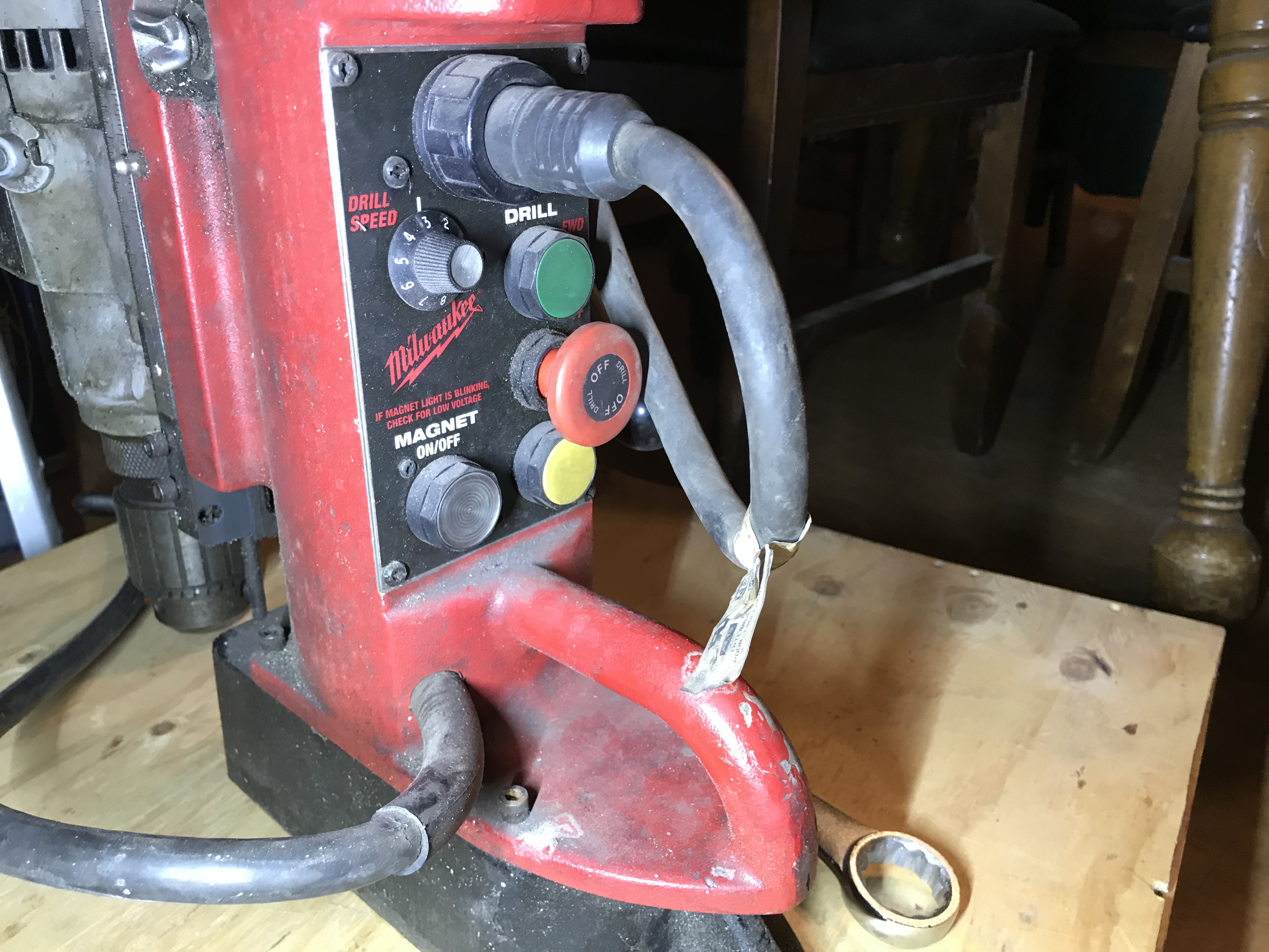

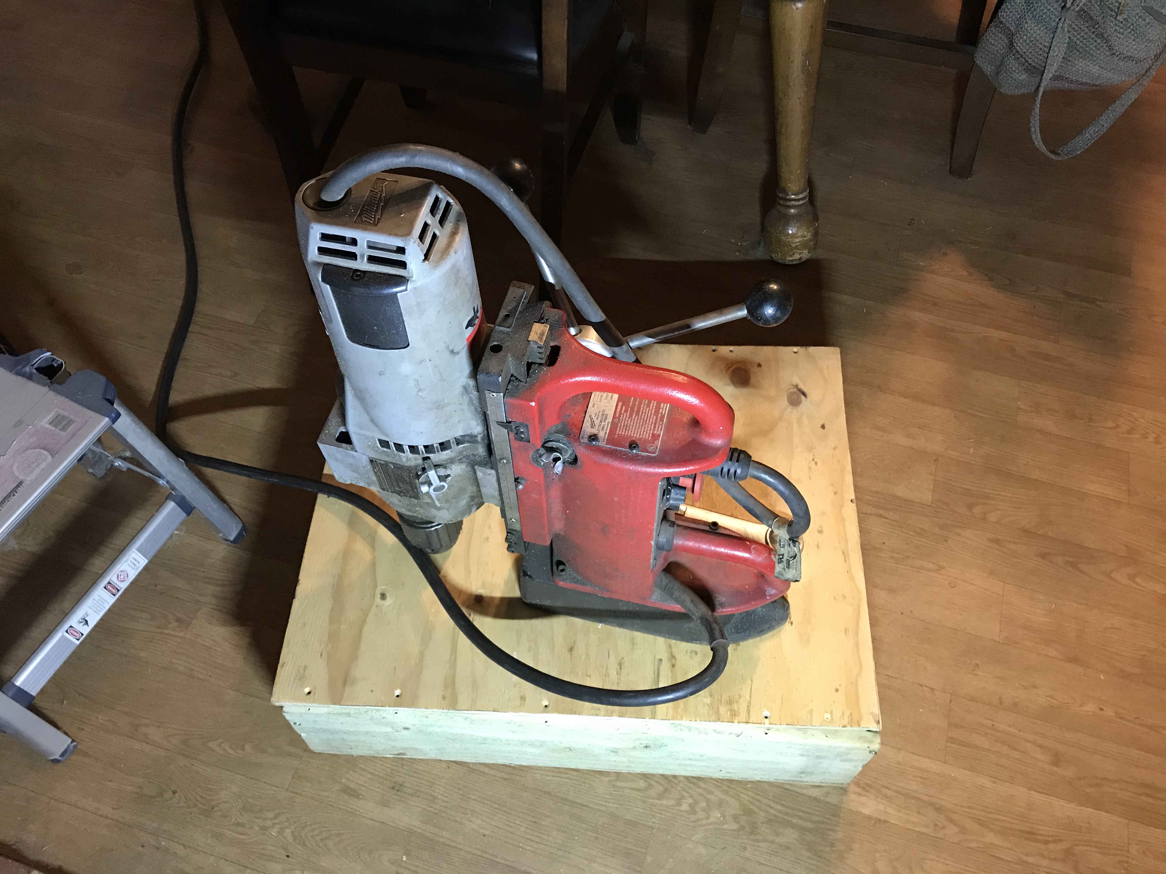

I got this and annular cutters to drill holes for the bucket teeth.

   / Ed's 77 Terex 72-41 Wheel Loader #460
Oh my, I always wanted one of those.
I borrowed one from a friend when we ran a fleet of trucks, used it to drill holes in frame rails for mounting reservoir tanks for wet kits.
I want to build a fabrication table out of 1/2" plate, and that would be the ticket to drill a grid of threaded hold down holes.
