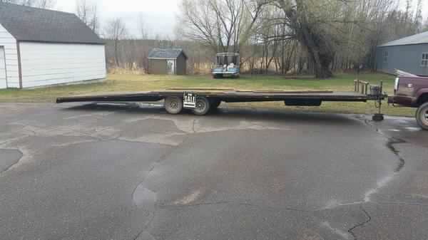

OK, I'm clueless ... why would this tow bad?
It might not tow bad depending on what and how you loaded it. the worst issue is massive overhang and like 6" clearance on the rear. means you basically can not go over any bumps as the rear of the trailer would drag.
cut 5' off the rear and you have a decent 20' flat deck trailer.
assuming tires arnt an issue (inflation, type, ballanced) then the rest of the time bad trailer manners is a function of loaded correctly. eg sticking to the 10% tongue weight rule and not being significantly over or under that number.
The standard for trailers is 65% before the axles and 35% behind. That one looks to have as much if not more behind the axles.

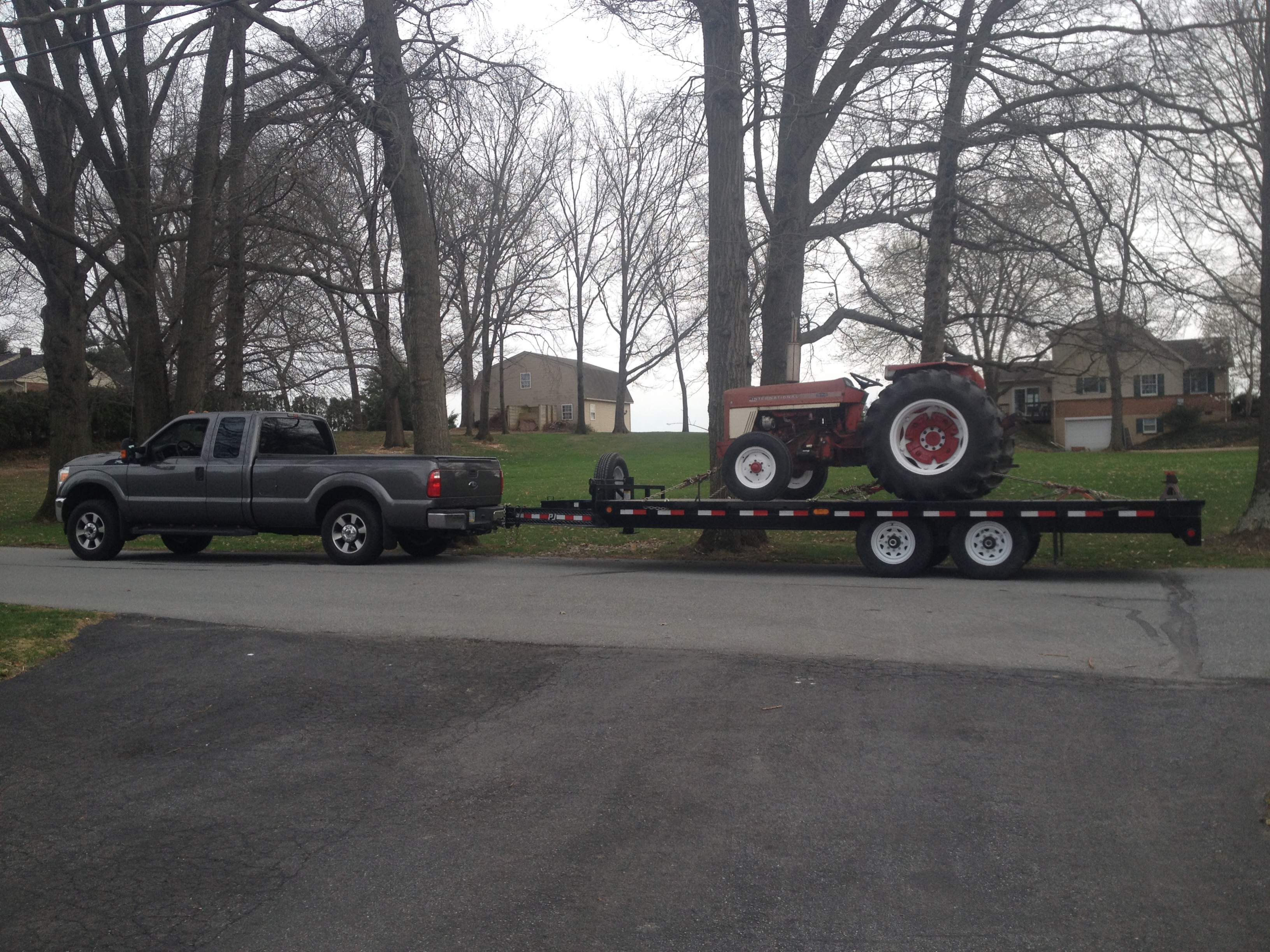

Here's my PJ 20'x96" 14k (26' long all together). I have found that with this trailer if I don't put enough weight on the truck it can be very bouncy. However if I put enough weight on the truck to get it to sag a bit and it tows nicely. My 574 weighs about 7K or so and towed nice.
