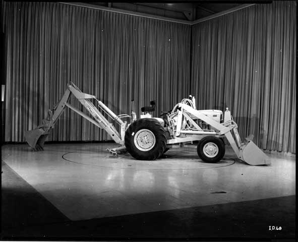

   / Ejector Bucket Design #42
Darryl,
I've attached a picture of the tractor and backhoe from the Minnesota History Society website. The picture looks like it was taken when the tractor and backhoe was initially introduced by Minneapolis Moline. I think this backhoe is rare enough to warrant a proper retirement in a Minnesota History Museum. In the not to near future, I plan on contacting the Minnesota Historical Society to see if they are interested in acquiring it. The old girl has worked hard and lived long. It is only fitting that her final resting spot be one in which she can be enjoyed by fans of old iron, and anyone who is fascinated by the workings of old machinery.
Jason

   / Ejector Bucket Design #43
Reddirt,
I will get some more pictures of the bucket in various positions as soon as possible (probably Friday). So be looking for them on Friday evening. I will most likely have the video posted by that time as well.
Jason
