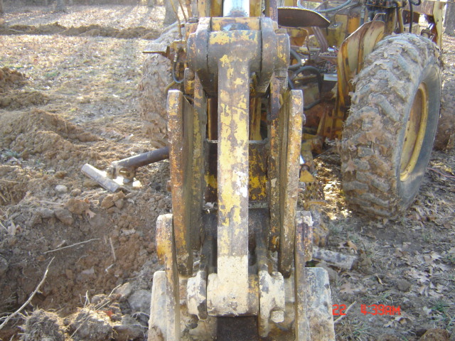

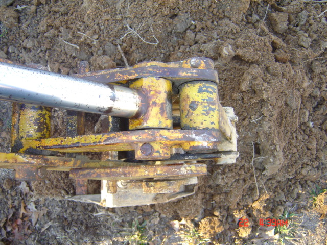

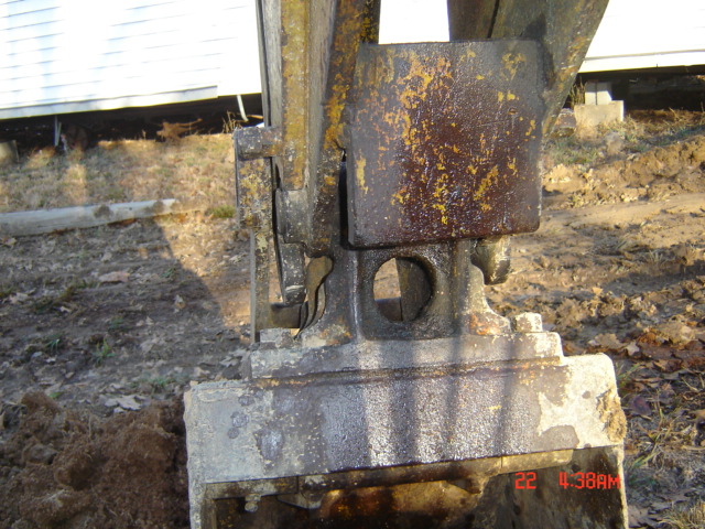

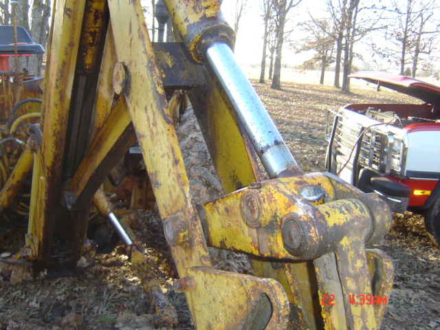

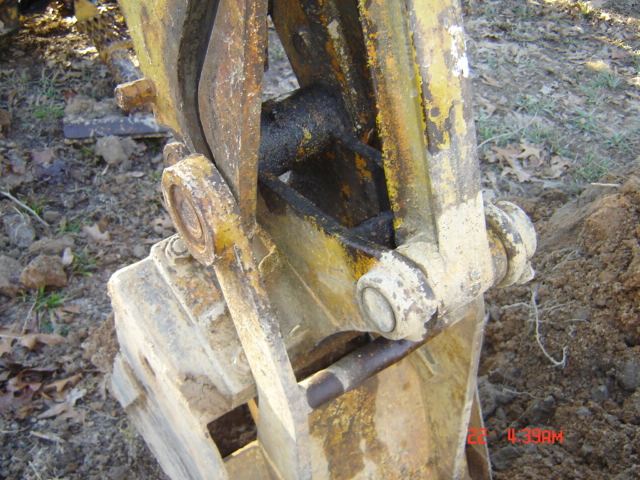

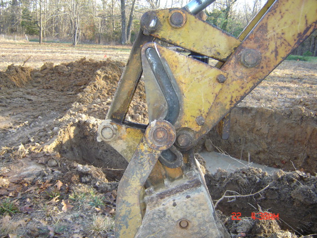

My 1957 Industrial Minneapolis Moline 445 tractor has a Ottawa Backhoe that was designed and patented with an ejector plate built into the bucket. It is a really good design. If you go to the US Patent Office website, just do a quick search for patent number 2,764,306. It is a really unique design. The plate never gets in the way whatsoever. It only actuates when you fully extend the bucket. This is a very rare backhoe. Even though it is 50 years old, it is conceptually way ahead of its time. Now if I could only find a operator and service manual for it.:D

   / Ejector Bucket Design #39
RedDirt,
Thanks for the pic instructions. I made a video this last weekend. But, I have to get a cord that will let me download from my movie camera to my PC. I will get that this coming Friday. In the meantime, I have taken some pictures that will let you see the bucket design. I will get the video up this weekend.

   / Ejector Bucket Design #40
That is a neat old hoe, everything about it is unique. The ejector bucket, boom linkage/ hydraulics and the outrigger design. Very innovative, especially considering the era.......that's a keeper!
