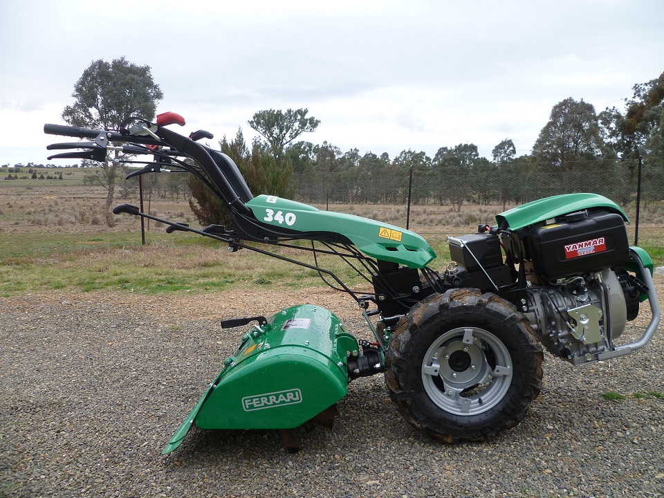

First of all sorry for being a pest and asking so many questions. So here I am pestering you again. Now I would like honest opinions on 12v actuators for use in a front end loader. Also the front end loader will probably go on the two wheeled tractor I know it sounds ridiculous but anyway. So what do you think about extending the loader arms the same distance the other side of center and have a plate on the end that you step on to loft the loader. Anyway that is all of my ridiculous ideas for now.
PS. I would love a hydraulic front end loader but $ speak louder than words...

It would taker forever to use. Your lift capacity would be almost nothing. Whatever load you were loading would become something you had to hold up with the handlebars (which would be pushing "up").
If you do something I'd make a simple dump bucket with an electric actuator dump, but no lift function since you can do that with the handlebars. Don't spend a lot on it, it won't get much use. A small hydro garden tractor would make a much better platform, you could build it with actuators and upgrade to hydraulics when you had the money and got sick of waiting.

I am guessing this is your tractor you have since this is your posted picture
now how will a loader work on this,
how will one support the load, say you have a bucket on it and scoop up some dirt, say one cubic foot, and that would weigh about 100 pounds, and if that is two feet in front of the wheels it will take 100 extra pounds two feet behind the wheels to keep it balanced,
so to load a wheel barrow that is 5 cubic foot it would take 5 to 6 loads, and if it was a larger than one cubic foot bucket I could not hold the back of it down, unless one extended the handles out there a good number of feet to increases the leverage of the handles to handle the weight,
am I not thinking this through correctly,
how high do you plan on the bucket lifting?

I would plan on making a sulky with a steering mechanism. The engine weighs 40kg so if I put 60kg in the bucket and I 40kg of weight on the back and I weigh 60kg, then it still won't tip forward. I bought a manual winch but that is a bit tedious. I don't think I will get hydraulics running off the engine for less than $374 which is what 12v system will cost.
