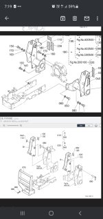

I have a pretty good front end loader already, and I need to mount it to my Kubota l3400… I need to make the mount's myself for a few reasons. The genuine ones are expensive and a good 4-5 month wait, and I would have to modify them in the end anyway.
The attached diagram are the mounts I want to make. (Original Kubota ones) I was just hoping that someone might have the measurements/plans for them.
I also wonder if anyone can explain how this seemingly light design can handle all the pressure put on it?

Nothing light about the design.
The plate that attaches to the tractor is a good 1/2" or 3/4" thick.
The round tube that connects that plate to the upright is also a good 1/2" thick.
What is your level of fab skills? Can you bend 1/2" plate and even the 1/4" plate for the upright? Can you weld 1/2" plate? Can you precisely locate and drill the holes with a little more accuracy than freehanding?
And start by filling out your profile. I have no idea where you live or even what country. But the 3400 is a quite popular tractor.. and I'd be willing to bet if someone had one in your area they would be willing to let you take some first hand measurements

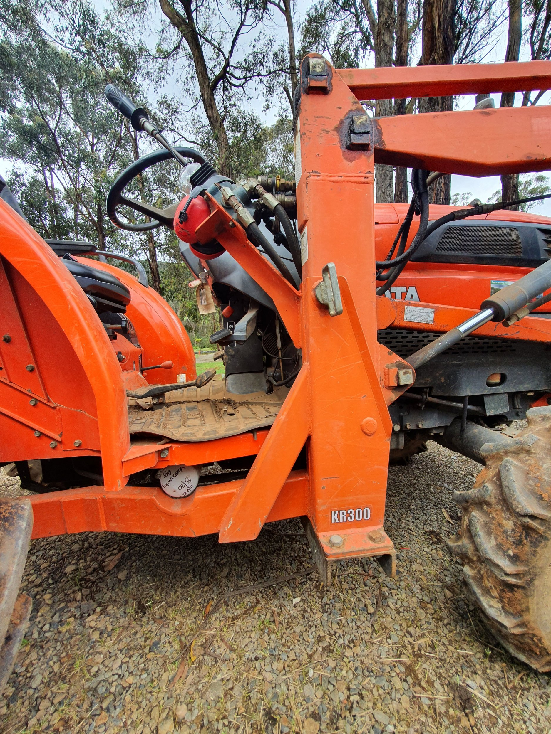

Attached is the design from the loader I visited yesterday.
I really like the idea of building the genuine Kubota mounts, seems like they would be much easier :))

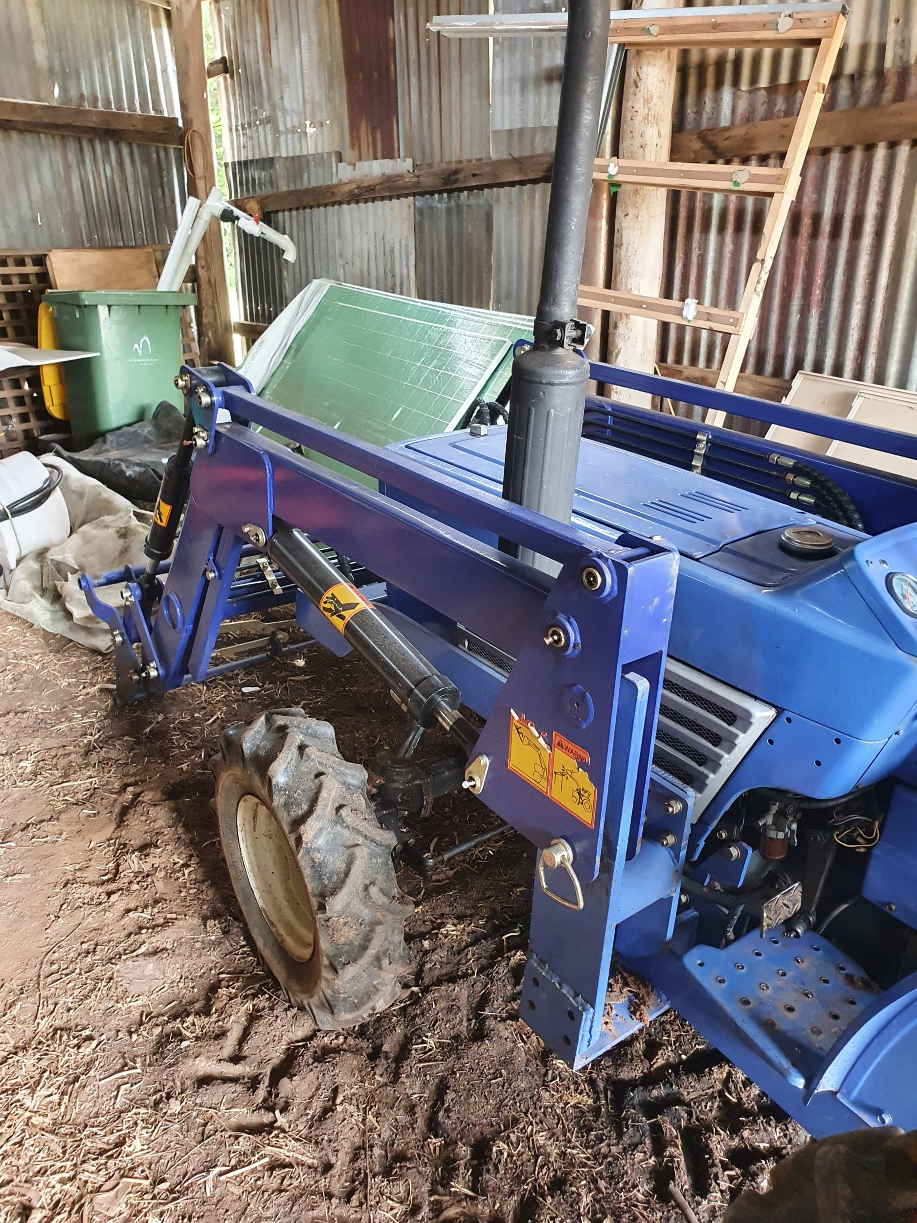

Thanks for the offer. Yes it is the same loader. So I will definitely use those uprights, should make for a relatively simple build once I find/ double check all the relevant information.
Pic of the Iseki frame attached
