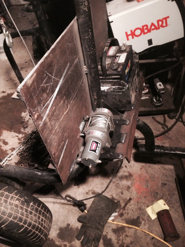

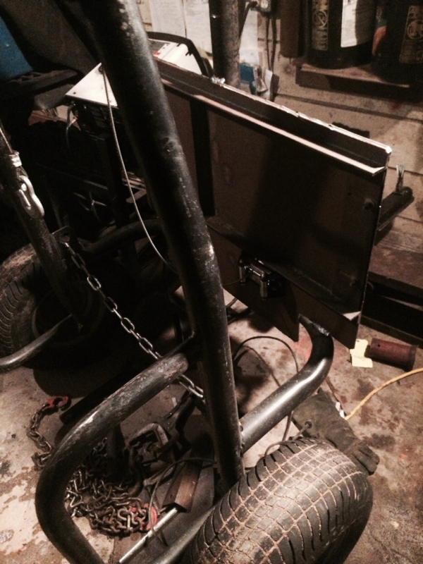

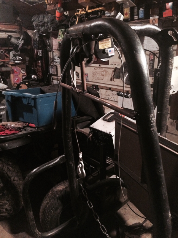

Some crappy pics but im working on it

   / Electric winch on my log arch #45
Why is your winch mounted so low? The cable will get pinched down there by logs pushing forward. You also have sharp bend going up to your top pulley.

I never pull them in that far just far enough so they sit on the chain then i unhook winch and hook the choker up to the arch i dont have the new chain slots cut out yet
And the winch is low for the stubborn pulls i can pull straight back and not lift atv off the ground
