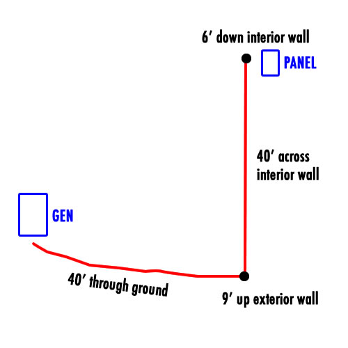

Yeah, it's going to be interesting feeding three #1/0 (two hots and neutral) and one #2 (ground) through approx 100 feet of conduit. I have about 40 feet to run underground from generator to foundation, then 9 feet up an exterior wall, then 40 feet across an interior wall, then 6 feet down interior wall to panel, with a few turns here and there. See attached image, which is a top-down view from above. Trying to strategize the best way to do it, where to start, where to end, etc....
The underground and exterior conduits will be glued up ahead of time. For the interior, I may just friction fit the conduit together one at a time, sliding it over the wiring as I go. Though I have the option of running through a "raceway" for the interior portion, and I need to learn exactly what raceway means for residential code. Seen everything from cable trays, closets, and wall openings defined as raceways on the industrial side.
One strategy is to start at the halfway point and feed wire through the 9' vertical and 40' underground legs towards generator, before I swing the whole assembly up toward the exterior wall. In the process of doing that, I can start feeding the remaining cable through the wall into the interior and at the end swing the vertical up and affix the LB to the wall.

Just out of curiosity how far from the main panel are you running ???
   / Electrical question about amp rating: service entrance versus feeder #17
When I installed my service line, 350 mcm, I just laid the cable out and slid the conduit from each end. The hardest part was the elbow. I started there and slid the conduit from each side to it then kicked it into the hole. My not have bee how the pros do it but worked just fine. You do have to be a little careful as the edges on the conduit are sharp and will damage the wire. 40 feet should be easy. Mine was more than 200'.

... You do have to be a little careful as the edges on the conduit are sharp and will damage the wire. 40 feet should be easy. Mine was more than 200'.
Use a machinist's deburring tool on the ends of the conduit. The tool is under $10, the time is a few seconds per piece of conduit, and the wire will not be damaged.
   / Electrical question about amp rating: service entrance versus feeder #20
I use a large drill bit in a cordless drill as a reamer when I play with metal conduit. Not so sure you need it on pvc.
