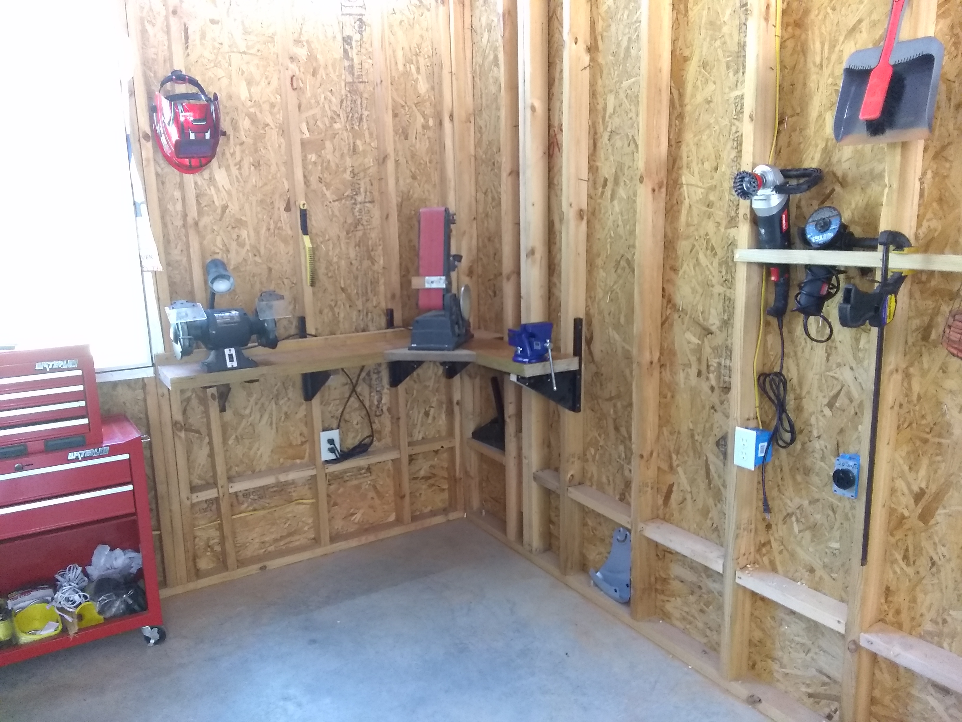

Code around here I believe is two rods six feet apart. Anyone that can pound a ground rod in undisturbed soil... I mean rock, has my vote. I installed a sub panel to my detached shop running 6-3 copper. Still need to add a ground rod or two.
I have three 220v circuits one being a 30amp for my welder and plasma cutter. The other two 220v are 20amp circuits that power my table saw, band saw, planer, jointer, and air compressor As it is a one man shop I am only running one of the big tools at a time and the compressor is on its own, since I never know when that will kick on. Beyond that I have two 110 20amp circuits for lighting, hand tools, a mini water heater, dust collector and air filter. Also have the original single 110v for the basic lighting and original outlets.
