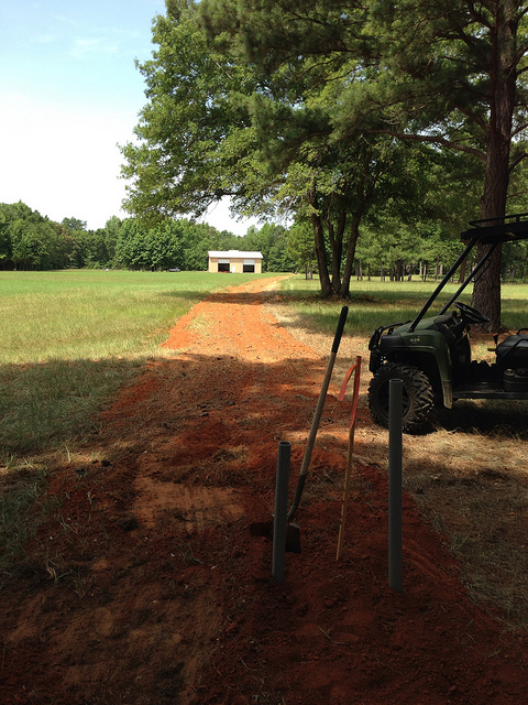

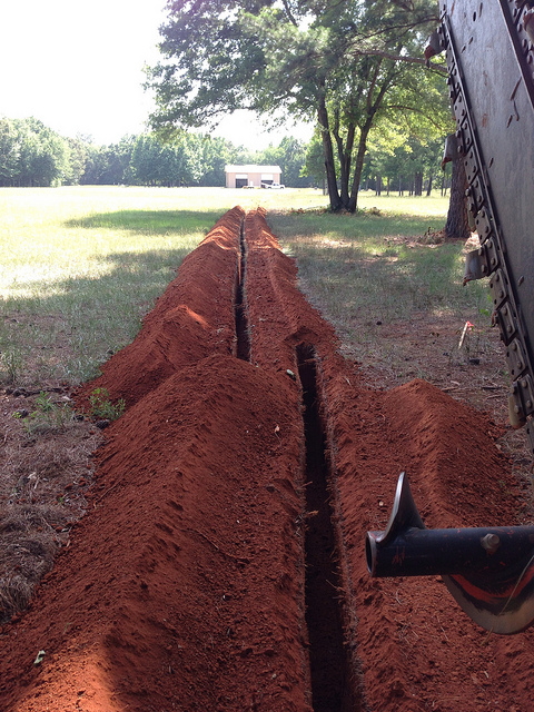

I trenched in about 1000' of 2" conduit, 36" down for mainline power service this past year (plus 1" for cable service around 24" down). Two pad-mounted transformers.
And I thought I had it bad sitting on a Ditch Witch RT45 for 12 hours one day going through nothing but mostly red dirt... your project puts it into perspective for me! I didn't hit one single rock. Good job! :thumbsup:

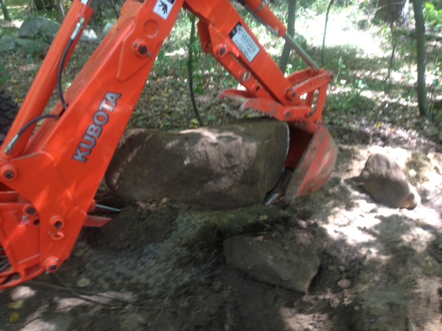

I envy your soil! Any project I have that requires any amount of digging ends up with these huge boulders. I've been VERY lucky so far on this project. At any point I could easily encounter a boulder that is far bigger than the tractor and impossible to move. I actually found one in my lawn last year and couldn't even get it to wiggle after excavating it. I figure it weighed 20k lbs. The one I moved last night was probably 8 - 9,000 lbs.

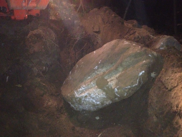

Here is the final resting place of yesterday's rock. It's tough to see because it was dark out when I finished (the work lights on the B2920 work pretty good, the last hour was in darkness). I ended up standing it on it's edge and off to the side so the new trench path will miss it by a small amount. To give some perspective on size the hole it is in is probably 5' deep.
While digging this out I did make an interesting discovery. Down about 5' deep the soil changes and is much more sandy clay soil with virtually no rocks. Not sure why, but found it interesting that there is such a dramatic change in soil types. Very easy digging if you can get to it!
I had to fill in all of my holes and that part of the trench to secure the rock and get things back on track. This weekend I will retrench the area next to the rock and continue the last 100' at a depth of either 24" or 18" VS the 30 I had been doing. Hopefully I'm out of the rockiest part now.

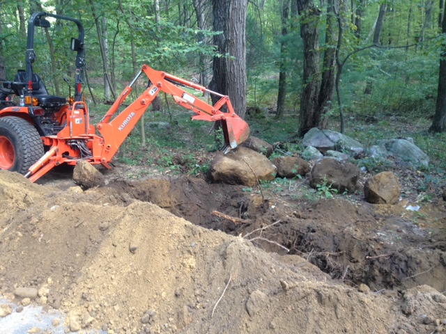

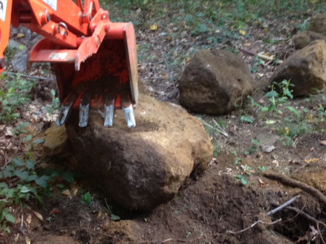

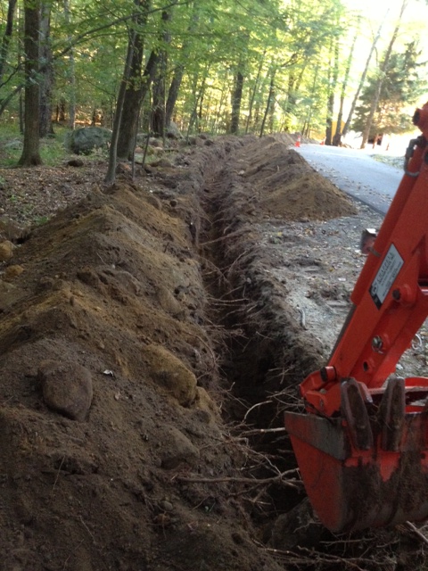

I finished the trenching on Saturday. I'm happy to say that the last 100 feet was MUCH easier. There were sizable rocks, but nothing that took more than 5 minutes to deal with. The digging surface was also level, which is a huge help in terms of positioning the tractor and not pivoting or sliding when doing the work.
The next phase is to backfill a few inches of sand, install conduit and then cover with 12" of sand and caution tape" then I'll pull the wires.
Here are some pics of the final 100' and some of the rocks encountered.
Finally done! The last bit looks nice and uniform since there were so few big rocks, lower down the rocks required wider holes to be dug and backfilled.

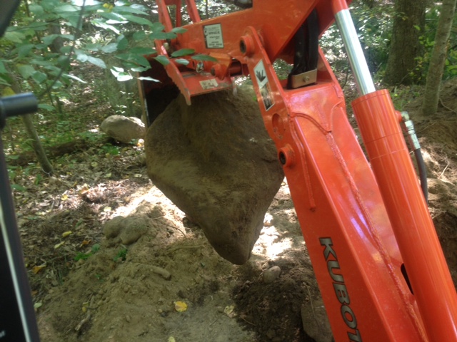

A typical rock. At the beginning these took a lot more work to get out. Now they're a minute or two. I've discovered that by clearing off the soil and then using the bucket curl you can often pop them out and then either drag them out or pick them up with the thumb. Using the curl helps reduce the force on the tractor since the ground is the lever, otherwise the tractor is light enough that pulling on a rock like this that's embedded with the whole boom just drags you around.
the last rocky section. All the brown rocks were clustered together in a 5' section and had to be removed one by one.

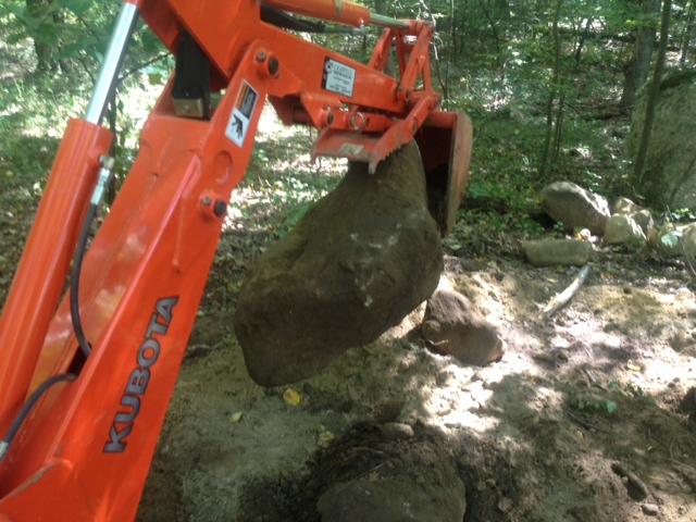

This is about the max size that can be easily lifted by the BH65. Luckily it's narrow so I can grab it. Obviously bigger rocks can be moved, but they usually can't be fully lifted up and swung like this one.
Another near max size rock

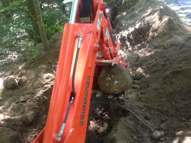

Yet another. It's impressive how much a small BH can move around.
This size rock was everywhere. I probably hit one of these about every 3rd or 4th scoop. Most of them I just tossed and rolled into piles down the slope. Eventually i'll collect them all again and build something. I must have 50+ of these!

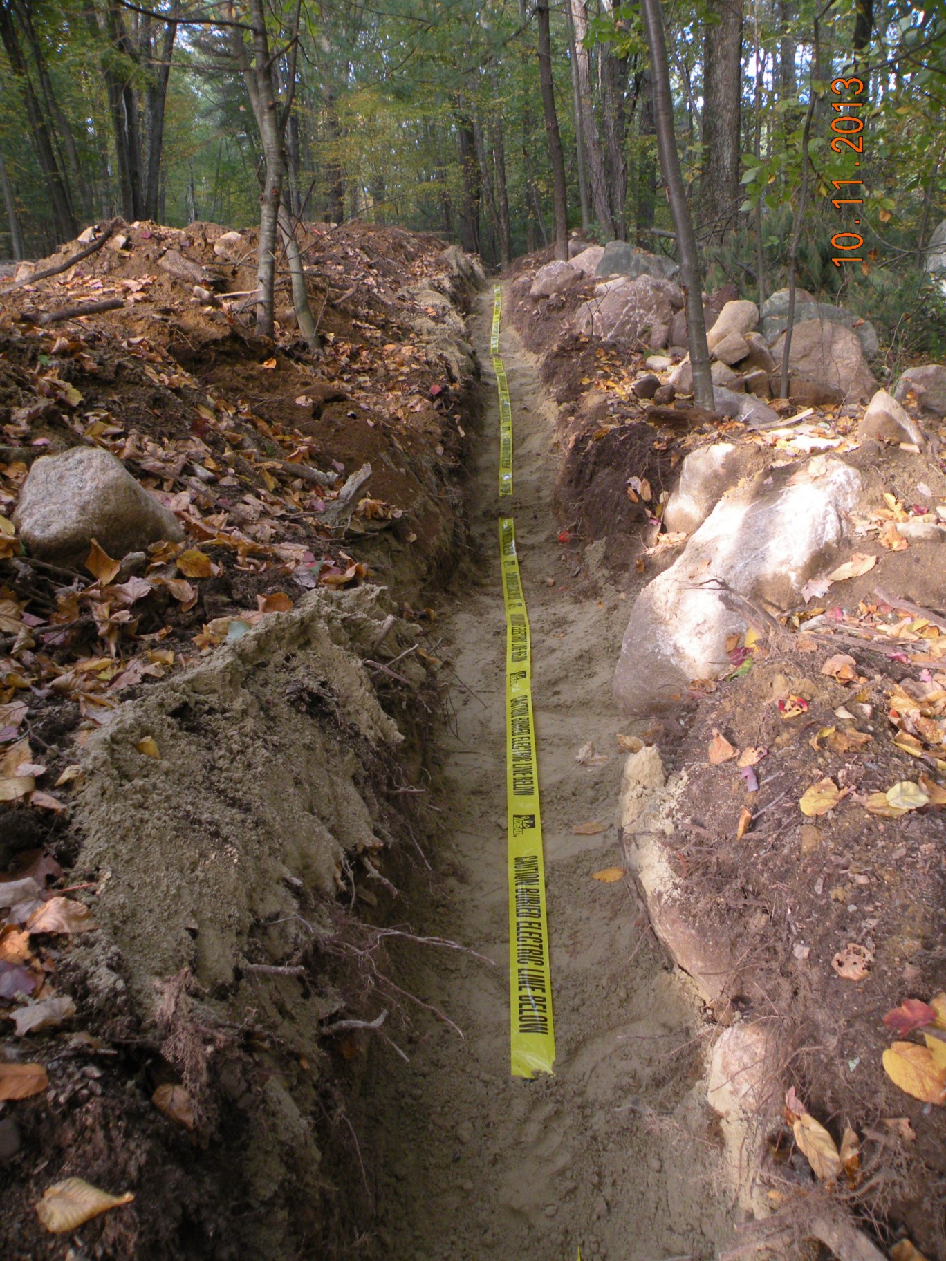

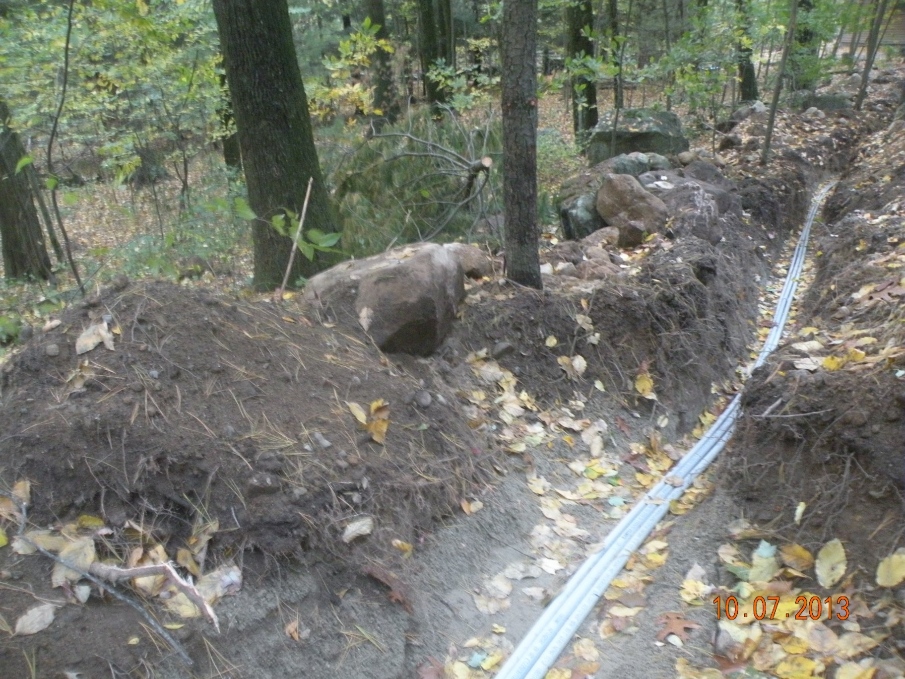

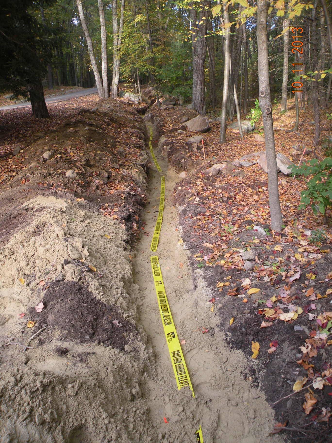

I haven't posted on this in a while and thought I'd provide a quick update - especially if other folks think about similar projects. In the last few weeks there has been less digging and more loader work. My town uses the NEC rules for electrical code and for this job specifically table 300.5 governs the burial depth, conduit etc. The electrical inspector requires 3 different visits - Raw trench, trench with bedding and conduit and finally trench backfilled 12" with shading material and a warning ribbon run.
In my case I backfilled with around 10 yards of sand for the first run to create about 6" of bedding depth in the entire trench length. I then installed 3 conduit runs, 2 x 1" and 1 x 3/4". Code dictates that low voltage control wires (a phone cable and video cable in this case) be separate from the high voltage (120v) lines (2 in this case). The third is a spare. The conduit had to be schedule 40 PVC and in my case code required a cover depth of at least 12" (120v GFCI), but deeper is better. In my case the depth ranged from 30" to 18". As a trick to lay the conduit I built 20' sections in the garage and then covered the ends with socks and elastics to avoid getting a rock in it. We will pull 10 gauge wire for the electric to deal with voltage drop.
The conduit then needed to be shaded with 12" of sand (about 15 yards) and then marked with warning tape. Based on the huge number of rocks it was recommended that the trench be mostly back filled with sand to avoid issues, so another ~15 yards got it mostly filled. It's worth noting that the B2920 worked perfectly for the backfill, I was able to climb the spoils pile and get enough reach with the FEL to backfill over the pile VS trying to move it around or need access to both sides of the trench. I then pushed back the excavated soil into the trench minus rocks any bigger than about 6" across (per code). The interesting this was that even with the 40 yards of sand I still had low places because of the number of rocks I took out!
The next part of the project is the actual installation of the gate and low voltage control lines and a bore under the driveway to get power and control lines to the opposite side. Then everything can be wired up.
Here are some pictures of the trench work:
Conduit on sand bedding
Conduit on bedding, it curved nicely on the uphill portion and had more flex than I expected.
Shaded with 12" of sand and flagged with warning tape
