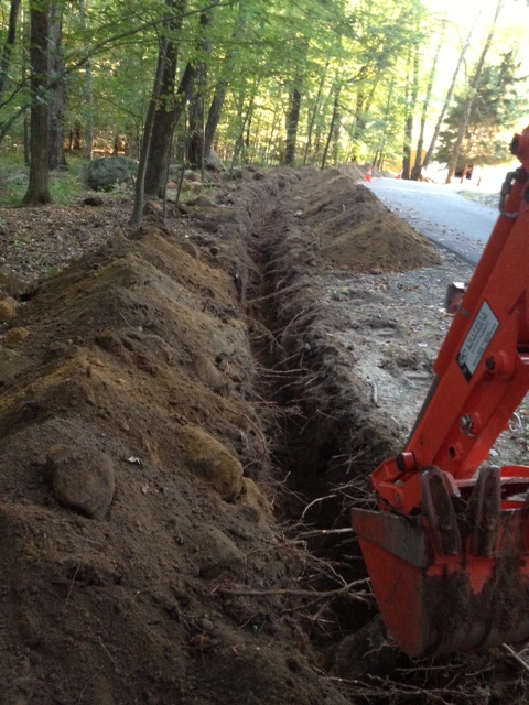

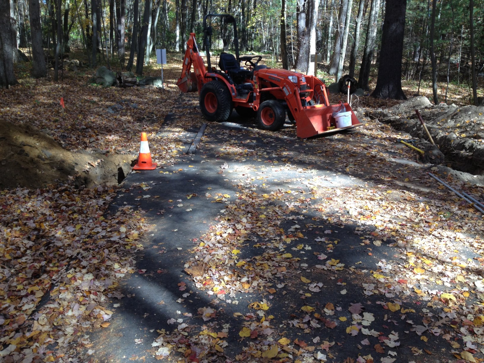

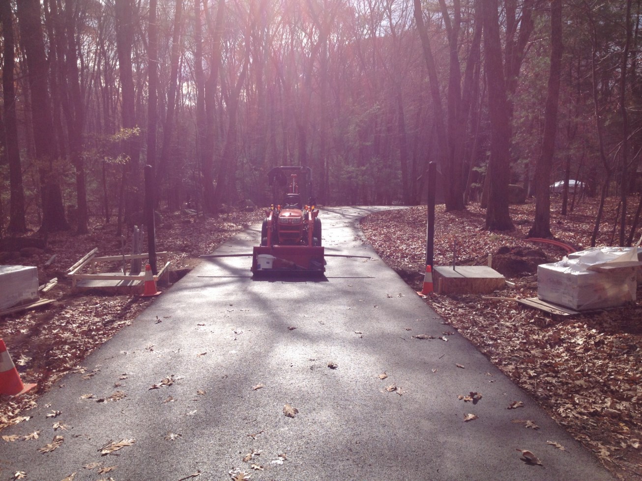

Here are some pictures of the final bore trenches and where the gate will be located.
Gate location will be where the cone is. The bore will be right near the gate posts, probably just far enough so the cement doesn't encase the conduit. Everything will be tied in to a junction box and control box, which will be on the right side next to the gate post and hidden by a stone column, which i will build after the gate posts are cemented.

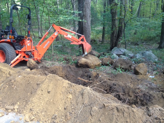

Entrance trench. This is a bit bigger than needed as it's where all the conduit runs will come together for the junction box. I'll have 6 conduit runs coming together here, which should make it interesting to wire up. Dimensions had to be 4' x 4' x 3' deep. The bore is at the very bottom of the hole, so nice and deep, which will prevent an issue if the driveway is redone.

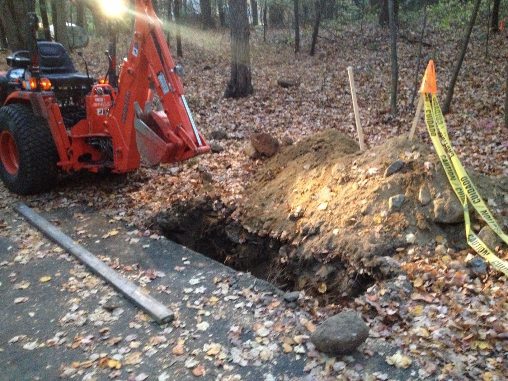

exit trench and far gate post hole. The dimensions are 4' x 16" x 4'. I made it a bit deeper to give a bigger target. A gate post will go in here and wiring for the slave opener and another stone post and light will be run through. I sleeved schedule 80 PVC inside HDPE pipe, which is what the NEC requires for 'boring' installations.
I believe that the digging part is almost done!

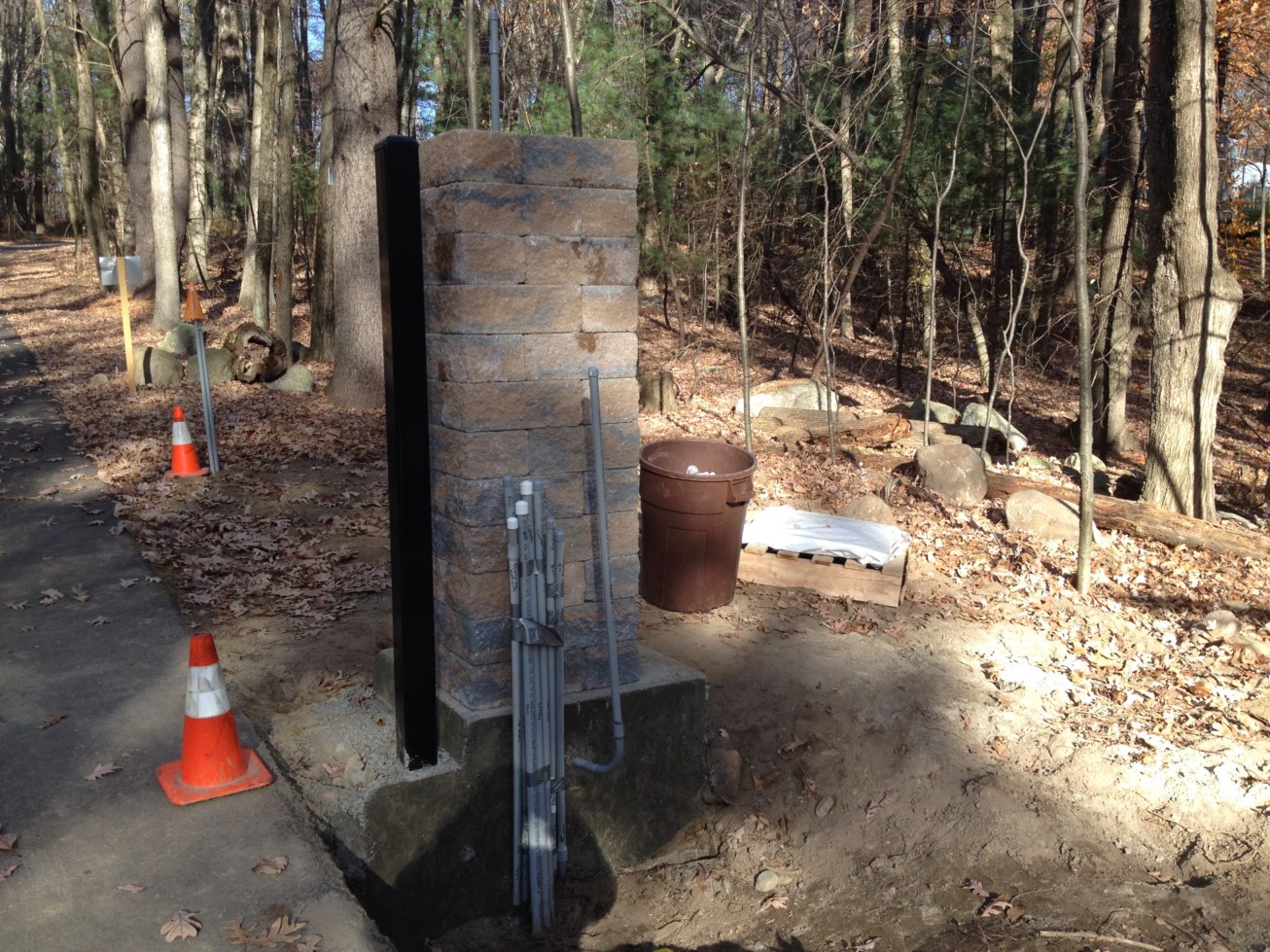

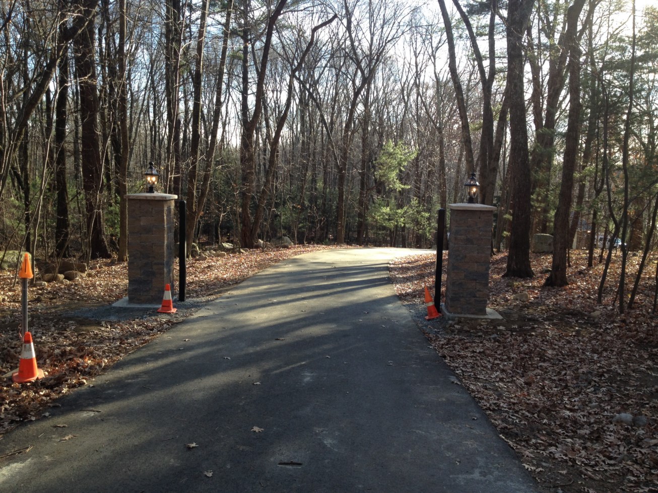

It's been a little while, so I thought I'd post an update. While the trenching is done, I thought folks might want to see what all the hard work was for!
Gate Posts set 4' down in concrete. I decided to go with a partial footer for the columns VS compacted base. The pads are 36" x 36" x 12+" (doesn't need to be a frost footer). Got them in just in time to avoid the cold weather.
Partially built column. These are mini-creta pillar kits and are a dry stack block. I used adhesive since they're just over 6' tall on the bases. After the first course is set and level it's about an hour per kit (each side requires 2 kits). Total install time for both columns was about 4 hours and that was with me taking lots of brakes and going slow on the last few rows, which were very high to lift the blocks
Completed column without the cap. Caps were added after and were cast concrete. They were ~150 lbs apiece, thank god the FEL could reach high enough for me to just slide them into place, even with 2 people lifting them over 6' off the ground wasn't happening.
Columns completed and topped with lights. Electric was run without any issues and now we're just waiting for the gate itself and automation components to arrive. Lights are using a wireless 'z wave' switch, which I have setup on a timer.
