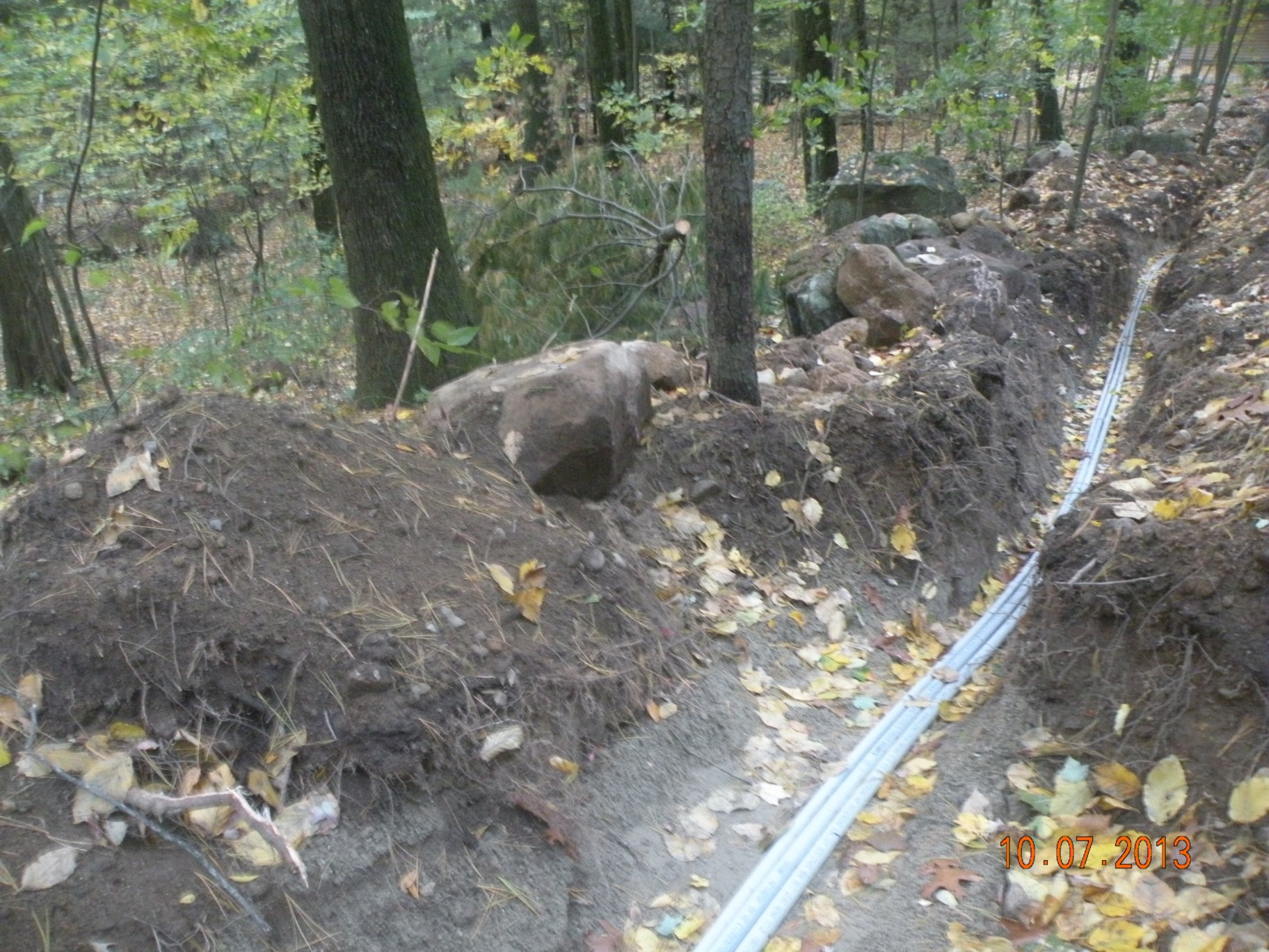

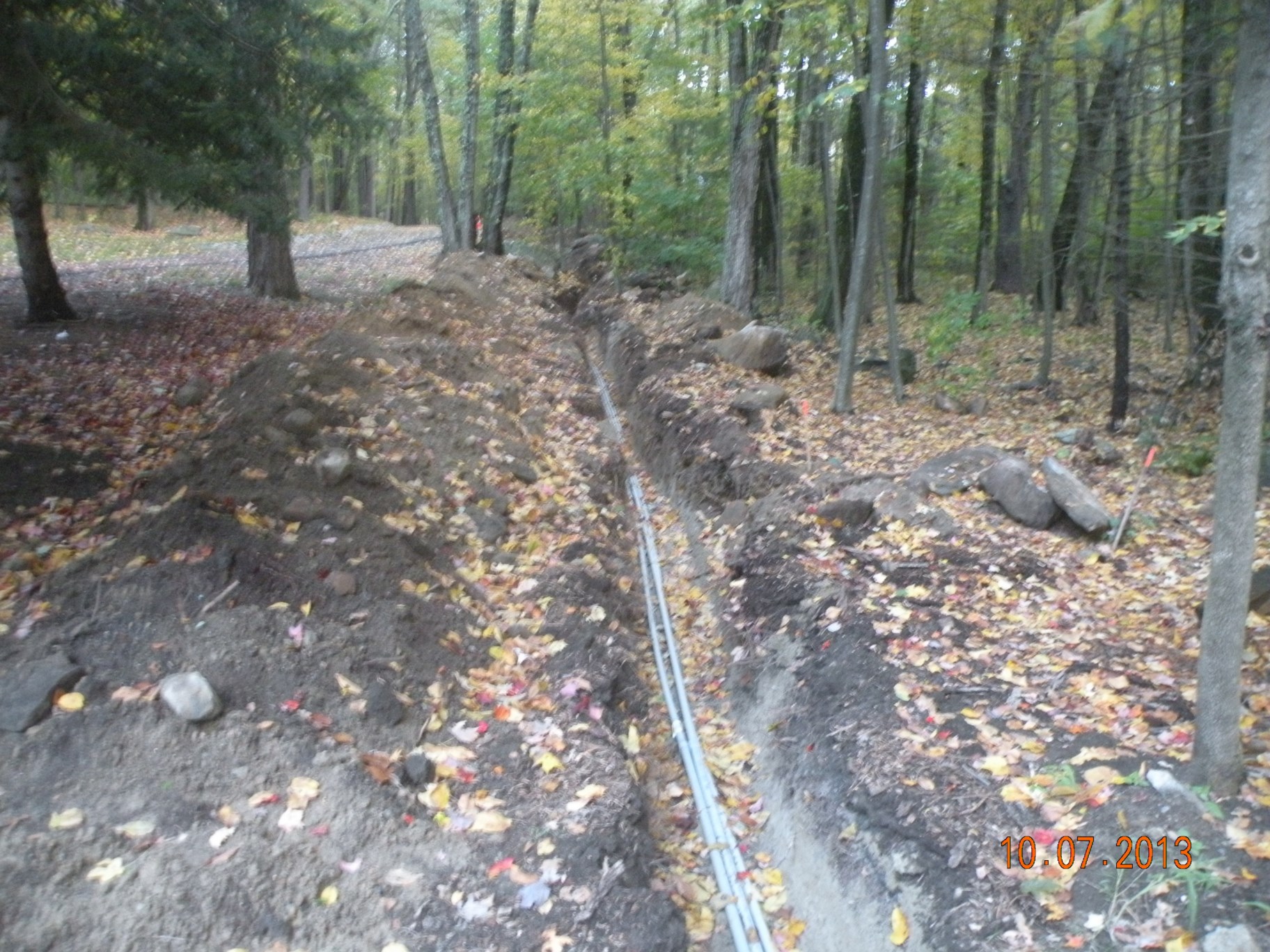

I haven't posted on this in a while and thought I'd provide a quick update - especially if other folks think about similar projects. In the last few weeks there has been less digging and more loader work. My town uses the NEC rules for electrical code and for this job specifically table 300.5 governs the burial depth, conduit etc. The electrical inspector requires 3 different visits - Raw trench, trench with bedding and conduit and finally trench backfilled 12" with shading material and a warning ribbon run.
In my case I backfilled with around 10 yards of sand for the first run to create about 6" of bedding depth in the entire trench length. I then installed 3 conduit runs, 2 x 1" and 1 x 3/4". Code dictates that low voltage control wires (a phone cable and video cable in this case) be separate from the high voltage (120v) lines (2 in this case). The third is a spare. The conduit had to be schedule 40 PVC and in my case code required a cover depth of at least 12" (120v GFCI), but deeper is better. In my case the depth ranged from 30" to 18". As a trick to lay the conduit I built 20' sections in the garage and then covered the ends with socks and elastics to avoid getting a rock in it. We will pull 10 gauge wire for the electric to deal with voltage drop.
The conduit then needed to be shaded with 12" of sand (about 15 yards) and then marked with warning tape. Based on the huge number of rocks it was recommended that the trench be mostly back filled with sand to avoid issues, so another ~15 yards got it mostly filled. It's worth noting that the B2920 worked perfectly for the backfill, I was able to climb the spoils pile and get enough reach with the FEL to backfill over the pile VS trying to move it around or need access to both sides of the trench. I then pushed back the excavated soil into the trench minus rocks any bigger than about 6" across (per code). The interesting this was that even with the 40 yards of sand I still had low places because of the number of rocks I took out!
The next part of the project is the actual installation of the gate and low voltage control lines and a bore under the driveway to get power and control lines to the opposite side. Then everything can be wired up.
Here are some pictures of the trench work:
Conduit on sand bedding
Conduit on bedding, it curved nicely on the uphill portion and had more flex than I expected.
Shaded with 12" of sand and flagged with warning tape

That looks good! I'm glad you are installing it in accordance with the NEC. Remember you have to be schedule 80 where you emerge from the ground.

Just something quick, maybe run two 120vac lines out (240 between the hots) if they will let you get away with it. be sure to run some pull tape/rope in there with the wires as a leave in for later. best to pull it WITH the wires so they do not twist around each other. Seen pull tape cut thru wires that the tape had been twisted around.

Good job but how do you get your tractor down that trench of boulders?
I backfilled from the side. I put the biggest rocks on one side of the trench, where they'll stay (I'm now moving them into piles for some future project). The other side of the trench closest to the drive had the dirt piles. The B2920 had enough clearance for me to drive up on the dirt piles and then dump the bucket into the trench. It worked out well because 1 bucket is about equal to 6' of trench filled with sand to 12". I just went bucket length by bucket length down it, then leveled with a rake and packed it down. The final backfill was done using the FEL to push the dirt into the trench and the weight of the machine to pack it. For the few areas with dirt piles on the far side of the trench I drove into the trench (front wheels hanging on edge), then lifted the front out with the FEL and back dragged the pile into the trench. It worked out much easier than expected. Now if I could just find someone to buy my rocks by the pound!
