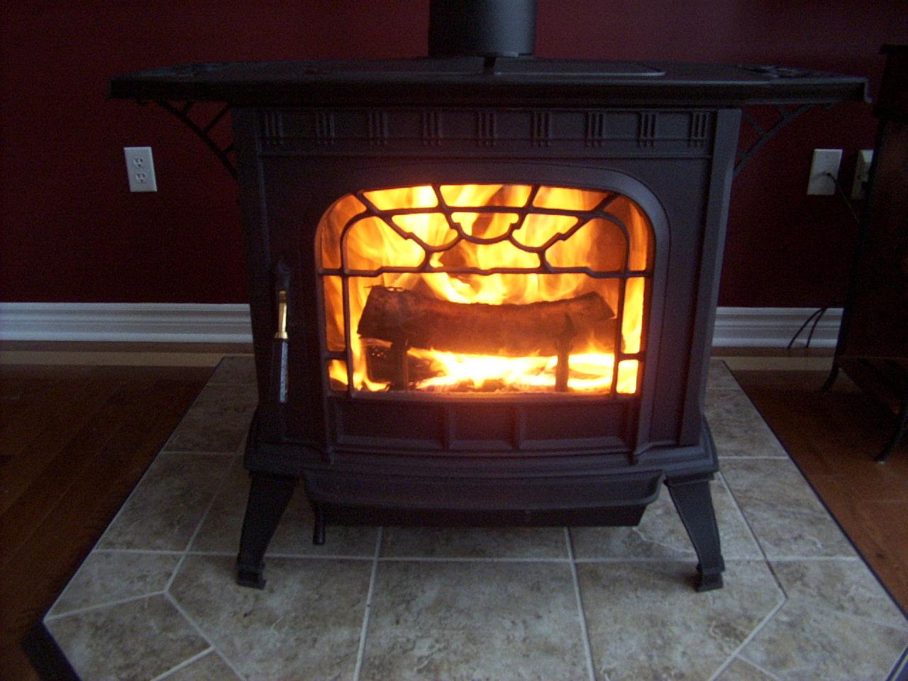

You are a cooling dominant climate, I'm in a heating dominant climate, so hard to compare just on a sf basis.
1400 KWH per month for 2400 sf, 46 kwh /day
Winter is my low period, because I use oil and pellet stove, hopefully soon geothermal.
I put a Kill A watt meter on my pellet stove to see how much electric it will use next winter.
someday I will finish connecting my WEL, so it will measure complete electric usage, AH usage, etc..... So far I just measure indoor and outdoor temps, pretty lame..... I put the WEL in to eventually monitor my geothermal system when I get it in.
Web Energy Logger:
