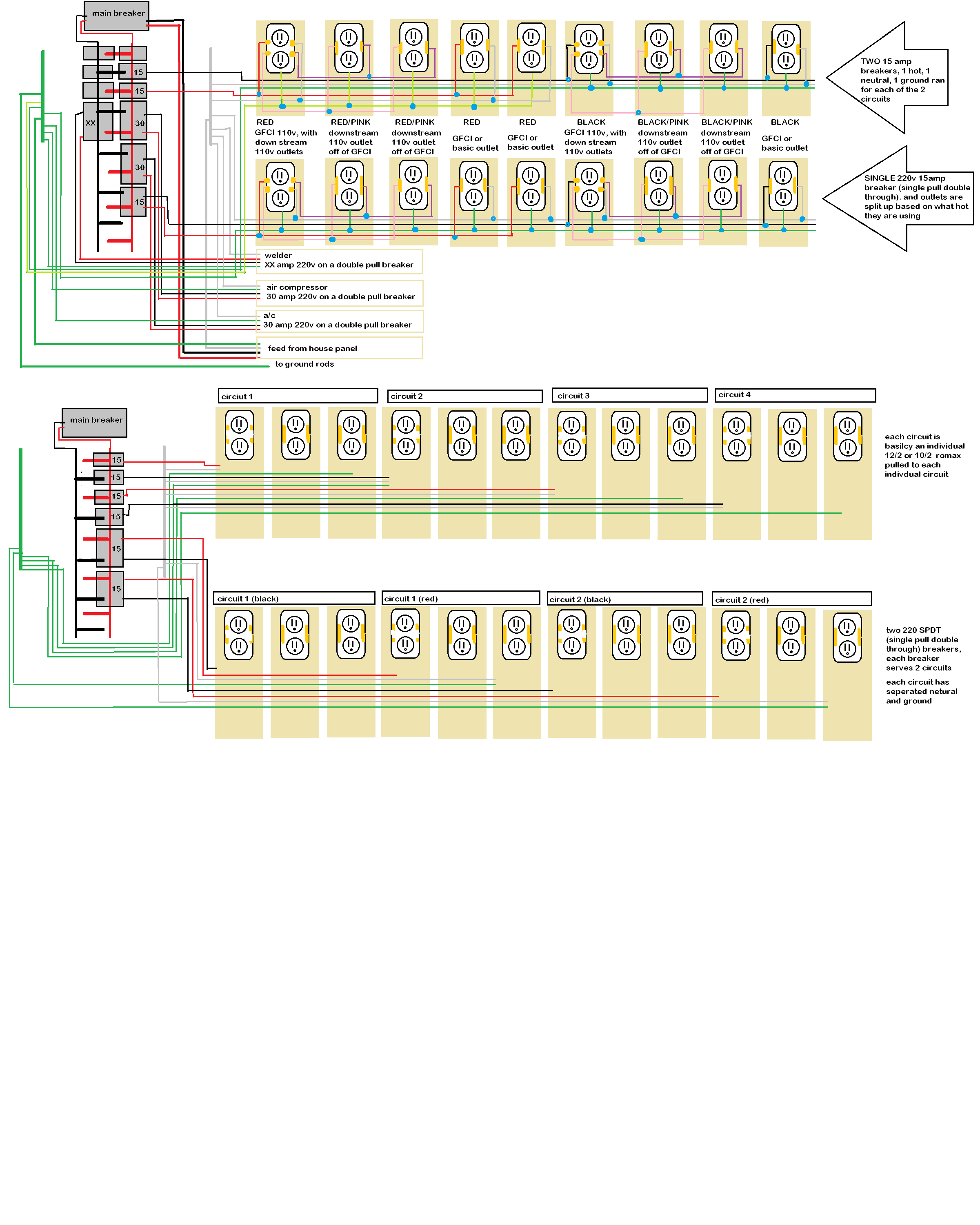

see attached diagram... i started to fill out bottom (1-4) circuits. but eyes are getting blurry, from looking at all the lines
i would still push for individual "romax" like pulls to each individual circuit, and running each circuit on a separate breaker. vs trying to come off a 220v breaker. or trying to use a "breaker tie" to tie 2 individual breaker switches together.

Gonna throw my hat in the ring on this one, probably repeating what has been said, as I have not read all posts.
LD1, you have the right idea about multiwire branch circuits. I do want to make a few points which I hope will make your job safer and easier in the long run.
1) Use the next larger size EMT than what the code allows, if it calls for 1/2", use 3/4", etc. The only exception would be use 1/2" for a switch leg or single outlet with no more than 3-4 wires. You will be glad you did if you ever try to pull another circuit in later.
2) Pull a ground. Yes you can use the EMT, but I have seen EMT loosen and even separate from normal bumps and a ground wire is cheap insurance that you will always have a good ground. I prefer the green insulated myself but it makes no difference if you use a bare or green.
3) If you do use a multiwire branch circuit, pigtail the neutral everywhere you connect it. The neutral conductor must remain continuous even when a device (switch, receptacle, etc.) is removed. Don't use the two screws on a receptacle to connect the line and load neutrals, make a 6" pigtail and connect one end of it and the two neutrals together with a wire nut then connect the other end of the pigtail to the device so the neutral feeding downstream is not interrupted. An open neutral on a multiwire branch circuit is a bad thing.
4) As long as you are using 3/4" instead of 1/2", you might as well pull an extra wire or three in long runs for future stuff.
If you can find shades of white or gray or stripes for neutrals, use them, otherwise you can identify circuits with colored tape, small ty-raps, etc.
