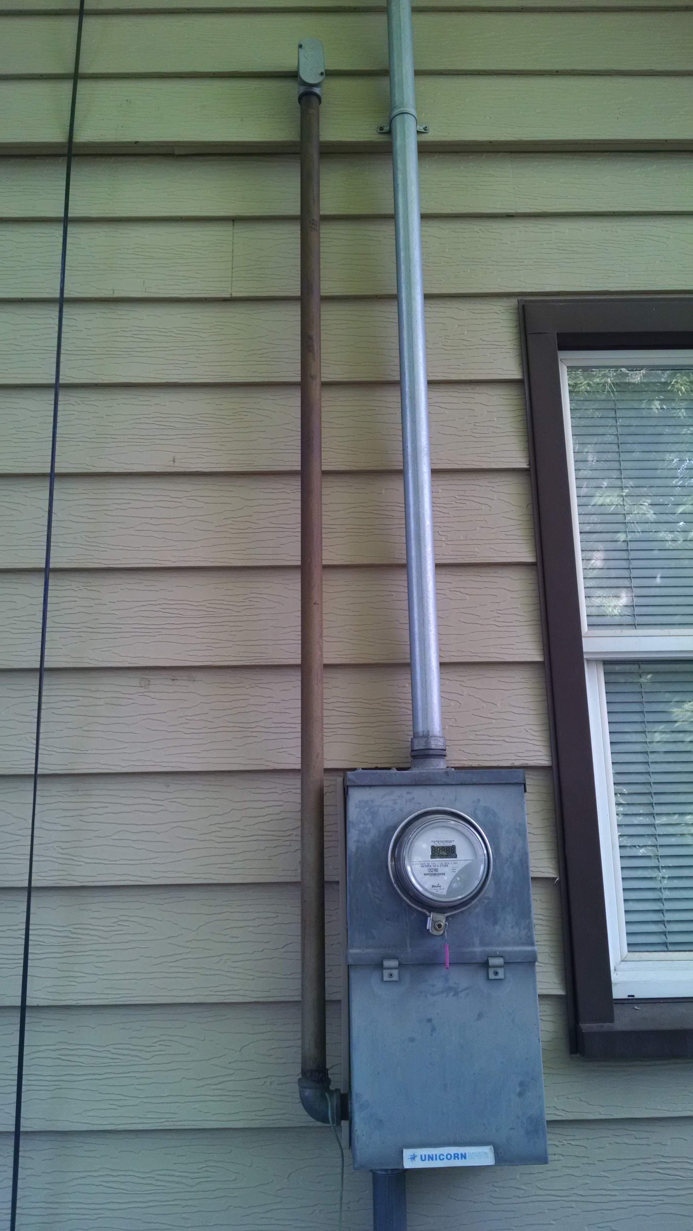

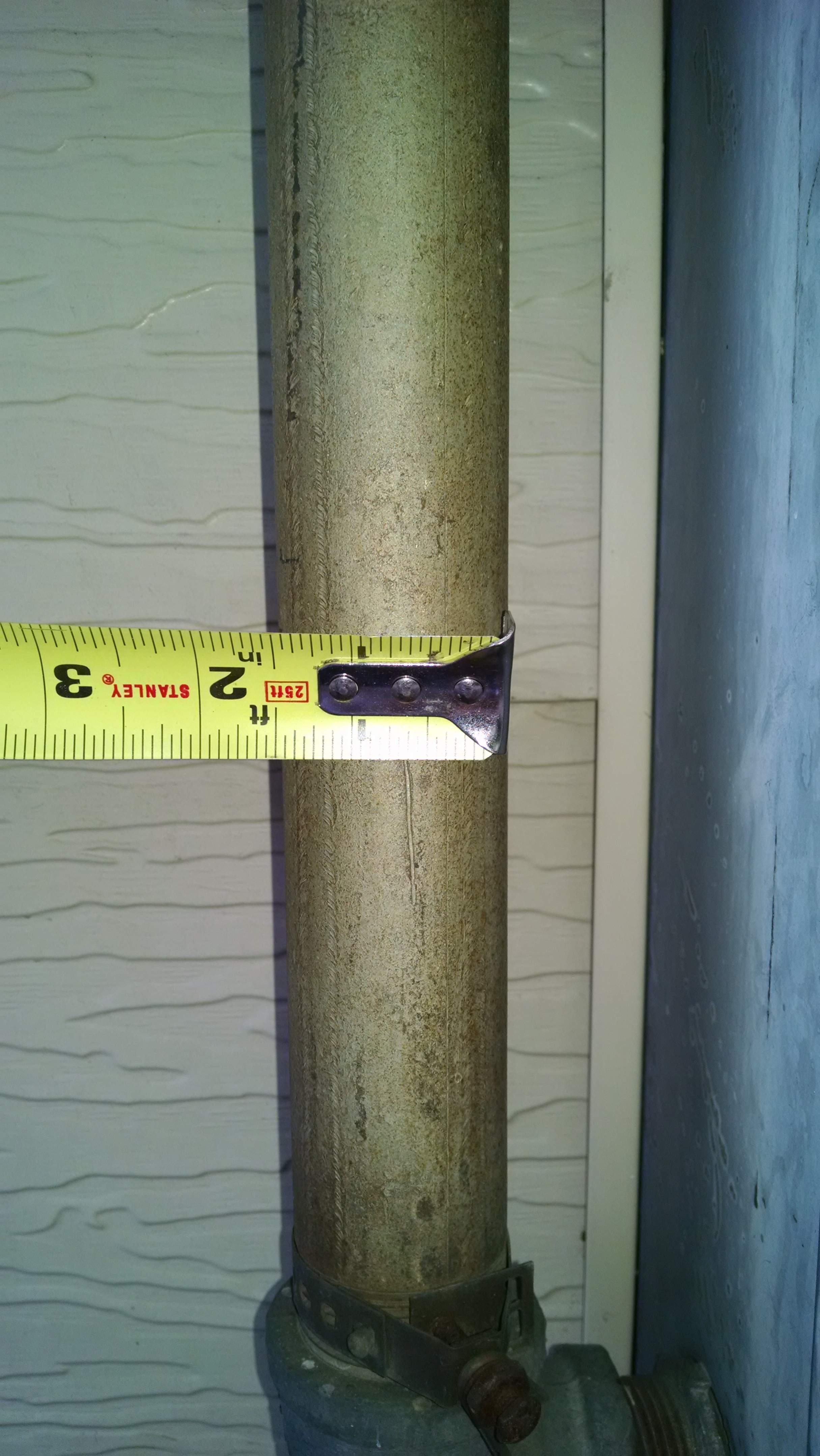

ok, this is the last ill say.....good luck.
I do get tired of fixing homeowners messups. heres one i had to do today. Its especially nice to see someone run GAS pipe and gas pipe fittings into a electrical panel...then run romex in the same pipe. The state inspector failed the job....cant wonder why.
The homeowner said he had some gas pipe handy...so whats the big deal.
I had to replace the entire panel cause its an old zinsco panel whit the upside down main breaker.....down is on.

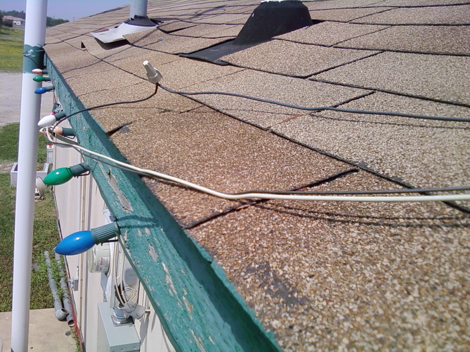

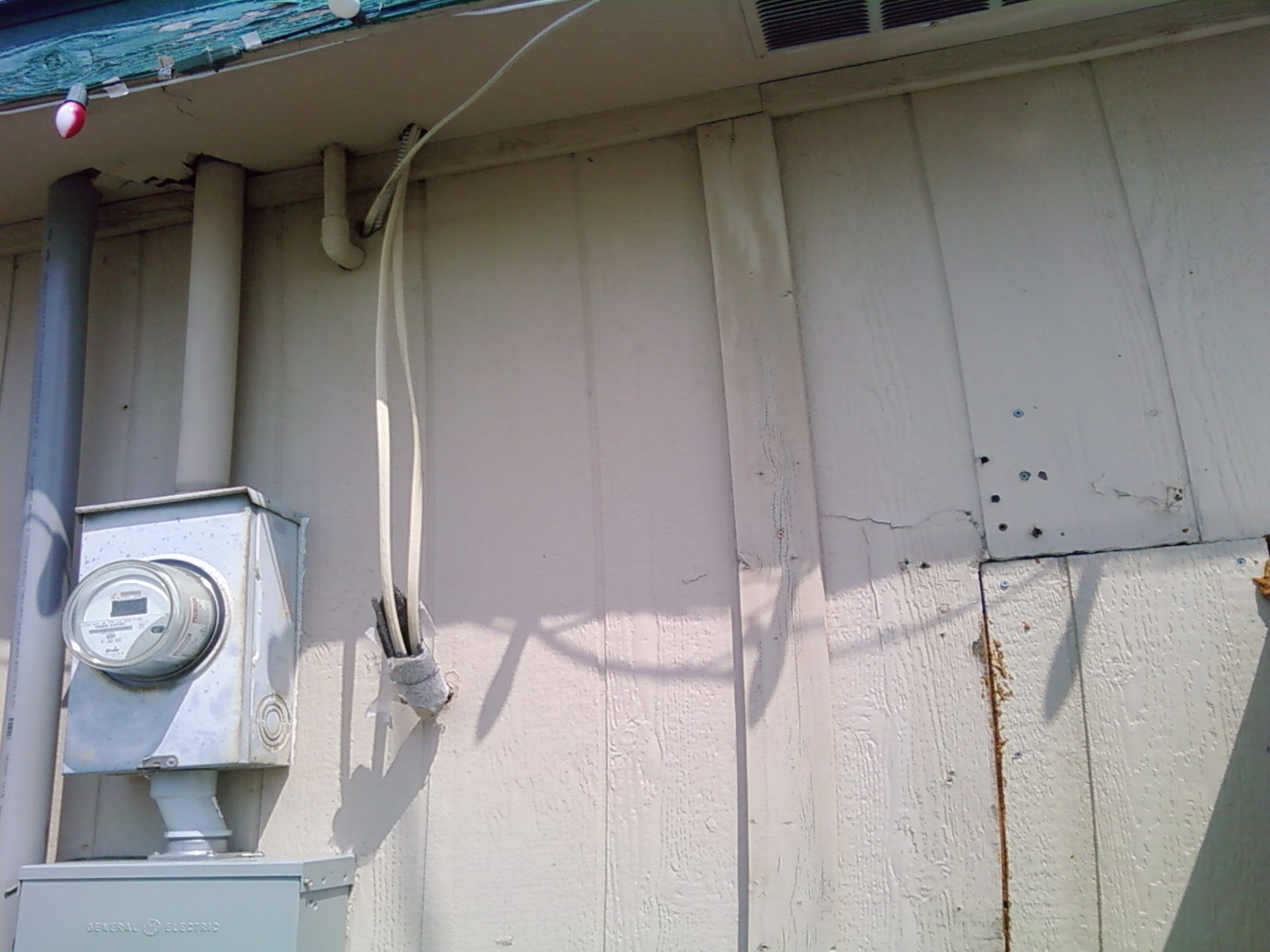

That looks hilarious! Here's one I had to fix a few months ago on a burger joint feeding a 20 amp hood exhaust vent:
And the fix, complete with required by OSHA safety cut-off switch:
