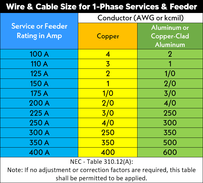

Copper may weigh more, but that difference becomes less when you need twice or more aluminum to provide the same amount of power.
The math in the prior post was for equal amperage, so apples to apples. I think that the larger diameter of the aluminum is a little misleading due to the lower density, which means a larger diameter to get enough material to conduct the same current with the same resistance.

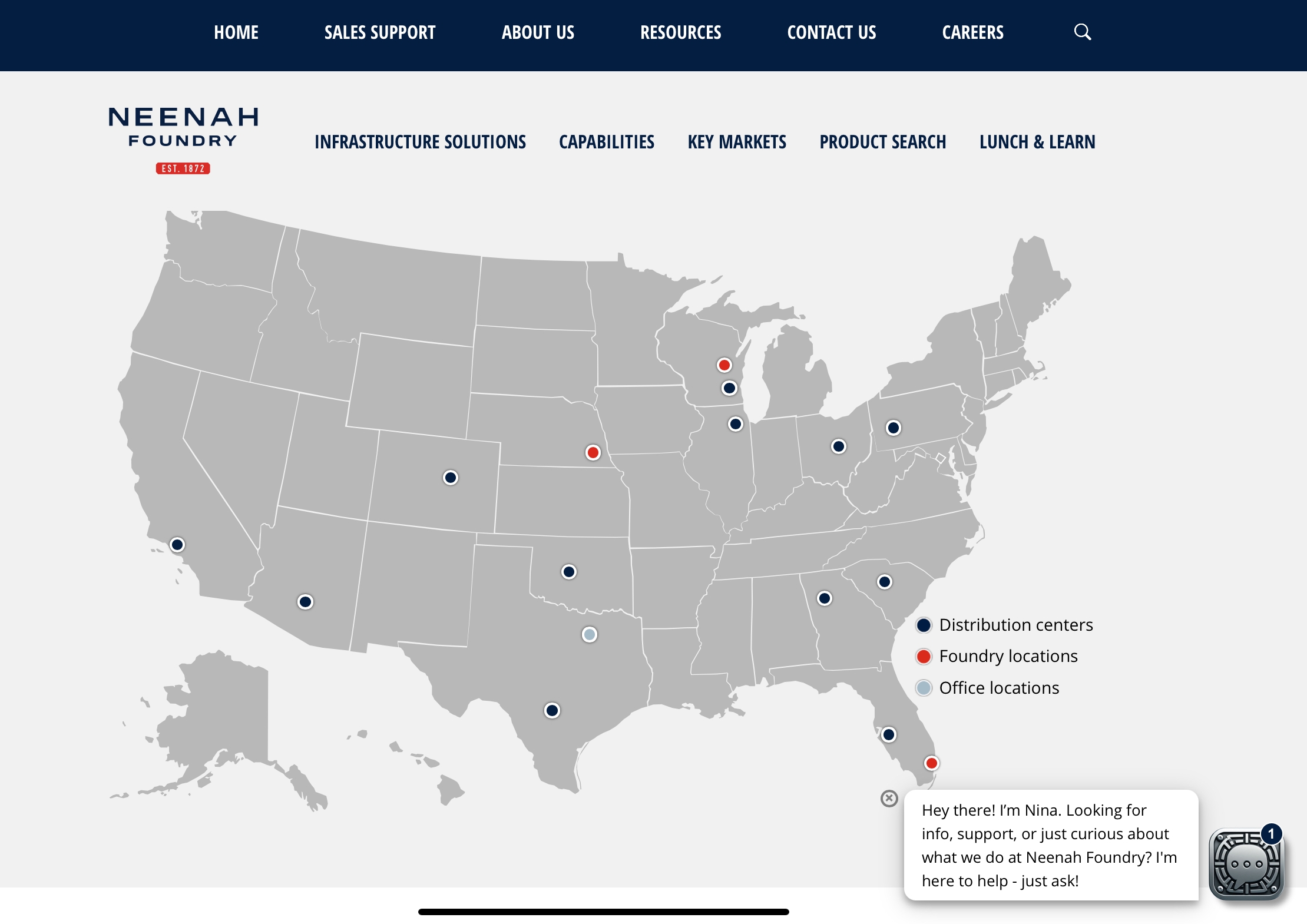

Yes, it was that foundry. I always enjoyed seeing their products around the area, rather like seeing the Neenah foundry products.
All the best,
Peter

There's been a superconducting feeder in operation at Fermi labs for forty five years or so, but I think that the trick isn't the lines, it is finding a superconducting material that doesn't need to be at -452F.
All the best,
Peter
Agreed, as aluminum conductors weigh approximately 3 times less for the same conductor size vs copper.
For aluminum needing to be sized larger to have the same ampacity as a copper conductor the weight of the Al conductor is still around half the weight of Cu.
Half the weight factors into installation being easier to install and lower transportation cost.
