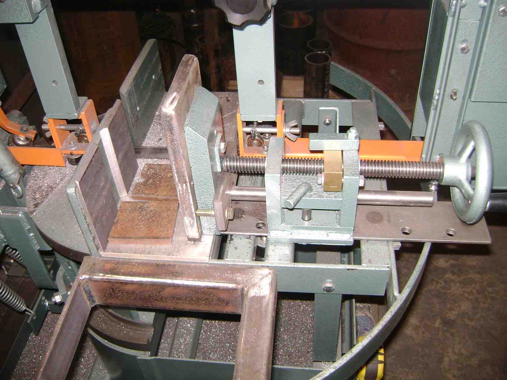

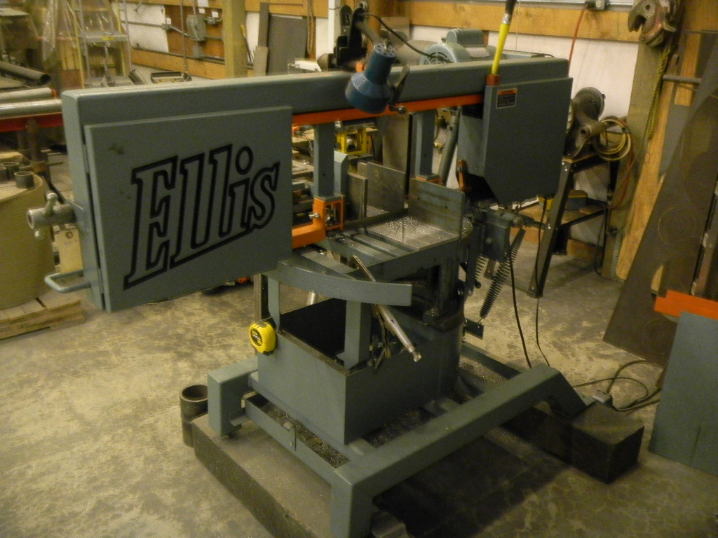

I have an Ellis 1800. Great saw! Did your saw come with the cam vice? If so you might want to order the screw vice.
/ Eliminated one more excuse.
The cam lock seems to work well. What are the advantages to the screw vice? I thought about the 1800 because the price difference is rather small, but I needed the saw to be portable to move it out of the way. I don't have room for a stationary piece at this time.
